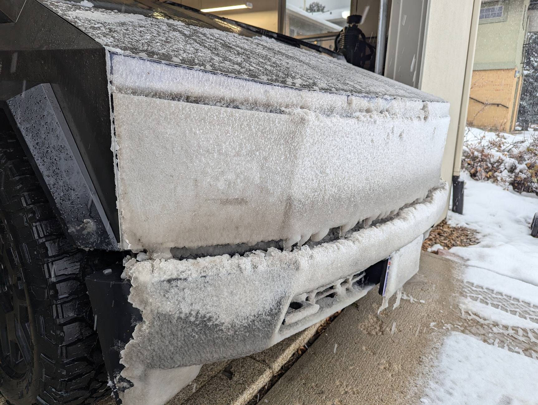

Tesla Cybertruck Frozen snow / ice blocked my headlights last night PXL_20241108_224743948
This was the result of us driving for an hour on I70 on Friday in light snowfall.
We had fun clearing the bumper camera using the squirter from the camera display, which worked, except when I left it for a while and it iced over. The main camera up high was fine.
The windshield itself was perfectly clear once I figured out the method:
* keep wiper heater on (I had to turn it on every 10 minutes or so because it automatically turns off)
* Every 10 minutes turn on the front windshield defrost in high (red) mode by clicking on it twice, but just for a minute each time, to keep the windshield warm.
By doing this the visibility in the snow was better than in our 3 or Y.

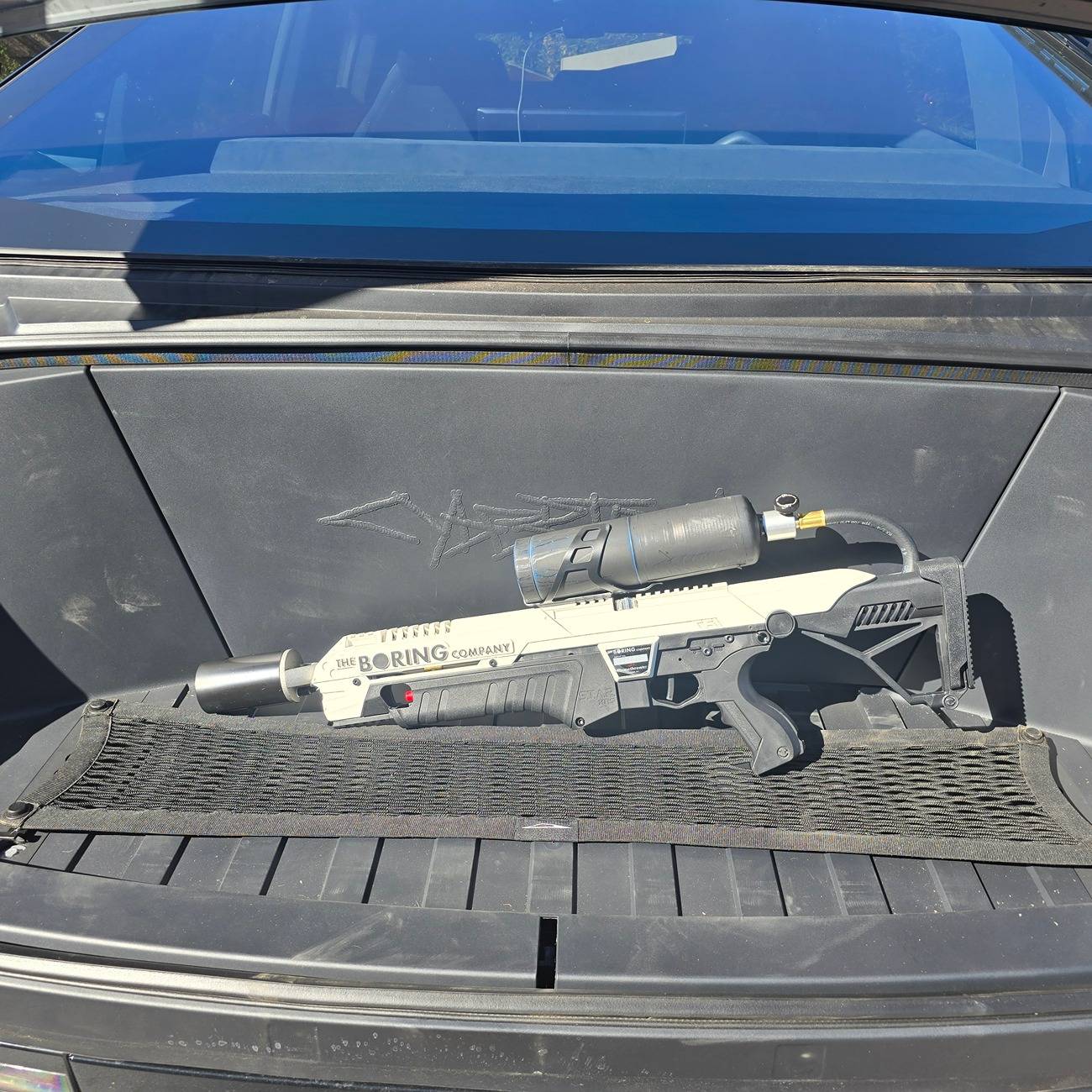

Yeah, the entire front of CT was covered up with snow & slush. Didn't know until I got off the interstate when I realized I couldn't see the road.
Cybertruck's entire front-end was *packed* with frozen slush from the interstate. I couldn't remove it with my bare hands when I pulled over on a back road.
Next time I'll have to be better prepared....
"Next time I'll have to be better prepared...."
Someone else suggested using a hydrophobic coating like Rain-X or TopCoat F 11 applied to the headlights.
I don't think a hydrophobic coating is going to help much when there is a entire bumper shelf opening in front of the headlight (headlight NOT light bar) for the ice and snow to build up on.
As a former downhill & cross country skier I have driven in many blizzards.
The headlight being recessed is the problem.
Having to use battery capacity (electricity) to melt snow/ice off headlights seems less than optimal when range is already reduced by cold weather. The physical design should have been to reduce chance of this happening.
