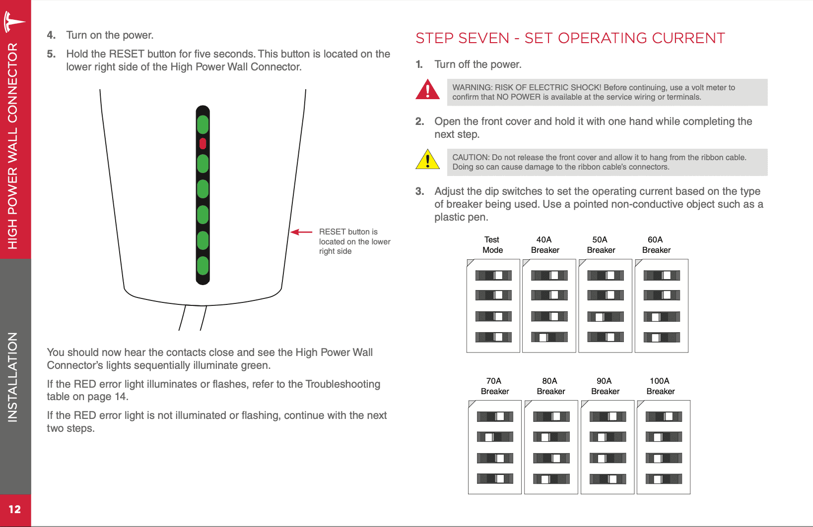

Doubtful, my Cybertruck charges at 32A with the mobile connector, and Superchargers much faster than that.
Does the screen say 24/24 or 24/48 when charging?
24/24
May 27, 2024
4,522
5,501
Interesting, either the wall connector is advertising 24 Amps max or the Cybertruck is interpreting what it is advertising as 24A. Given there is no 30A breaker option on the wall connector, it may be the latter.
Could try 60Amp breaker setting, that should give a 48Amp charge rate

Hmmm.....I'll give that a shot. If it doesn't have any impact, no harm no foul.

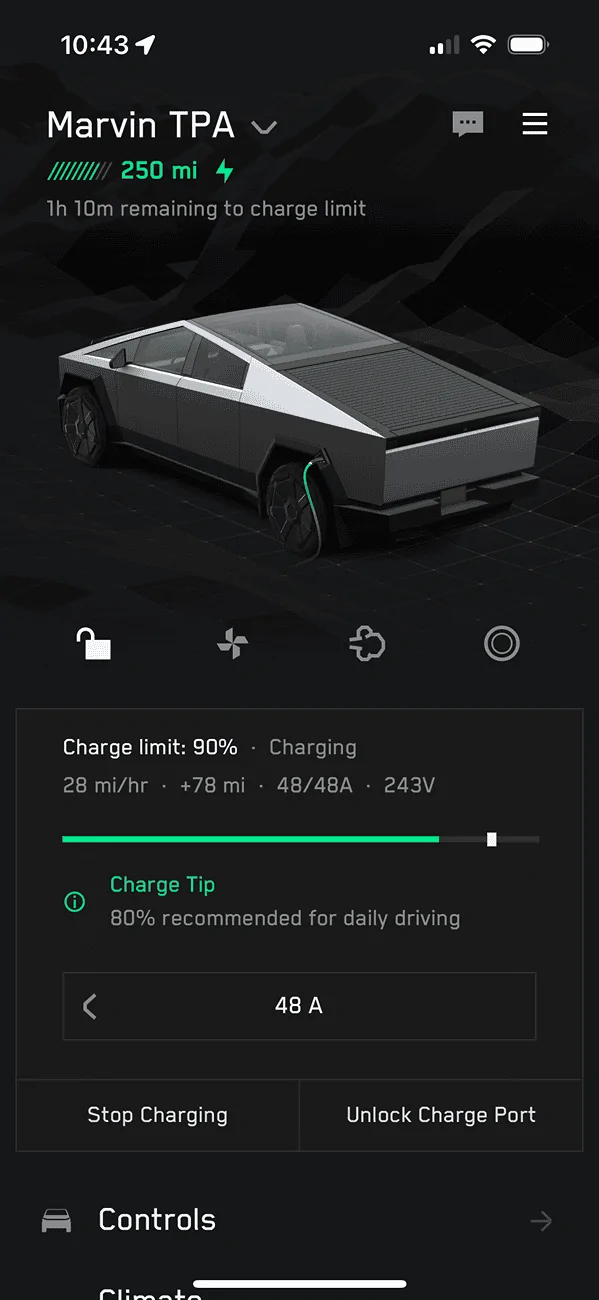

So, I finally got around to figuring out the optimal setting on the G1 HPWC for the truck: the 80A setting is getting me 48A of charging.

Interesting, thanks! I was curious how the UI would deal with a charge capacity higher than the vehicle can handle. Makes sense to only show usable capacity.
I'm super pumped that I effectively doubled my charge rate by flipping a few dip switches. Settings matter! ;)
