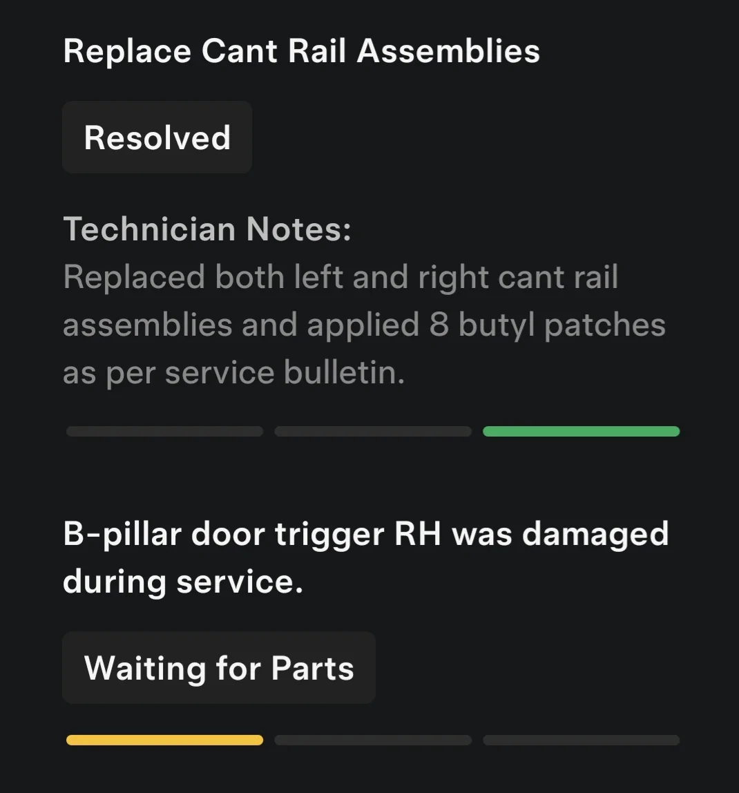

Service visit today for adjustments and possibly parts replacement for steering telescope function ( in or out positions).
Cantrail replacement was added to the work order.
Service update says work complete, BUT, we broke something else during service! (Attached)

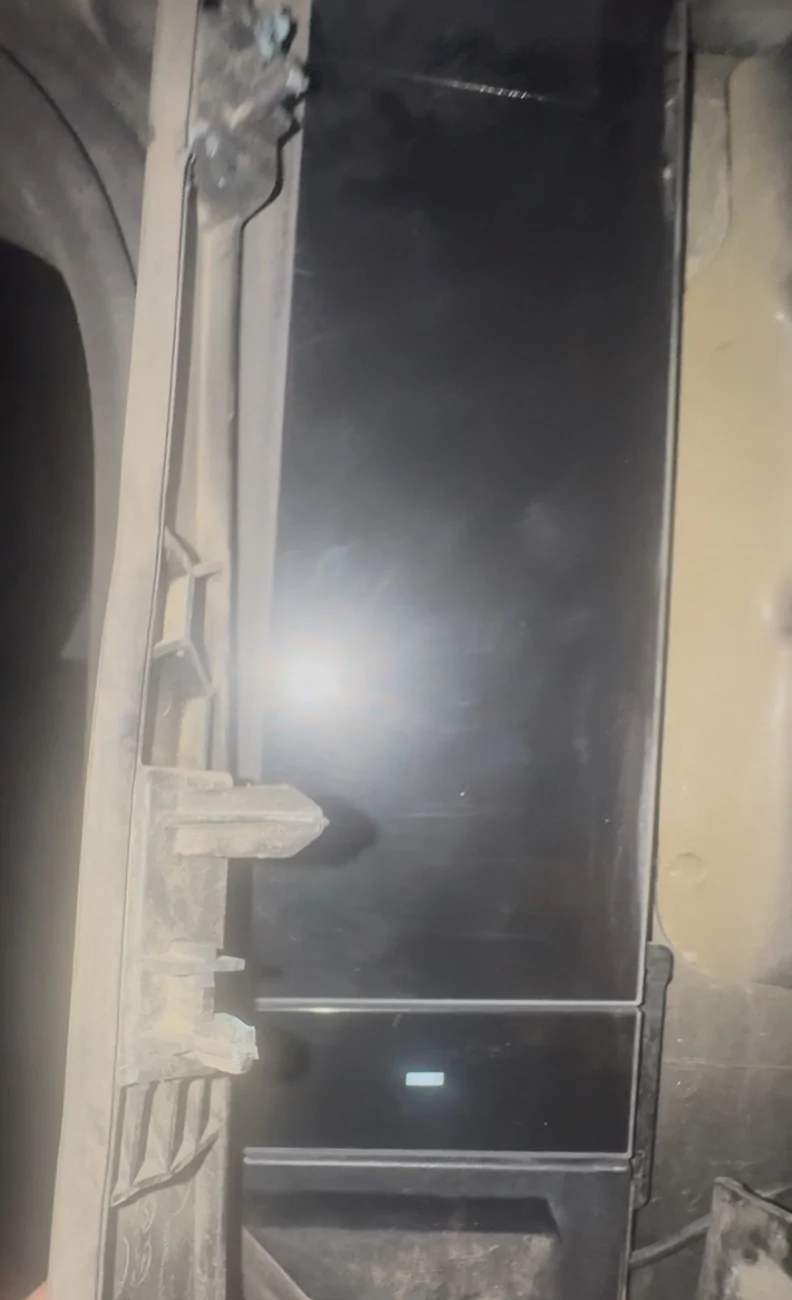

I just got mine back from cantrail replacement and they broke something and didn’t bother replacing it. I messaged service team when I got home and saw it. What is this part even called? It’s some kind of trim they broke the clips on then just snugged it into place with the door closed.
Assuming that is the rear driver's side door button:
SAIL BAFFLE CLOSEOUT - LEFT HAND
1848587-00-D
$10
Part #22
EPC page
That piece is removed in step 9 of the Cantrail procedure
