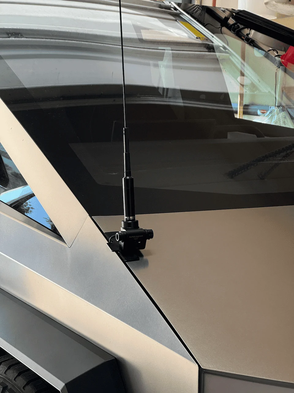

I ended up with using a trunk lid mount, Diamond K400SNMO mounted to the frunk passenger side.
I normally run a Diamond NR770HNMO UHF/VHF antenna,
or a Yaesu ATAS 120A, HF/VHF/UHF.
I use the ATAS only when stationary, I have not tried it while driving as I think it may be a bit heavy for the mount.

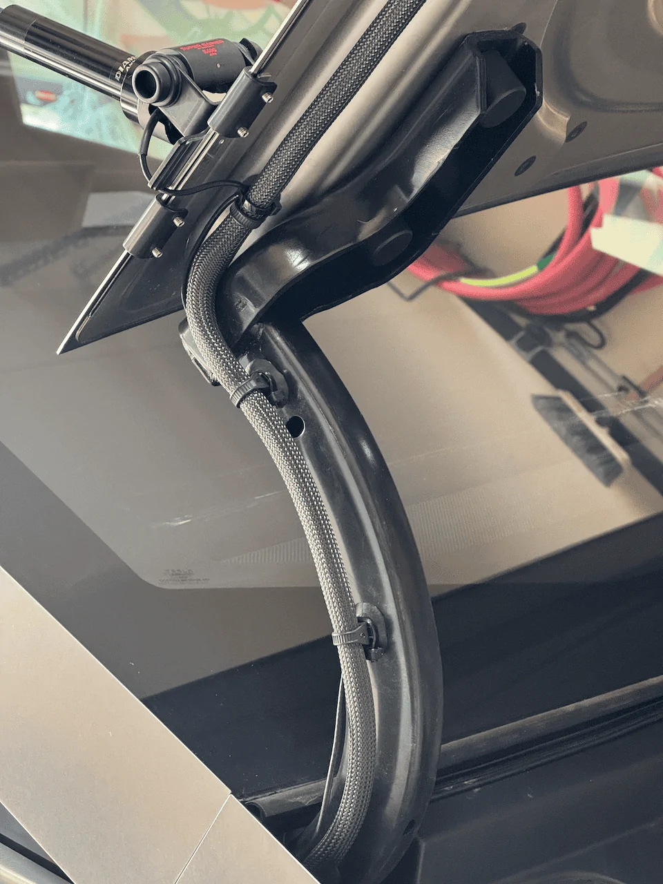

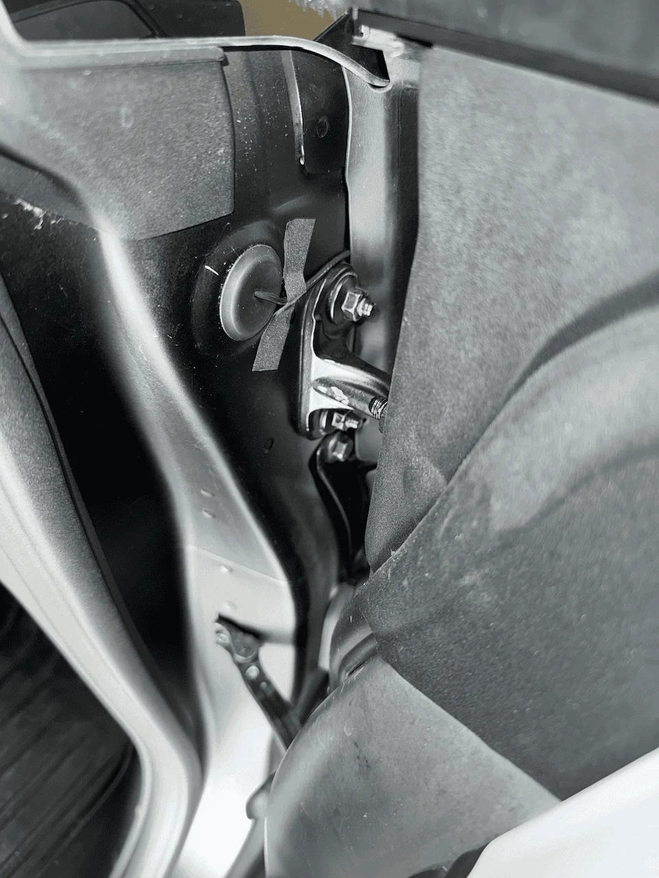

The coax was fished through the fender, in through the blanking grommet inside the door jamb, and through a second hole (obvious once you pop the side panel) to the backside of the passenger trim panel and down across the floor and tucked into the center console side.

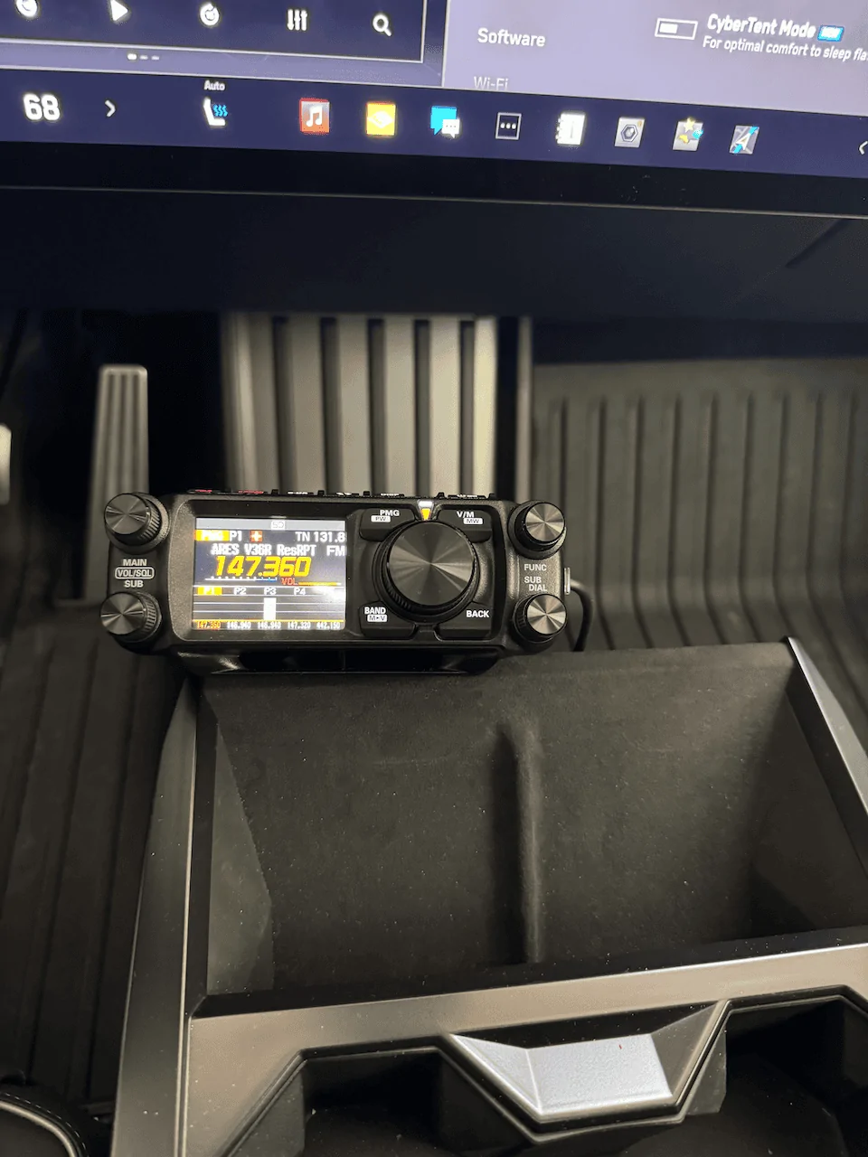

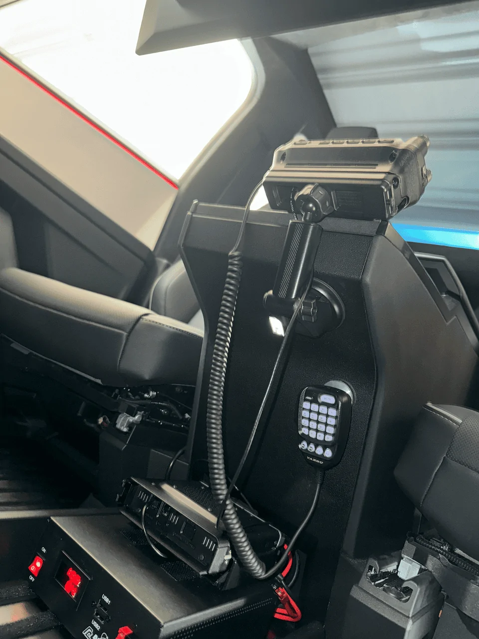

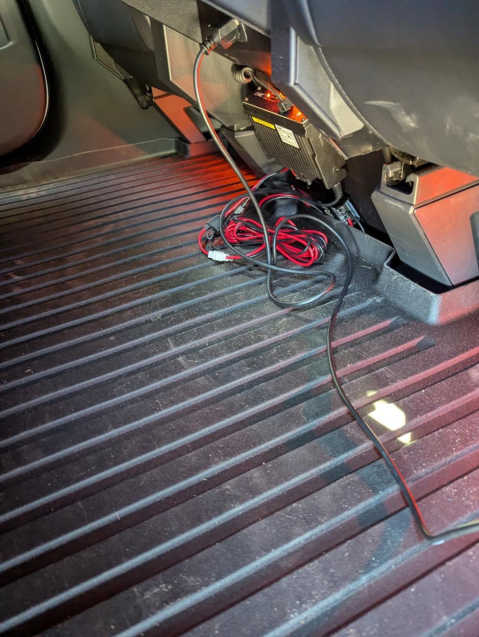

I put velcro on the black ridges in the center console and mounter a power supply and radio to it using velcro.
The head is mounted using a Lido Dash/window mount:

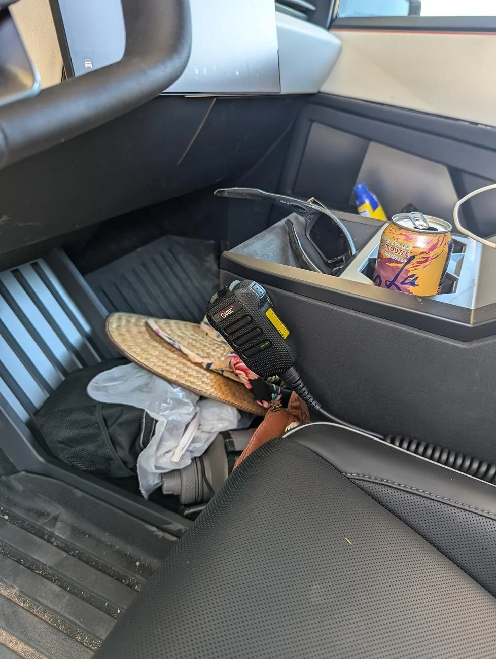

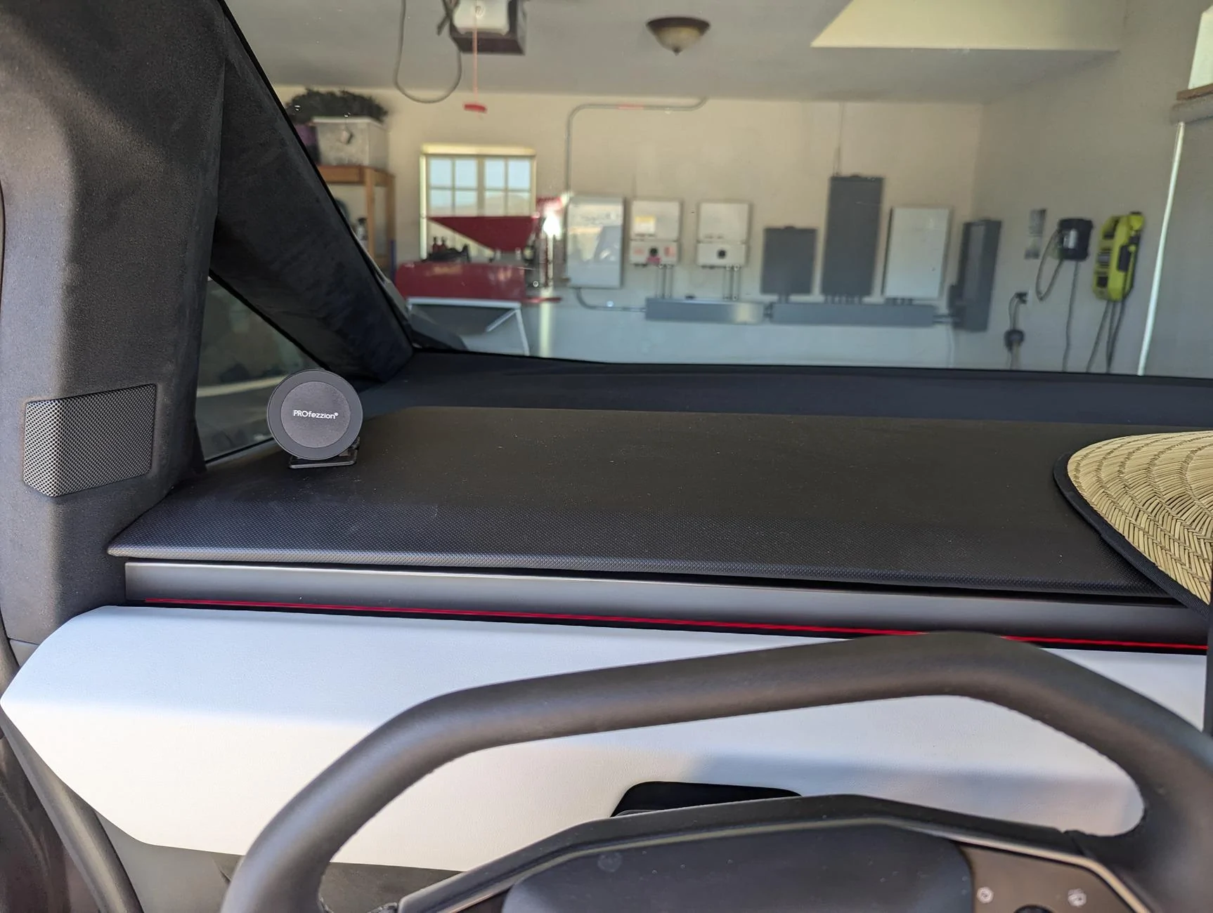

Sure! Forgive the mess, just got back from a fishing trip.
Just a reminder to everyone, measure your garage opening and total heights. Putting something on top of a vehicle that can be over 6 ft tall can, well, be heart breaking when you pull into a garage or drive-thru.
This is always good advice... Edit: I meant to also add that this antenna is very easy to just unscrew from the base. It also can lay flat but requires a Phillips head and getting up there, so I just unscrew it for carwashes and the garage.
Phone I'm taking pictures with mounts here on the mag mount and acts as the screen/controller.
Tesla Cybertruck HAM radio antenna mount options PXL_20240628_154452250

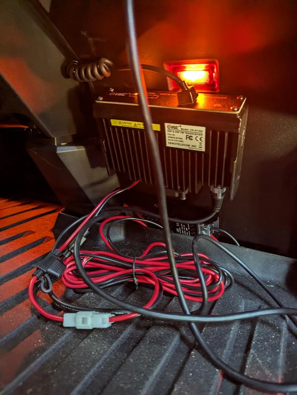

Transceiver and power supply unit attached with command strips and powered. Need to finish cable management, won't be leaving it like that.
Tesla Cybertruck HAM radio antenna mount options PXL_20240628_154345023
Tesla Cybertruck HAM radio antenna mount options PXL_20240628_154351857.MP
This radio has a Bluetooth HT that I'm planning on buying, but you don't actually need one as you can use your phone or a dedicated android device for everything if you wish. I'm just old school and like a HT

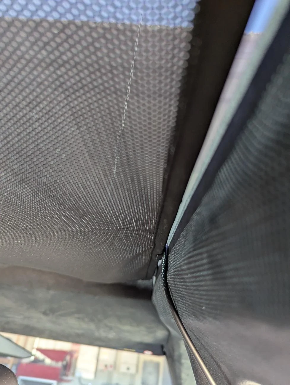

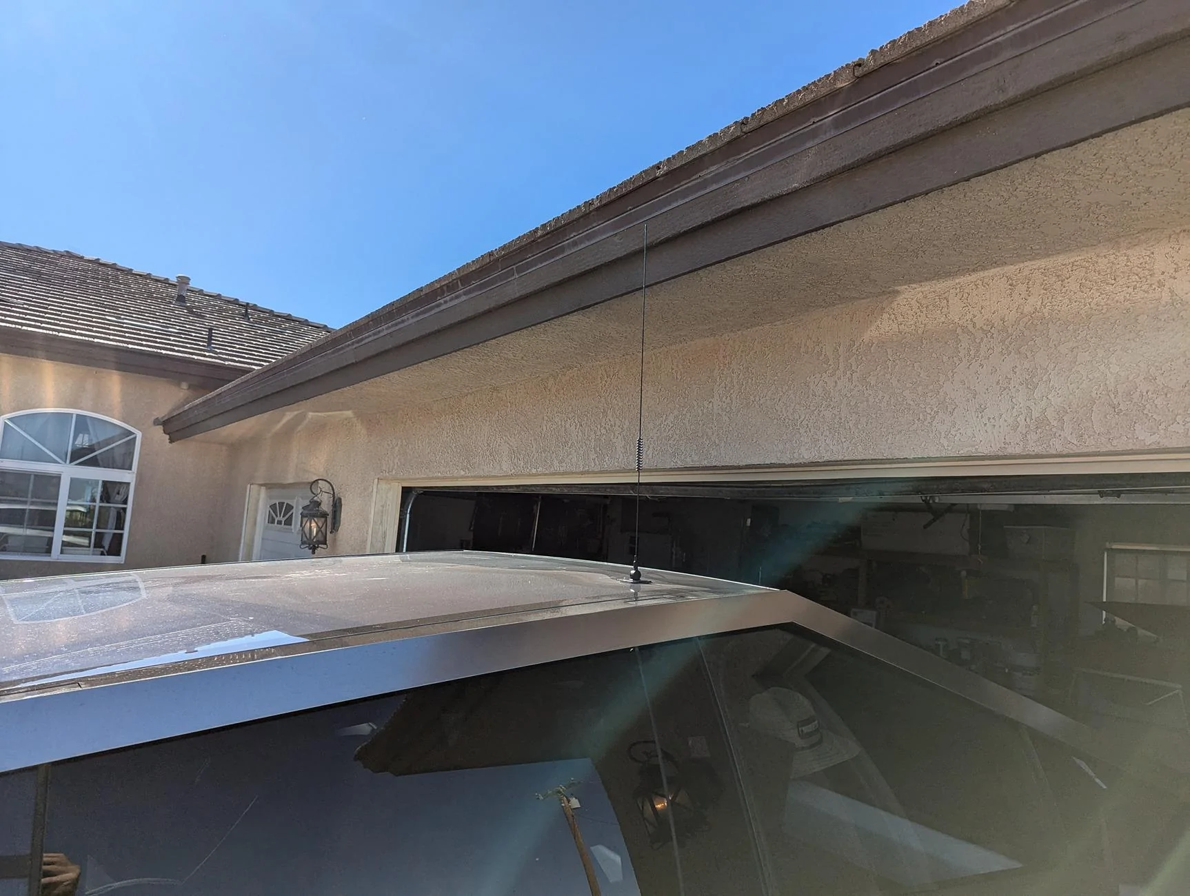

Antenna on top and cable run through glass.
Tesla Cybertruck HAM radio antenna mount options PXL_20240628_154230420
Tesla Cybertruck HAM radio antenna mount options PXL_20240628_154327016
I have the shade on for the kiddo in the back, but its just a powerful stick on antenna that I was very dubious about at first, but I'm very happy with it. At 144MHz I'm getting 1.4:1 VSWR 50W and at 435MHz I'm at 1:1 40W. The tint on the ceiling doesn't seem to bother it, but you have to be careful when mounting it because it DOESN'T COME OFF EASILY once you place it and there's a thin wire that runs through the corners that is visible and you need to avoid it.

Let me translate removing the antenna in real terms, terms that many hams have learned.
Bang, bang flap, ping, bang, ding.
CRAP, I forgot to unscrew the antenna!
Also associated is the
"Why is no one responding to me"
CRAP, I forgot to put the antenna back on!
There are thousands of years of experience backing those statements up.
I'm not saying it won't happen to you. (okay, well, never mind, it will :( )
While tilting it back isn't going to help the pattern, if you can tip it back enough to clear the garage door, you may be much happier.
That's the main reason why mine is mounted on the lowest part of the glass. And I've got two antennas, one that is too high, but okay for pilgrimages to Hamfests, the other for daily use.

Definitely! To each their own! Since I've run with a tall antenna pretty much all the time for the past 20 years, I've gotten pretty good about knowing when to stop and haven't smashed an antenna in a very very long time. But I guarantee it'll happen eventually ? I'm just confident through years of practice.
This tram antenna does have a knock over feature if you orient it correctly also, which I hope to never test, and only costs $35. It allegedly tilts over BEFORE damaging the antenna while miraculously not tilting in the wind, though it bends pretty good at 60+! ?‍♂ we'll see when I eventually screw up!

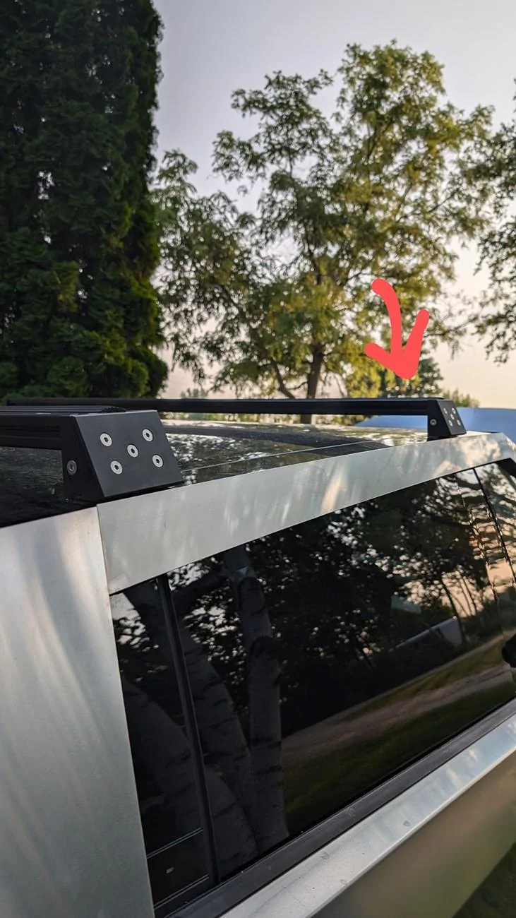

Has anyone on here found a good way to run the antenna up through the center pillar and out through the roof opening where the 48v connection point is? I am hoping to mount it on my roof rack.
I've ran a few searches on this forum and can't find anything.
Yes! I can't find it at the moment, but you can use the same directions as the Tesla light bar wiring to run a coax. It requires removing the B pillar facea, but there's plenty of room in the B pillar and under the roof edge trim you pointed out to accomplish what you're after! Will find that service manual entry for the light bar after I post this.
B pillar exterior trim removal: https://service.tesla.com/docs/Cybe...UID-DB61B43D-3A22-4C69-AA6A-F7DCC6BF217D.html
B pillar interior lower trim removal. This one is a pain as they overlap, but you may not need to completely remove everything just to feed a cable through:
https://service.tesla.com/docs/Cybe...UID-010D5F22-EB8D-43BA-9280-B21836120CCD.html
