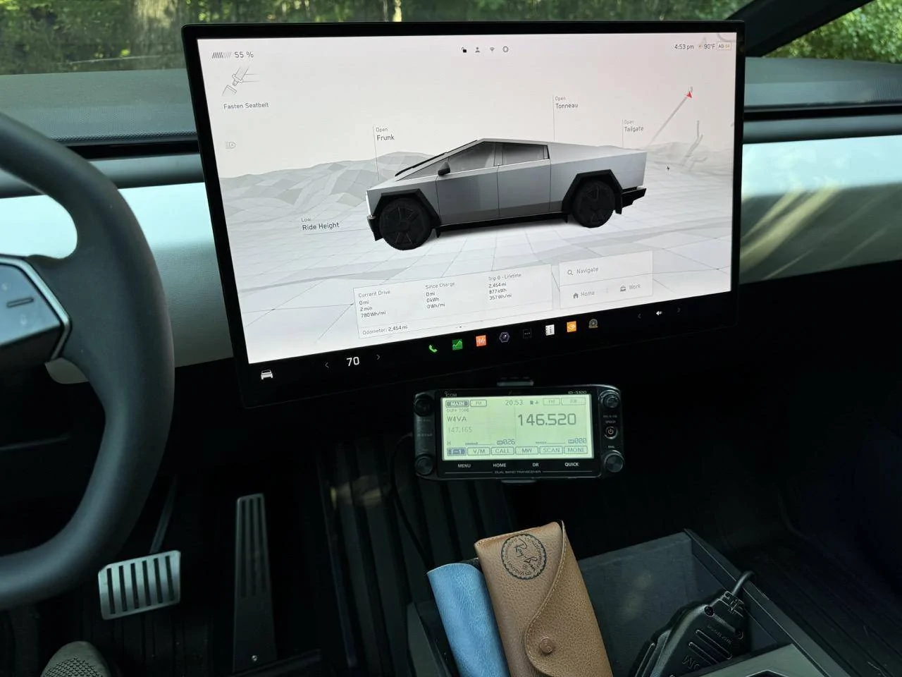

I'm running an Icom ID-5100 as my mobile VHF/UHF rig. Had it in my Model 3 for a couple years, running to a mag mount antenna on the trunk lid. After picking up the Cybertruck last year - and since that's now my primary vehicle - I moved the Icom to the truck. The ID-5100 runs to a Tram Browning through-glass antenna (https://www.amazon.com/dp/B01AIOHPUA?ref_=ppx_hzsearch_conn_dt_b_fed_asin_title_1), mounted above the passenger-side rear seat. The rig itself, along with a conventional 12v power supply (plugged into the rear cabin 120v outlet) sits on the floor in the rear, basically up under the front passenger seat. The head unit is mounted to the front of the large console structure up front, and is positioned just under the vehicle display.
I was originally dismissive of how well a through-glass antenna might work, but have found it to be roughly on par with the mag mount. And it certainly solves a bunch of coax routing challenges.
73, Jeff K4EI
