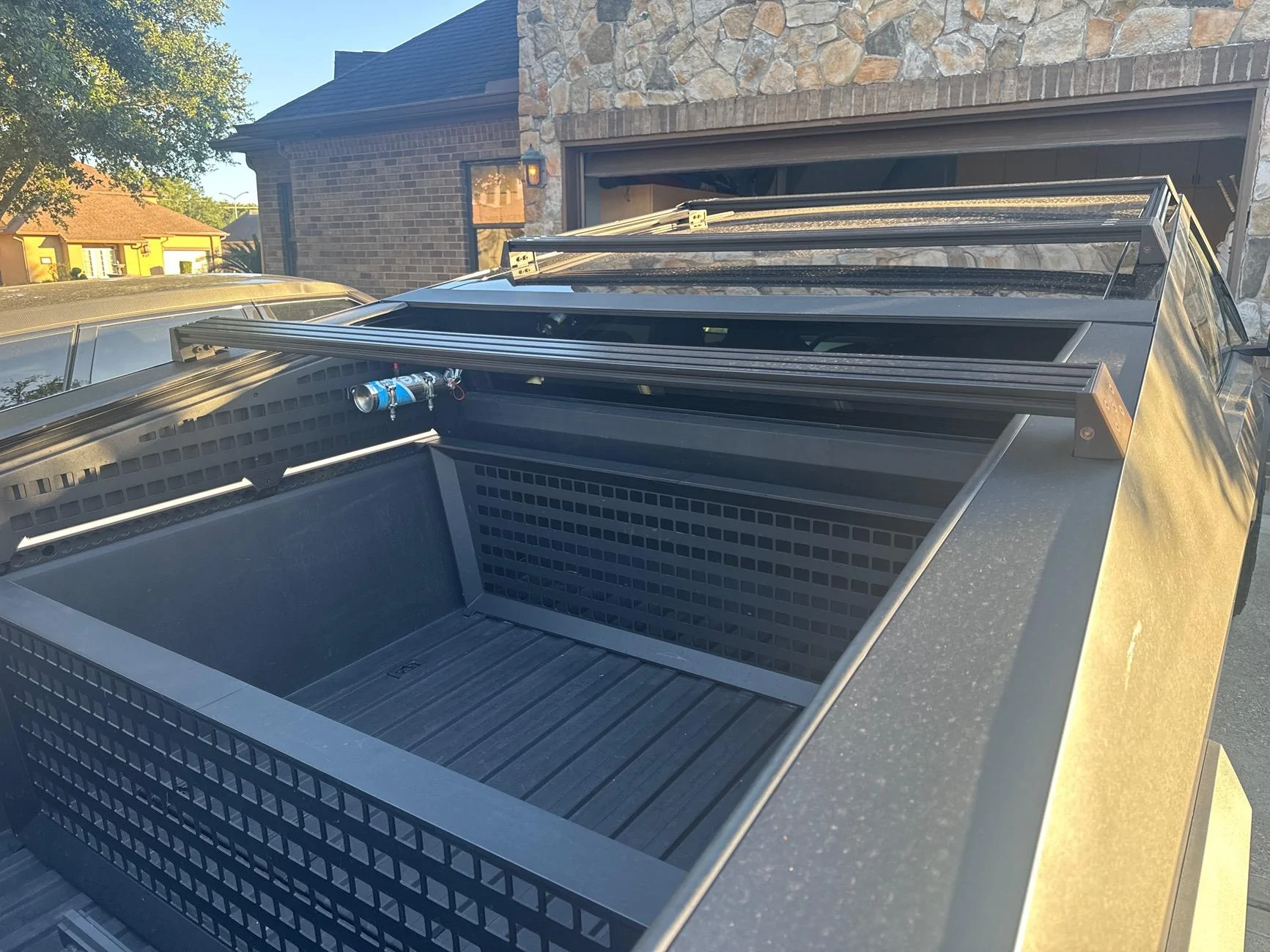

Are these Mars crossbars?
Has anyone on here found a good way to run the antenna up through the center pillar and out through the roof opening where the 48v connection point is? I am hoping to mount it on my roof rack.

Pulaski, did you finally get your attn mounted? I am supposed to receive my MARS accessory bracket mount today (replaces the aluminum cover plate on one cross bar), and wondering if you got the wiring run down through pillar.
Unrelated note, I have been searching for new cover plate SS screws to replace the carbon ones that came with it. I found the hex socket M8-1.25x12mm ones that hold the bars on, but not the M6-1.00x5mm flat ones for the cover plates. The slight rust on the carbon ones driving me nuts lol. Q, are you seeing the surface rust as well? Or just keeping dry/clean?

Excellent! Yeah, MARS has been good. My aluminum plate covers turning a little bronze-ish in this 100 Tx heat/sun, but in a way it looks cool. It’s just the rust on the screws that needs to addressed. Glad to hear they finally got some SS and coated ones as alternate.
for wind noise, I am going to take rubber seal / strip they provide for top of rail to protect whatever you put up there and move it to the front single slot facing forward. I think that front grove is where air is hitting at that angle for the slight wind noise. Still sounds better as is than wife’s Rover factory bars at speed…which makes me feel but better. Happy with the quality and multiple slots and thoughts they put in to make t nuts easy to slide in with no disassembly.
Everyone…Bad pic just now, but for others seeing thread, this is what Pulaski and I have and chatting about.

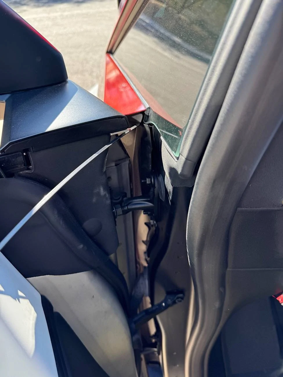

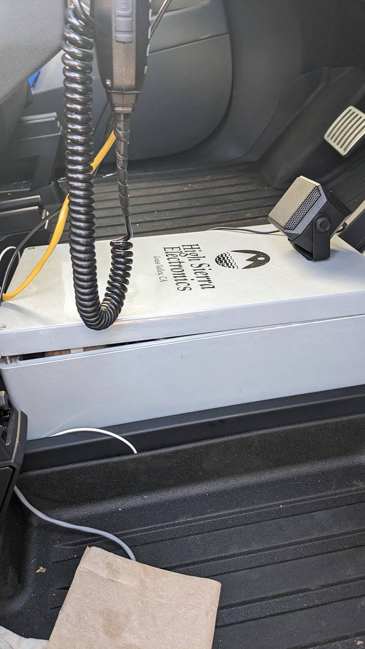

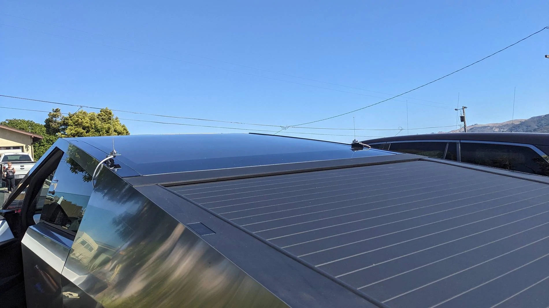

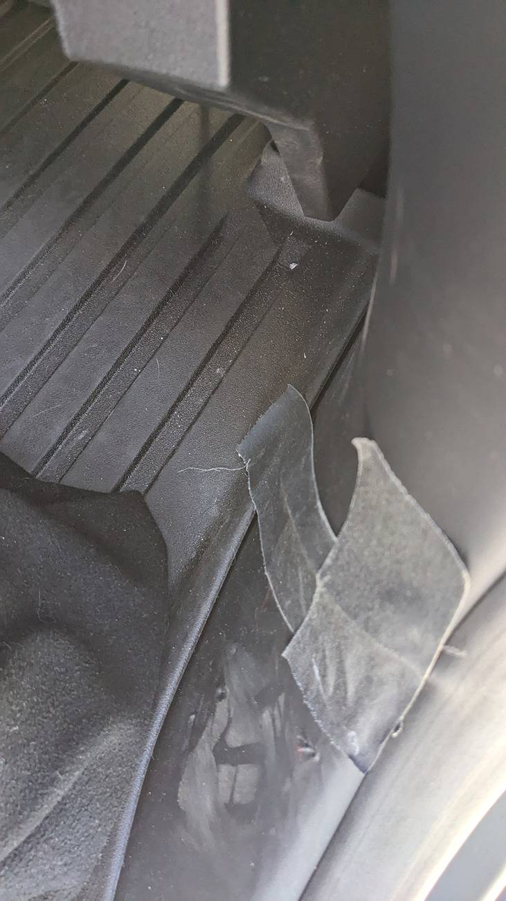

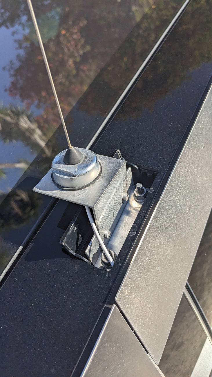

I haven't figured out how to get in the truck without going thru the doors.
Here are my NMO mounts
Changed the cable to RG188 (pics show RG58) and snake it thru a gap in trim, then in to back door,
tucked into weather seal, under floor mat to radios in a box in the center below console
APRS and Voice radios in box with LiFePO batt from Bioenno.
15V USB-C PD cord with series Si diode and voltage is in the acceptable charge range.

Yes, I mounted my antenna on the rear left and ran the cable under the roof panel tucked it behind the windshield rubber gasket. Pulled it from the frunk back to the driver side door where there is a small channel that goes in behind the dashboard.
