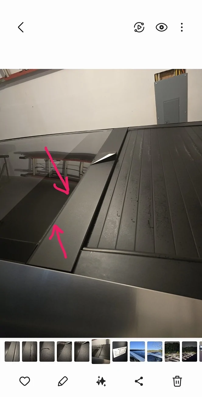

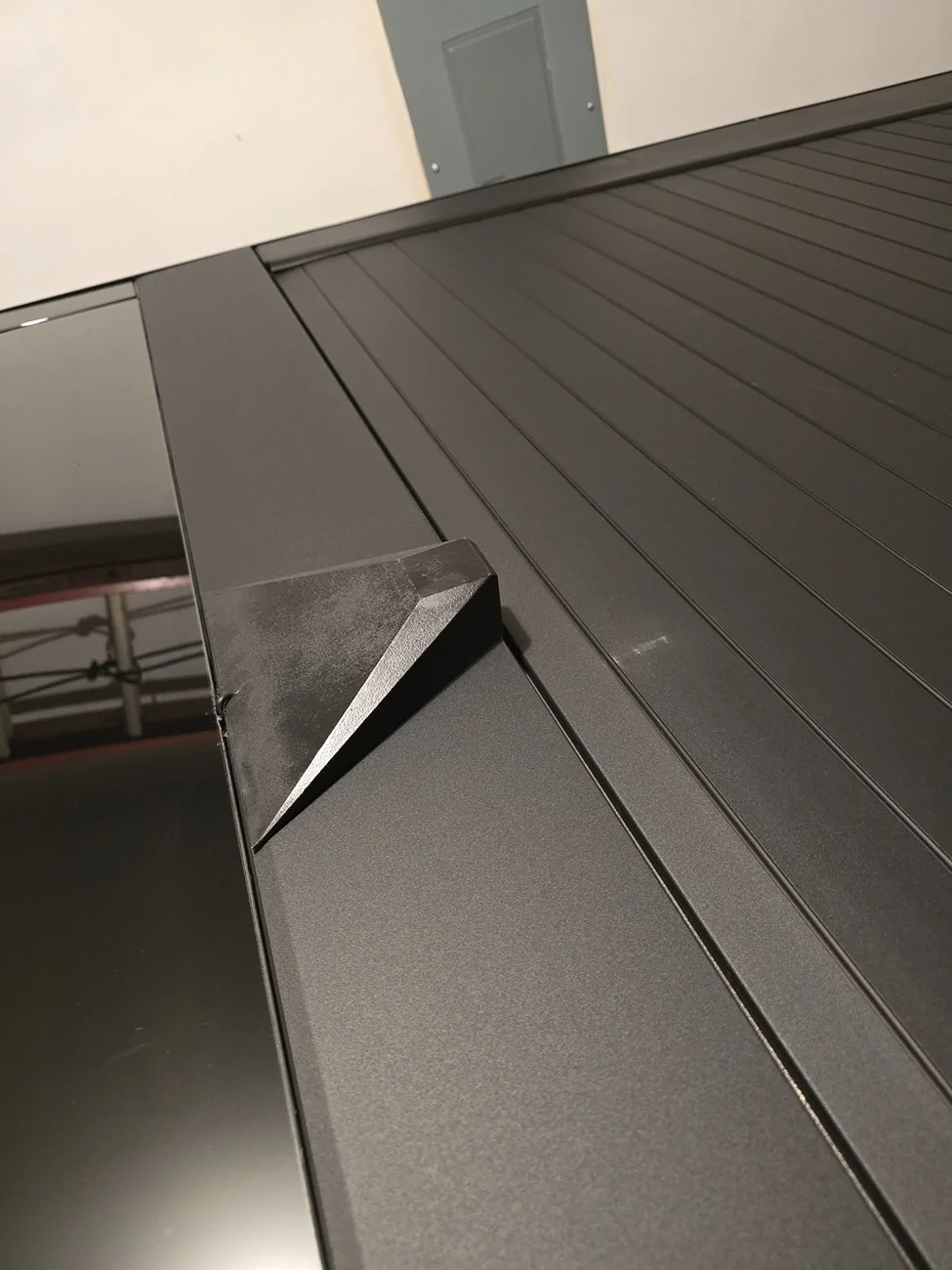

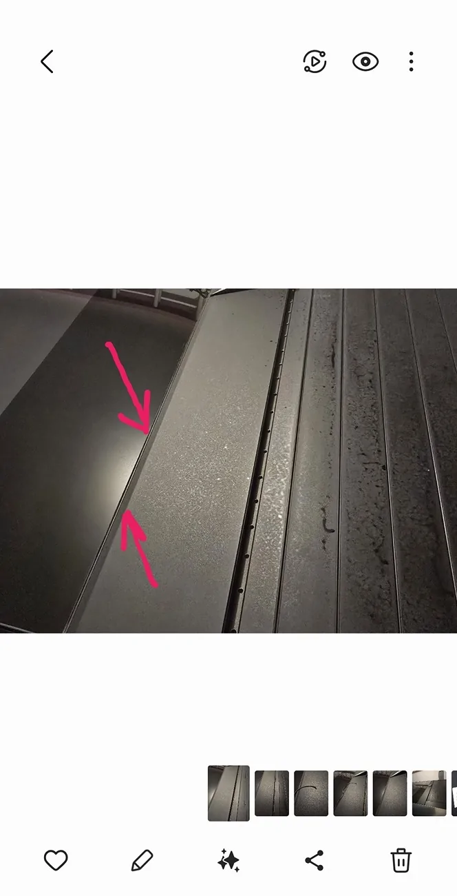

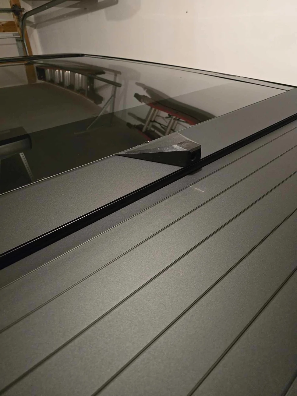

How did you folks weather proofed the place where the camera wire goes in between the moonroof and the metal panel? For me it keeps leaking water bit-by-bit even with some foam around the wire.
I have foam rod running the length of the space between the window and the metal panel. I added a clear spot of silicone at the place the wire goes through...
I had previously run a new rubber channel as shown in another video on how to seal that area. I found that there was one place where the line was coming across that channel and I had a new small leak so I took off the panel, re-adjusted the wire to not cross that extra rubber channel seal I put in and now it doesn't leak. I concur that adding this camera wiring can cause a leak to come back if you aren't careful. Some install videos I have seen I know from watching them that they must be leaking. :)

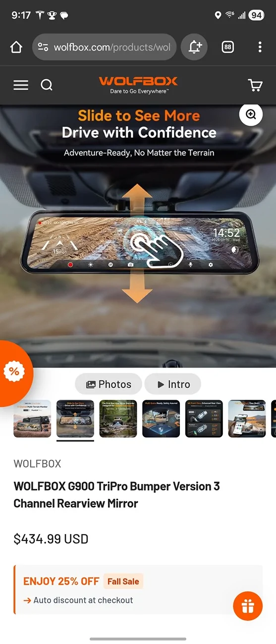

With this newer version on the mirror I honestly think you can use Wolfbox components... like when Wolfbox comes up with a newer mirror I think you can just swap it out and use the same mounting bracket from hansshow. Look at this image the connection look the same
