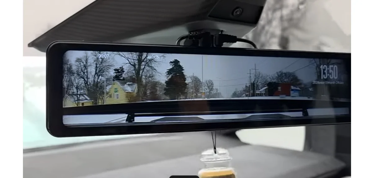

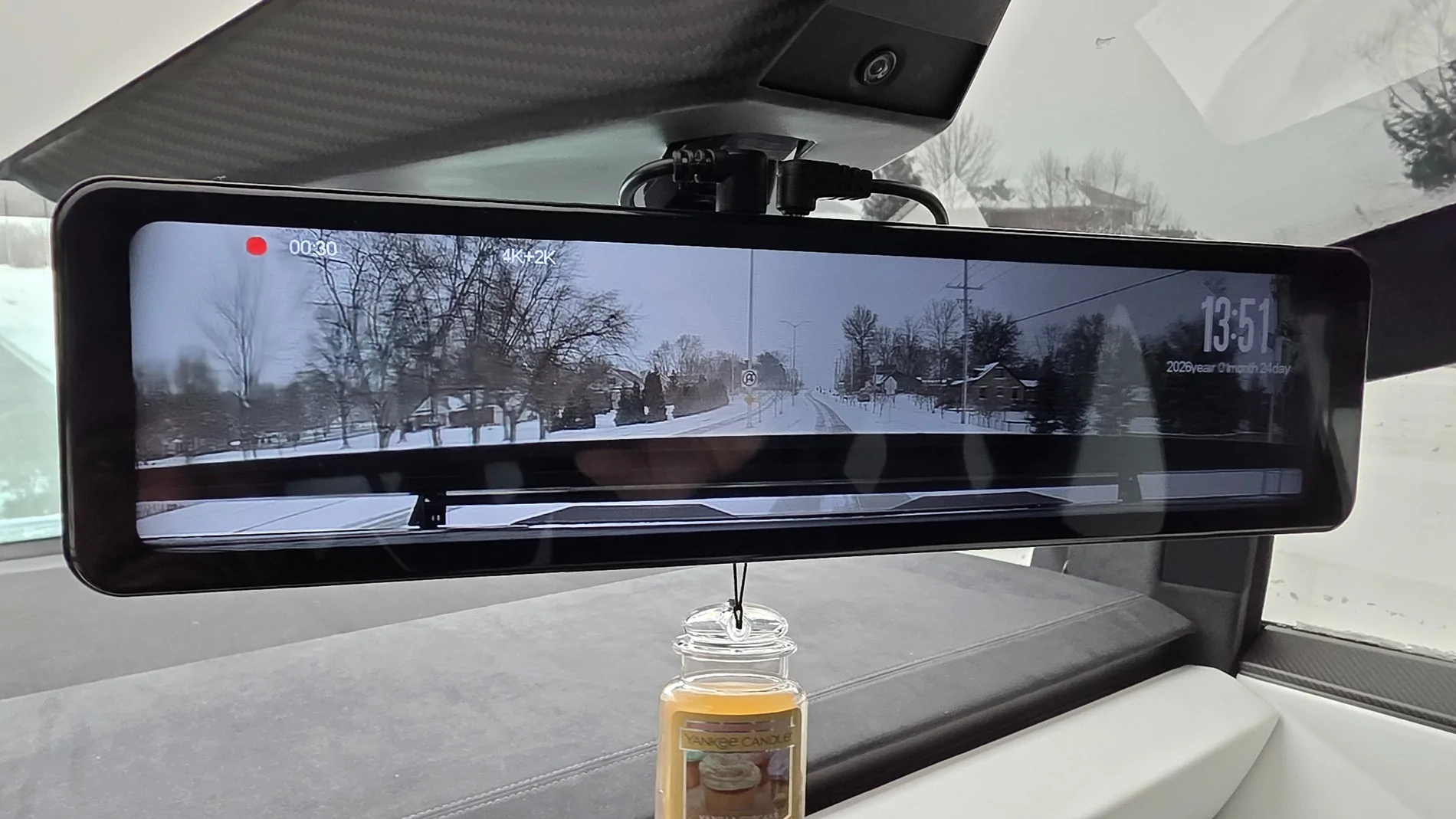

In case you were wondering what the rear-view mirror is like in the winter vs the standard tailgate camera, here is your video:
Tesla Cybertruck Hansshow V2 (2.5 / 3) Upgraded Media Rearview Mirror Install Article and Video 20260124_135505
Tesla Cybertruck Hansshow V2 (2.5 / 3) Upgraded Media Rearview Mirror Install Article and Video 20260124_135510

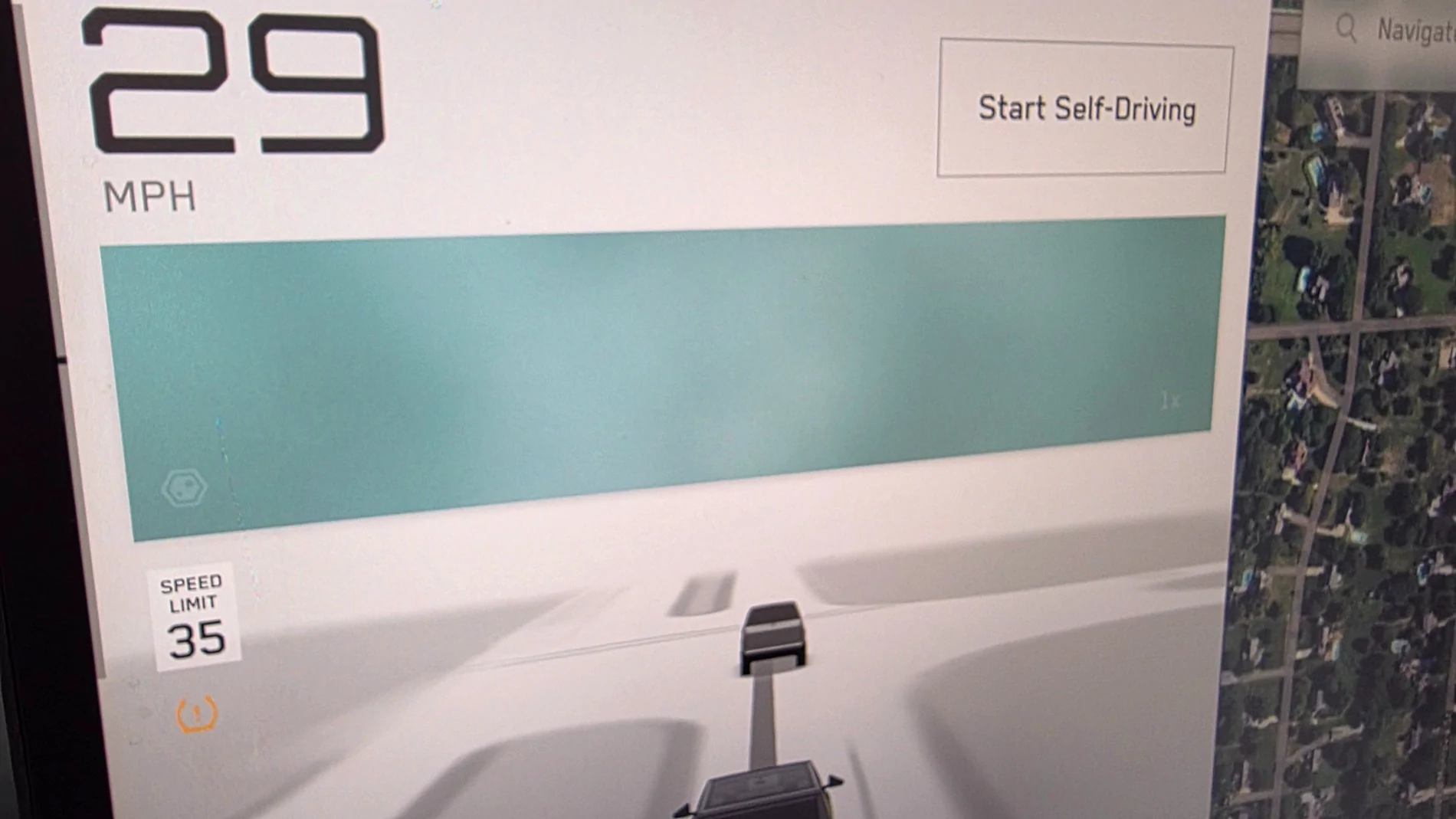

Tesla Cybertruck Hansshow V2 (2.5 / 3) Upgraded Media Rearview Mirror Install Article and Video IMG_4389
I don’t know if I’m stupid and can’t comprehend what I’m seeing, but is this directly aimed at a crossbar mounted over your bed? Seems like it just blocks the view of road behind just as bad as the snow covered cam lol.
I can adjust view up and down but it doesn't block much even when bars are installed or the weapon system, still better than a glazed over factory camera. 🤪 besides if I sm driving faster than everyone else i don't care whats behind me... 😂
