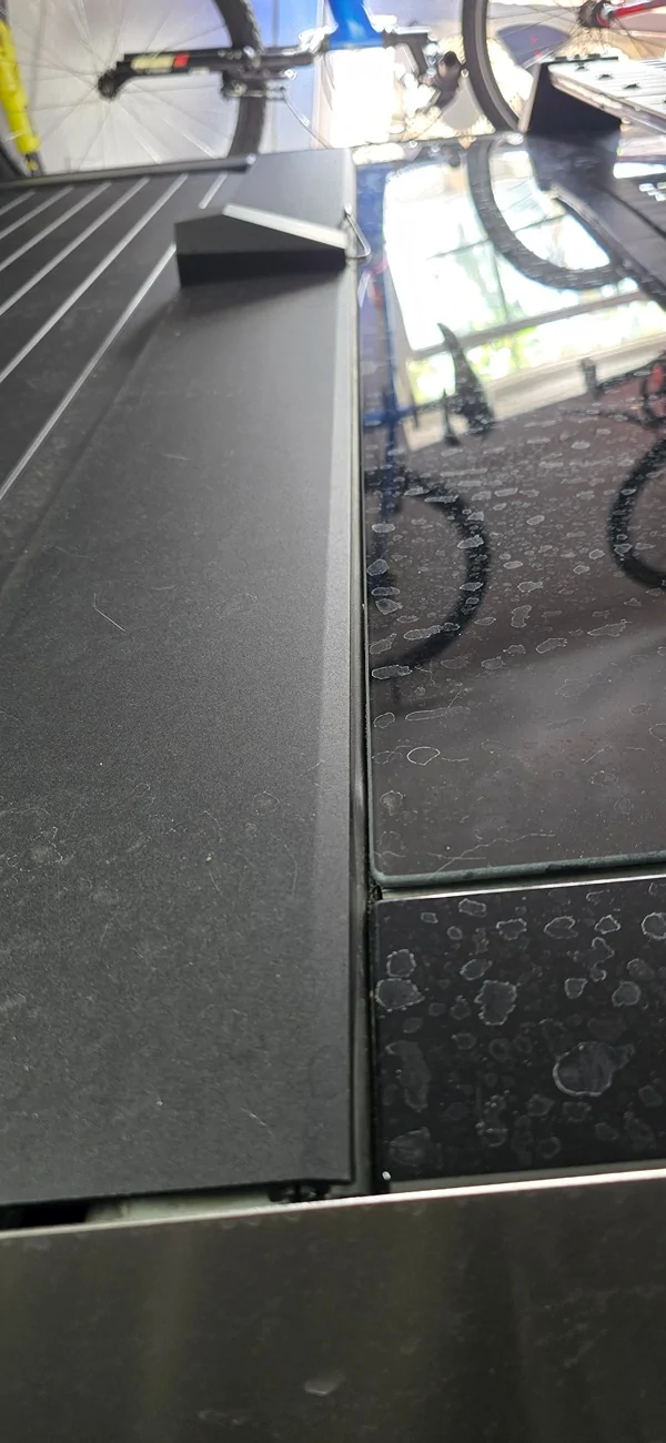

I ran my wire in the gap of the trim piece and I haven't noticed any leaking yet.

Which gap did you run it in? Did you run it along the top or from under the trim?
Under the trim. Note I do have the cyber tent so I can easily remove the trim. Not sure if that matters.
Nice, did you silicone it or anything or do any extra work to it? Mine leaks exactly there where the cable passes under the trim. I've tried silicone but still no success.
