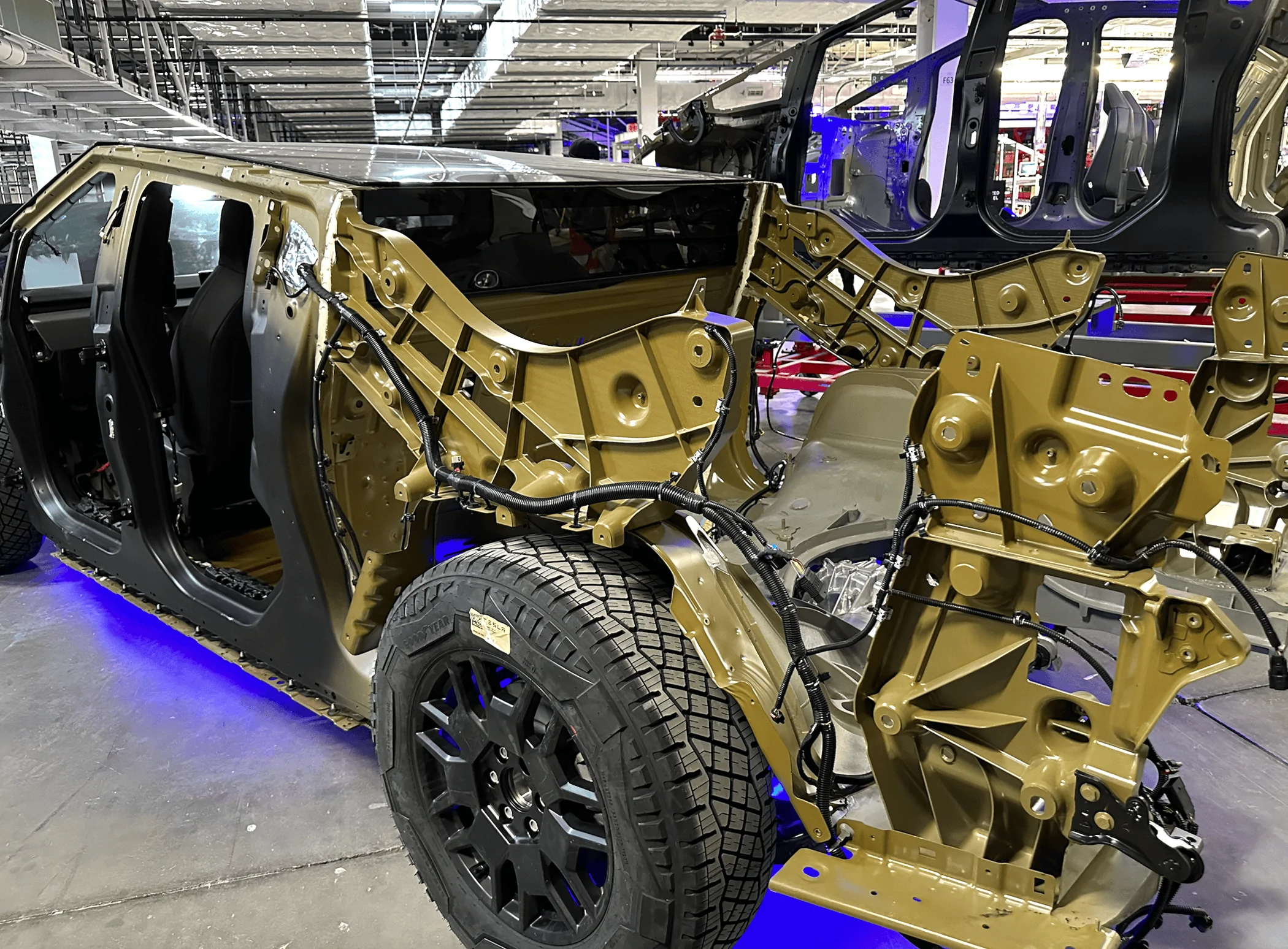

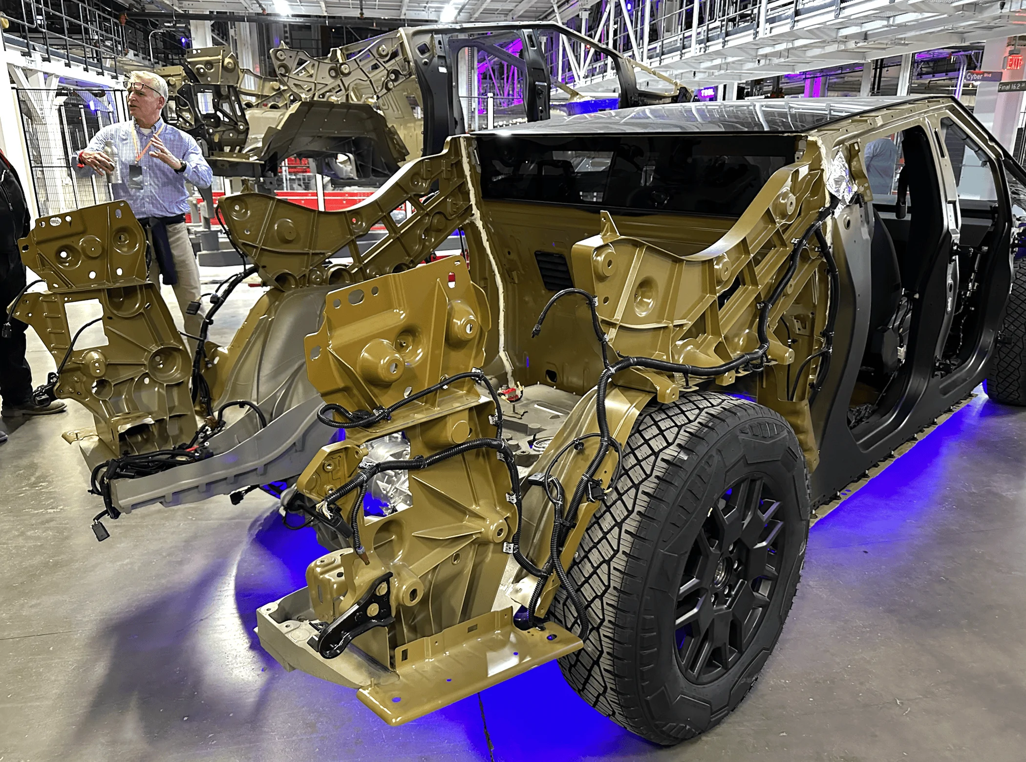

I'm curious what were the main considerations with regard to deciding upon a left or right side mount.
Also curious why all the lines appear to terminate somewhere Vancouver, BC. while your profile says you live in California.
>I'm curious what were the main considerations with regard to deciding upon a left or right side >mount.
I clipped two antenna lip-mounts on both sides, the left side is for HF, the right side is VHF/UHF. My main consideration was to avoid the HV cables as much as possible (right side = better, away from HV charger inlet). See attached pictures of Cybertruck wire harness before final assembly, missing the orange HV cables, they are on the right side. In retrospect don't think it matters.
