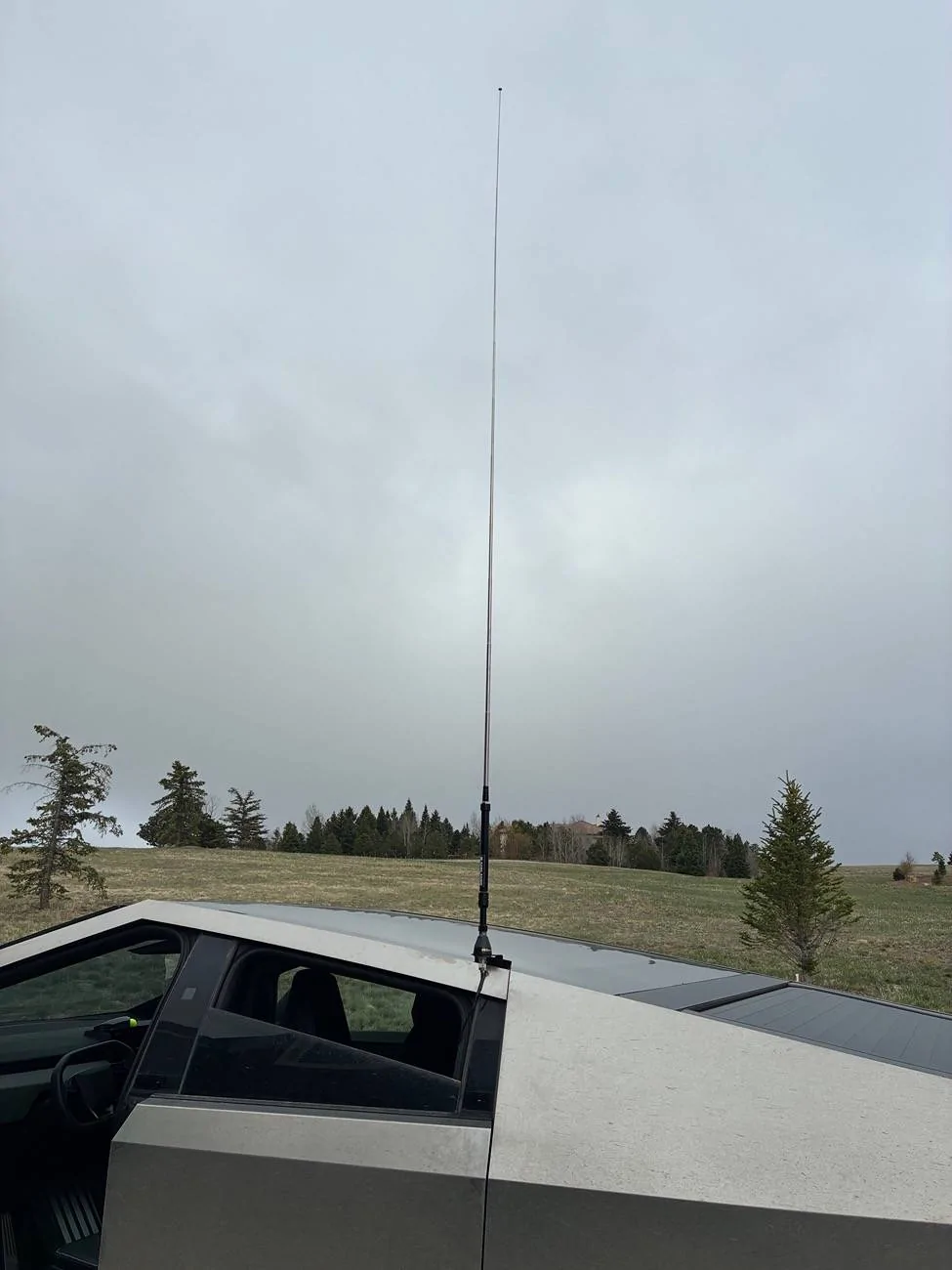

Sure! ? This was a pretty easy setup for me.

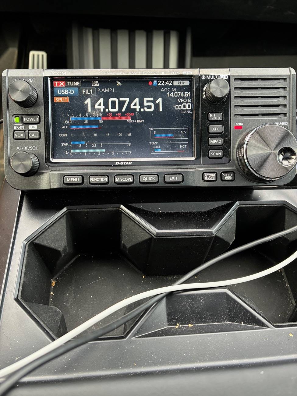

I operated 20 meters FT8 in my usual way:
- IC-705 at my usual 10 watts. The Bioenno battery was in the passenger seat.
- Laptop on my lap, running my homebrew software + WSJT-X
- The usual cables, toroid, RFI choke
- The usual Icom AH-705 tuner
- No amp

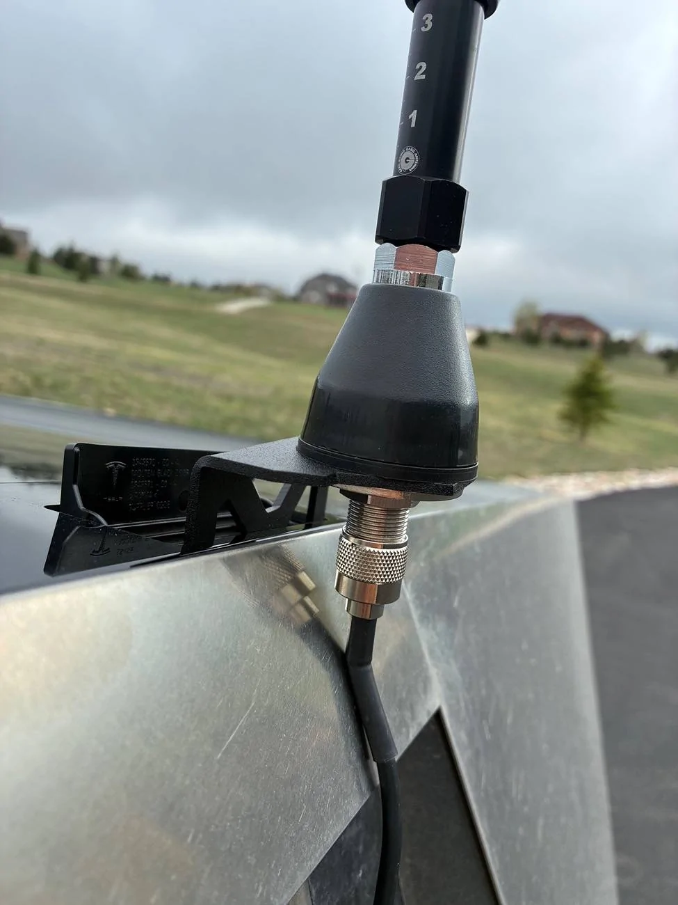

The Mohawk Designs 3/4" hole mount was easy to install with a 10mm socket. I put their washer on the very bottom against Cybertruck.
I used a Wilson Gumdrop for the HF-antenna-to-coax connection, sourced off Amazon for $15.
