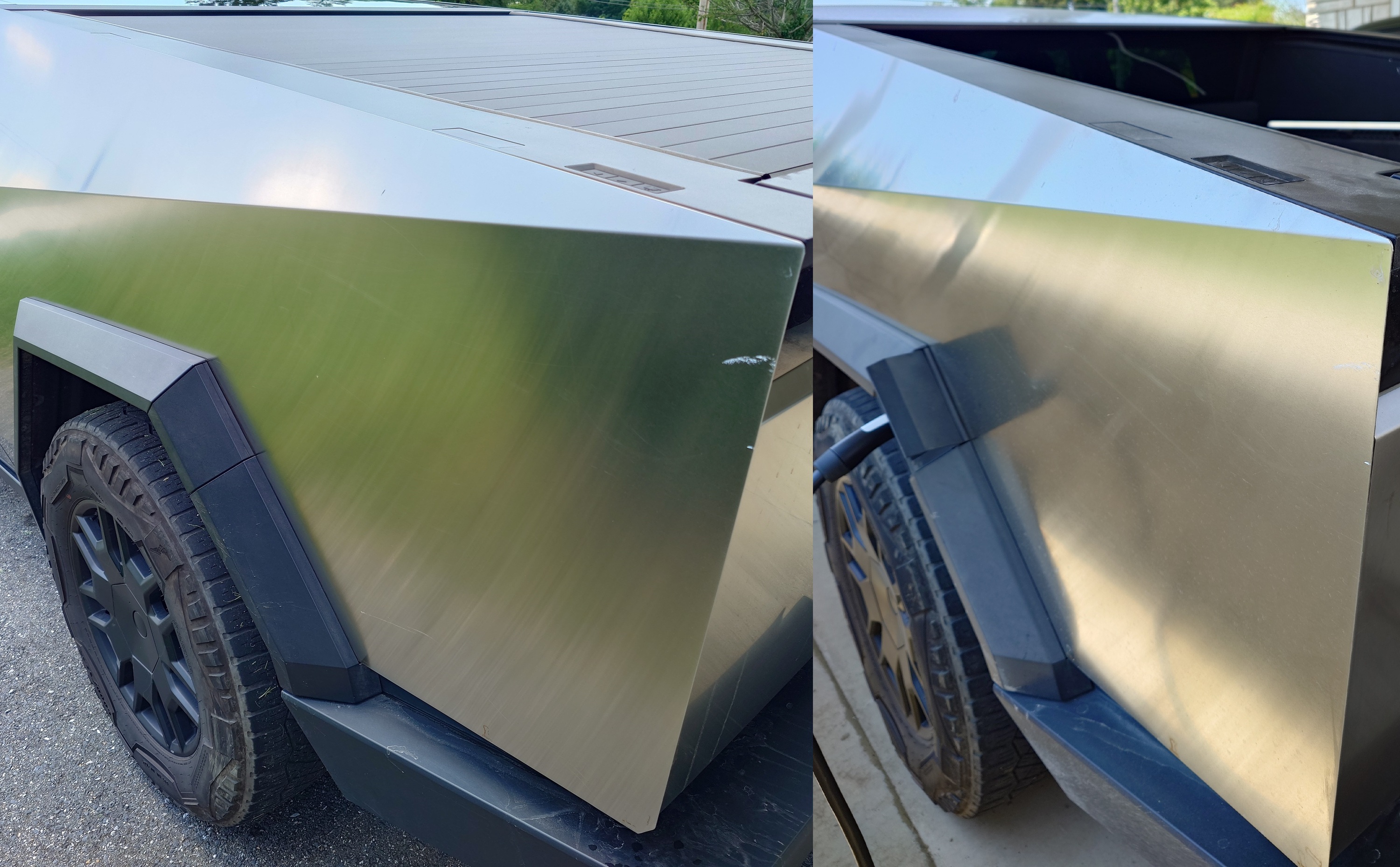

For a lot of the marks CitriSurf 77 Stainless Steel Passivation Cleaner (NOT the Plus) does a good job cleaning them up. I've got all kinds of pin stripes on mine from jeep trails and in the pictures are the large paperclips that rusted on the truck from christmas lights. All I did was spray a cloth and wipe down the stainless (real scrubbing would take care of what remained).
There are some stripes on it that will need a real buffing but for the most part just a cloth and CitriSurf gets rid of pretty much everything.
No other complaints about my stainless (August 2024 purchase)

I noticed after the server restore my pictures were gone. I think these were the two I used.

Wow, so you only sprayed the Citrisurf77 onto a microfiber cloth and wiped the stainless down? You didn't have to spray the solution onto the stainless?

You are supposed to. I did on the main panels but not for the specific pictures I posted. You are also supposed to put a little more effort into it when you use it. I didn't bother as the next weekend I was going out offroading again and it didn't really matter that much.
I do believe the Citrisurf77 would make the entire thing shine if elbow grease was used. But for plain clean look it isn't needed.

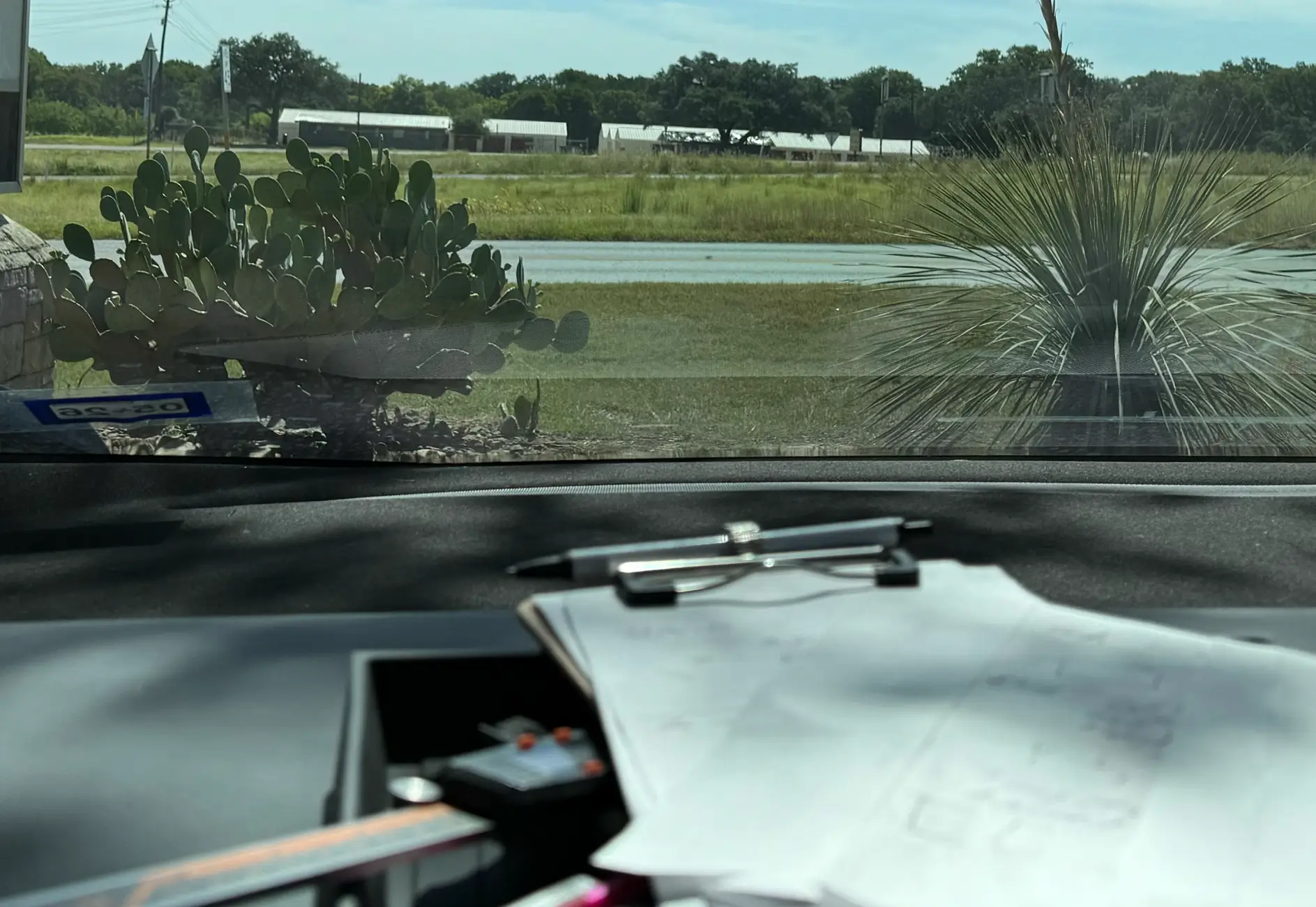

I've got an area about 2x4 inches where it appears the brushed surface finish goes in a different direction - this came about I think from when a bird hit and the front was very muddy. The sand scrapped as the bird impacted.
Well that's what I think happened. Lots of abuse and off road and nothing else. One or two of these snap on plastic pieces under the front and rear bumper caught on something in kind of rough land and came off. They pop back on pretty easy. Maybe I'll just pull them off, come to think of it.
These two cacti are perhaps 4' apart. maybe two feet of the spines bending and scraping both sides. I know I can drive thru with zero damage. No painted vehicle would be anything but totally ruined trying to do this.
