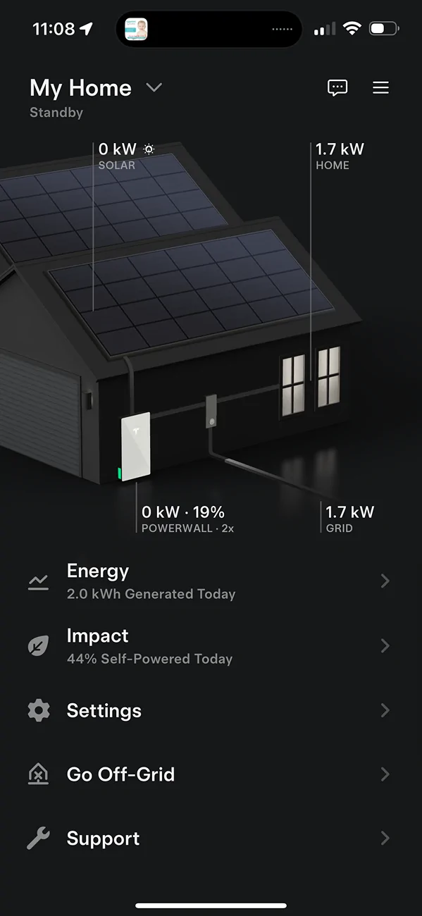

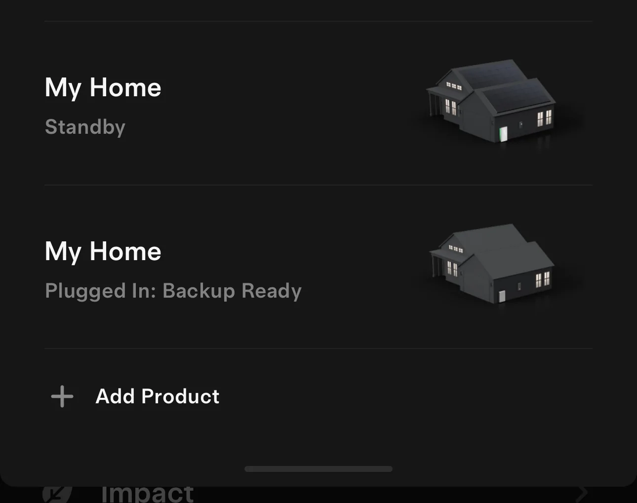

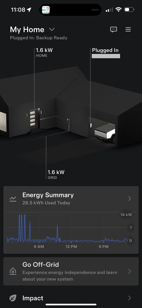

The guys are done. But now I have the issue where I have two homes. One old one that I had from PowerShare setup and new one with solar. When I plug in the car old one shows the car plugged in but new one doesn’t. Old one doesn’t show solar panels on the roof.
New one shows panels on the roof but no car plugged in.
Has anyone dealt with this before? Is that something they need to fix or it’s on Tesla end

This is expected based on the installation.
Eventually, when Tesla releases the Powershare with Powerwall software, the Powershare communication lines will be disconnected from the UWC. Then the Powershare Home will get deleted (or at least the UWC removed ) and the UWC will get added to the home with Powerwall.
This could be done now, but you would lose the ability to run anything from Cybertruck via Powershare .
