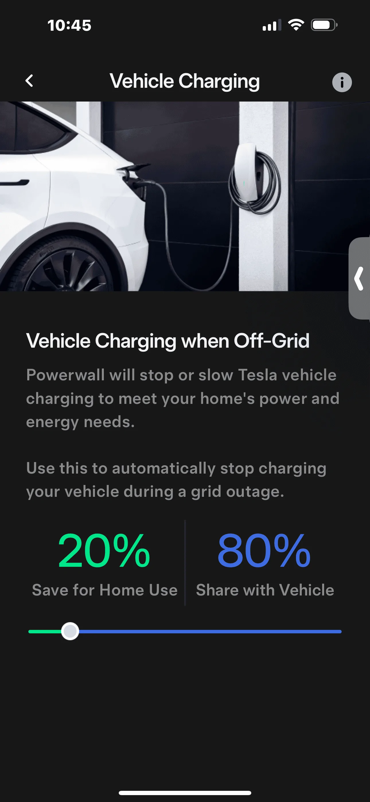

When you have Powerwalls , they are controlled and monitored through your same Tesla app and there is a vehicle charge setting option for your solar generated power.
Tesla Cybertruck Powershare and solar IMG_0941
