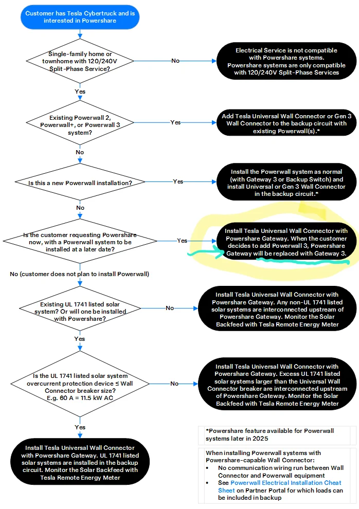

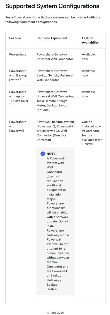

Hey, would you mind connecting me with your installer? My installer is telling me that, in order to get solar, PW, PS, and CT working together, that I need my existing PS gateway AND a new Gateway 3.
If the PS gateway (which I bought in 10/24 and have not installed yet) is not capable of managing the solar and PW elements, why would Tesla sell it as the solution (pending software update)?
I shouldn't have to shell out an extra $4k for a second gateway...
Your installer is wrong, unless they are doing a stacked system where Powershare kicks in after Powerwall runs out...
The Powershare Gateway (3V) is not compatible with Powerwall. You need a Gateway 3.
Tesla
https://energylibrary.tesla.com/doc...UID-04DE7F20-2290-4489-A9A1-53F639BB85CB.html
Tesla Cybertruck Home solar and powershare Screenshot_20250824_144536_Firefox
Tesla Cybertruck Home solar and powershare GUID-43A41FB1-8967-4673-BED5-EF8D38F48CBF-online-en-US

Yes, I gave these exact two screenshots to the installer, who asked Tesla, who responded with basically the same thing, that the 3 takes over for the 3V. Yet, the 3V was sold with the promise that PW support would be added 2025...
So.... Why the fuck did I buy a PowerShare Gateway?

If it had been installed when you bought it, you would have had around a year of Powershare backup, plus it might make the Powerwall install faster.
However, if the inital install is Powerwall, there was no purpose. Might be able to sell it to installer or 3rd party for their use on a Powershare install.
Not that it helps now, but the web pages always called out that a Powerwall setup didn't need extra hardware for Powershare, just the software.

They'll need to remove the Powershare Gateway for the Powerwall install.
