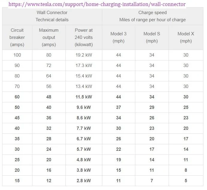

I it this charger it’s really good happy with it.. lot of charger for the money WiFi you can monitor and adjust the charging rate ..
my issue It show 48A max but I’m only at this rate should add at least 40 mile per hour but I’m only 27mile per hour .. I’m using 14-50 plug ..

123000 watts / 11500 watts = 10.69 hours of charging. 40 miles * 10.69 = 427 miles. Your truck has a range of 318. 318 mile /10.69 hours is 29.7 miles per hour charging at 11.5kw. Factor in efficiency and other crap and there's your 27 miles added per hour.
First, you should not be running a nema 14-50 above 40A continuous. That's dangerous.
Second, nothing anywhere said 40 miles per hour for home charging with regard to cybertruck.
Some quick math says 29 miles per hour would be the expected if there were no losses, so 27 miles seems exactly correct.
Aside: See the tesla chart and look at the 50 Circuit breaker (amps) line for 40 Maxium output (amps). And see the relative charging speed (miles added per hours) for the other Teslas.
