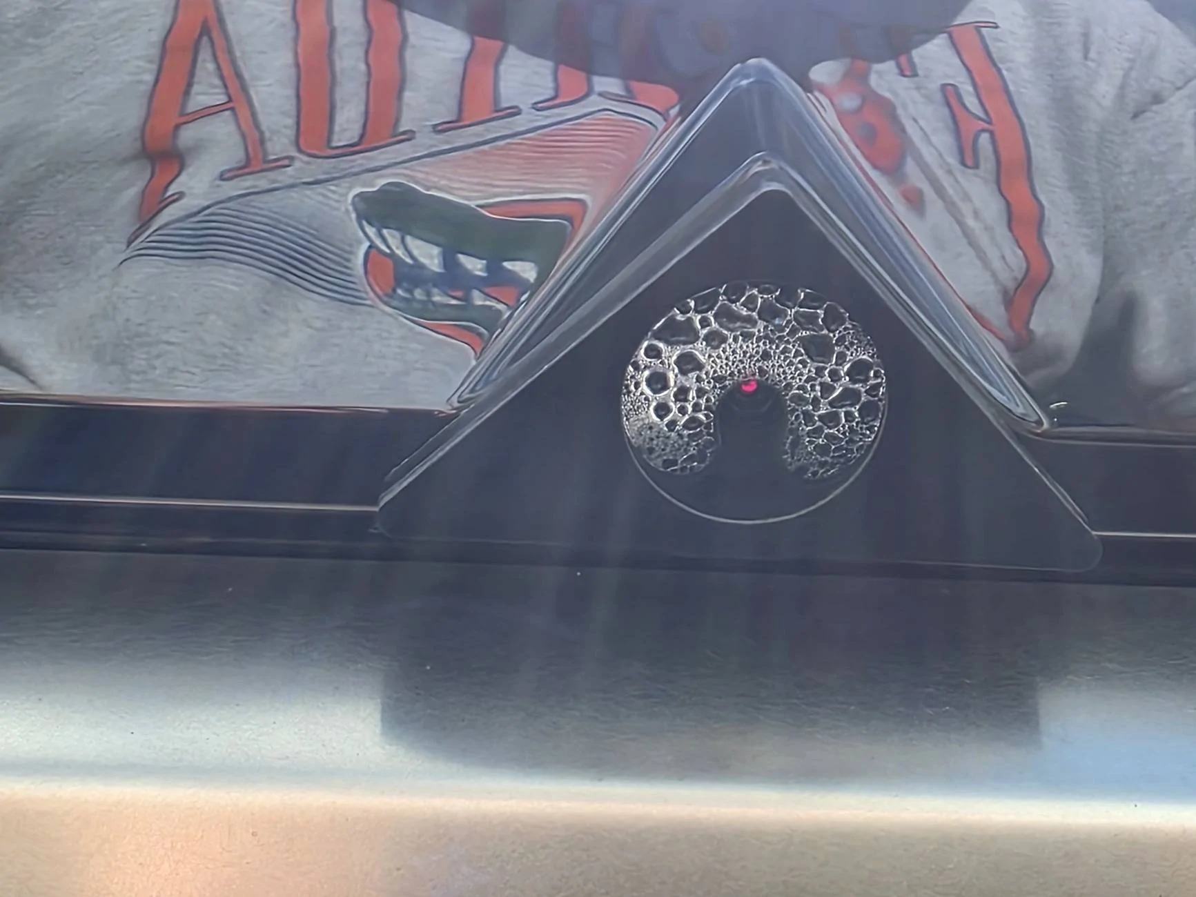

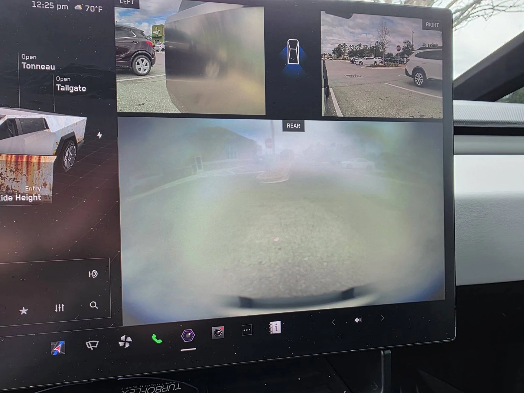

Here is what my v1 looked like after getting CT washed today. Water is inside the cover. After an hour driving around and sitting it is still wet inside the cover and I"ll probably have to remove it I ordered a v2 so hopefully it will not do this again with water getting inside.
It's difficult to determine what's happened here. Obviously, there's been some water ingress, but there's no way to really know if it's an installation issue or an adhesive issue. But obviously it's not supposed to be that way. If it was a car wash that uses pressure washers as part of the process, then that's certainly not ideal. I pressure wash mine (by hand), but it's important be careful around the cover.
I will say, that for the Model 3/Y cover, we had more issues like this, but those are a more complex shape, have less adhesive, and more of an enclosed area, so there's more chance of issues. The CT cover is flat, and so far we've had less ingress issues based on the first batch of 1000.
That area on the back of the CT is obviously very abusive in terms of airflow and crud getting thrown up due to the aero effect across the top of the vault cover, so if there's any place some moisture can get in, it will. If you've not done so already, please reach out to support for a replacement, regardless of cause, we'll always offer a replacement with evidence of an issue. Mention this thread and the Gator's t-shirt, they're expecting you :)

This happens every time on my model Y when I go through a car wash. Cleaning doesn't help much, that's why I hand wash when I have a cover on. A regular hose won't bother it.

Same thing happened to me.

When I did the install, I hit both the truck camera housing and the AO lens cover with a heat gun for a few seconds. Dunno if that would make a difference or not, but maybe it helps the adhesive bond better.

Certainly doesn't do any harm, especially if it's a bit chilly (<55f) (or just park in the sun for a few minutes).

I had this occur also but fixed. The version1 (haven't replaced with v2 yet) 3m ahesive was so difficult to remove the red tab that when installed it left an opening where rain water could enter. Fortunately, that opening apparently allowed the water to evaporate after 2 days, I trimmed a high quality electric tape to cover the opening and no water enters. I read somewhere the 3m adhesive has been improved in v2, as others had similar issues.
Outside of this issue (and once it was stopped), this has been an excellent improvement and i continue my subscription.
