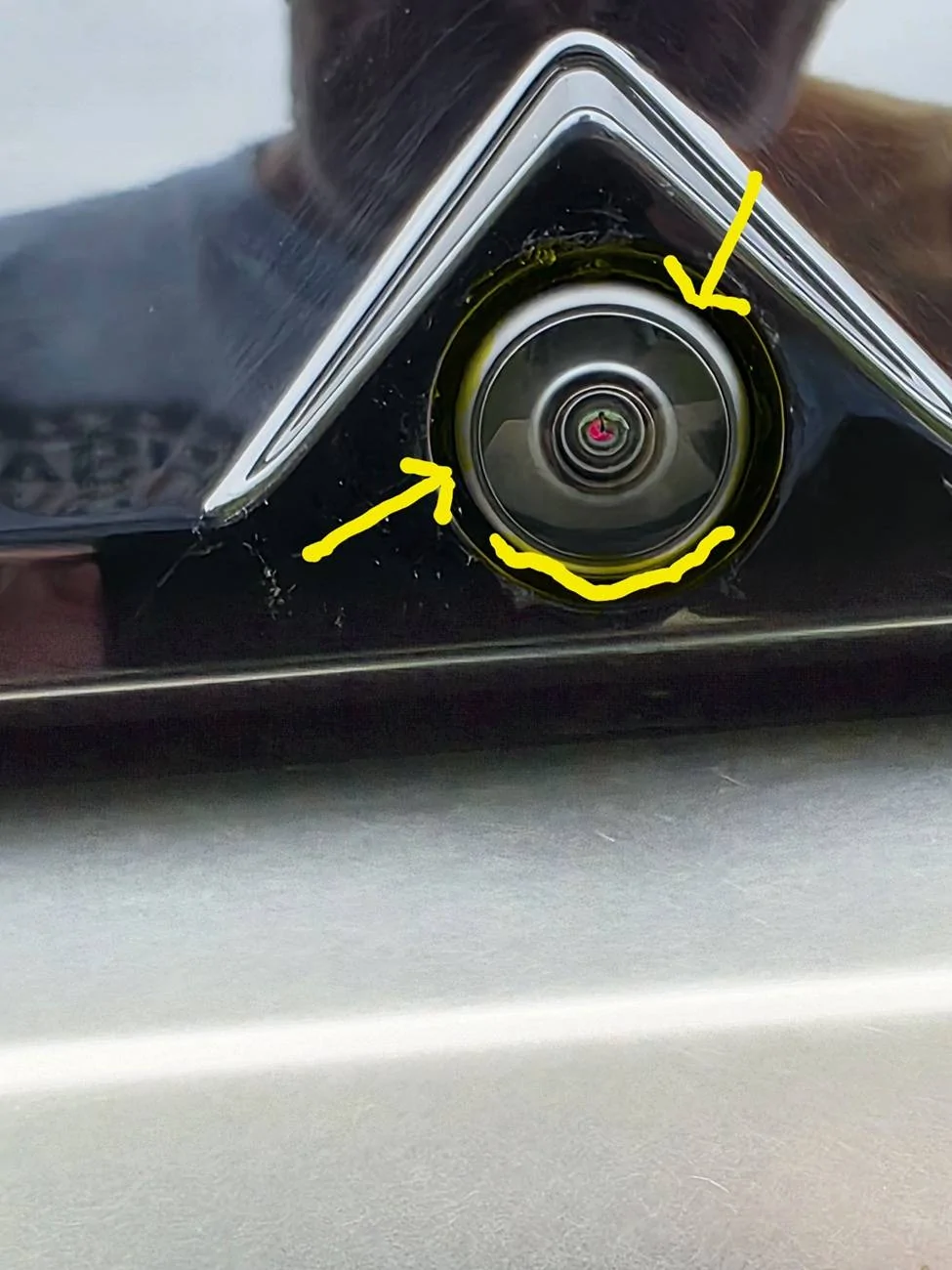

I'm on my 2nd (1st V1, 2nd v2) and both got water intrusion on the inside of the cover. Both water intrusion happened after the CT was washed (1st one through Car Wash and 2nd one when Tesla SC was testing water intrusion into vault before and after fixing the seals on the roof applique and testing with water.
After getting my CT back from Tesla SC I noticed the water intrusion on the v2 cover (I've had the v2 cover on for over 5 months with no inside water intrusion). I started to think how did that happen. The water intrusion for both cases happened when the tailgate was put down right after water was used. All of my times doing car washes I never have let the tailgate down and truck always is completely dry when I let the tailgate down and no water leaks out.
So I did some testing and have found out how the water intrusion is getting on the inside of the cover. The water is getting inside the cover from this gap around the camera. Coming from the back of the camera housing.
You should be able replicate this issue yourself. I have taken off my v2 cover and was able to see water come out from around the camera when I soaked down my tonneau cover then lowered the tailgate.
I'll do some testing using some waterproof Silicone to seal around the back camera.

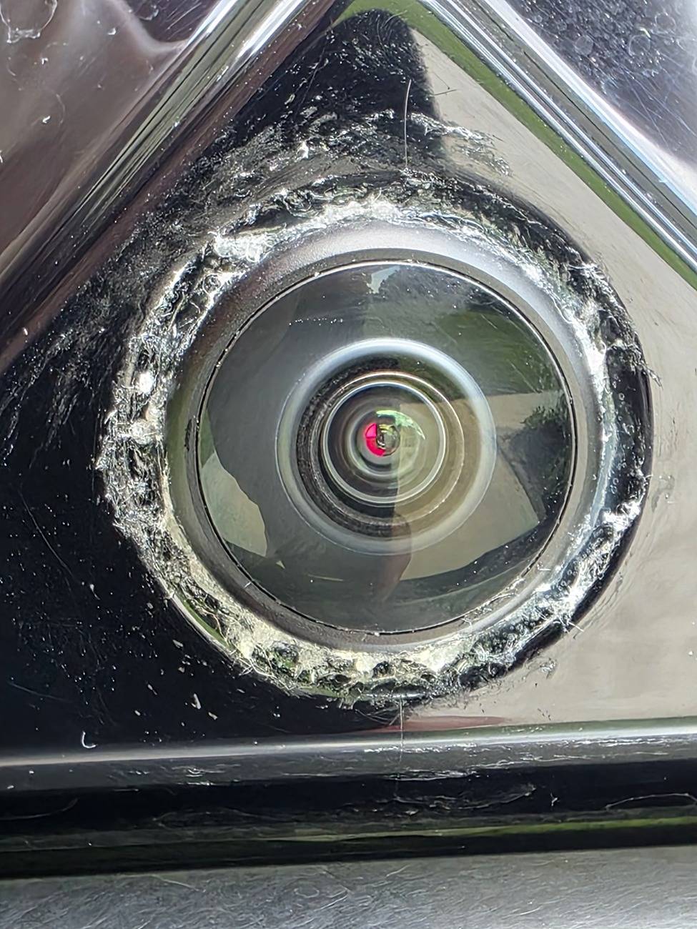

Before silicone:

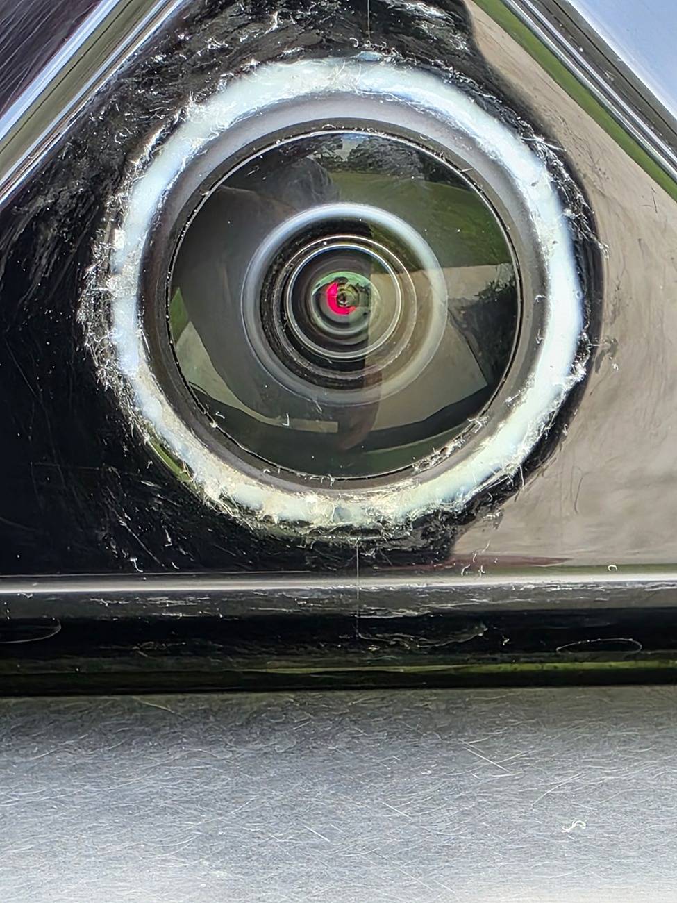

Right after Silicone install:

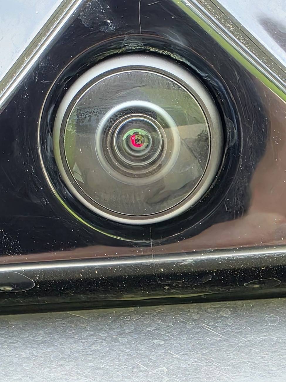

After clear Silicone 12hr cured installed: Not very pretty but the seal is good.
