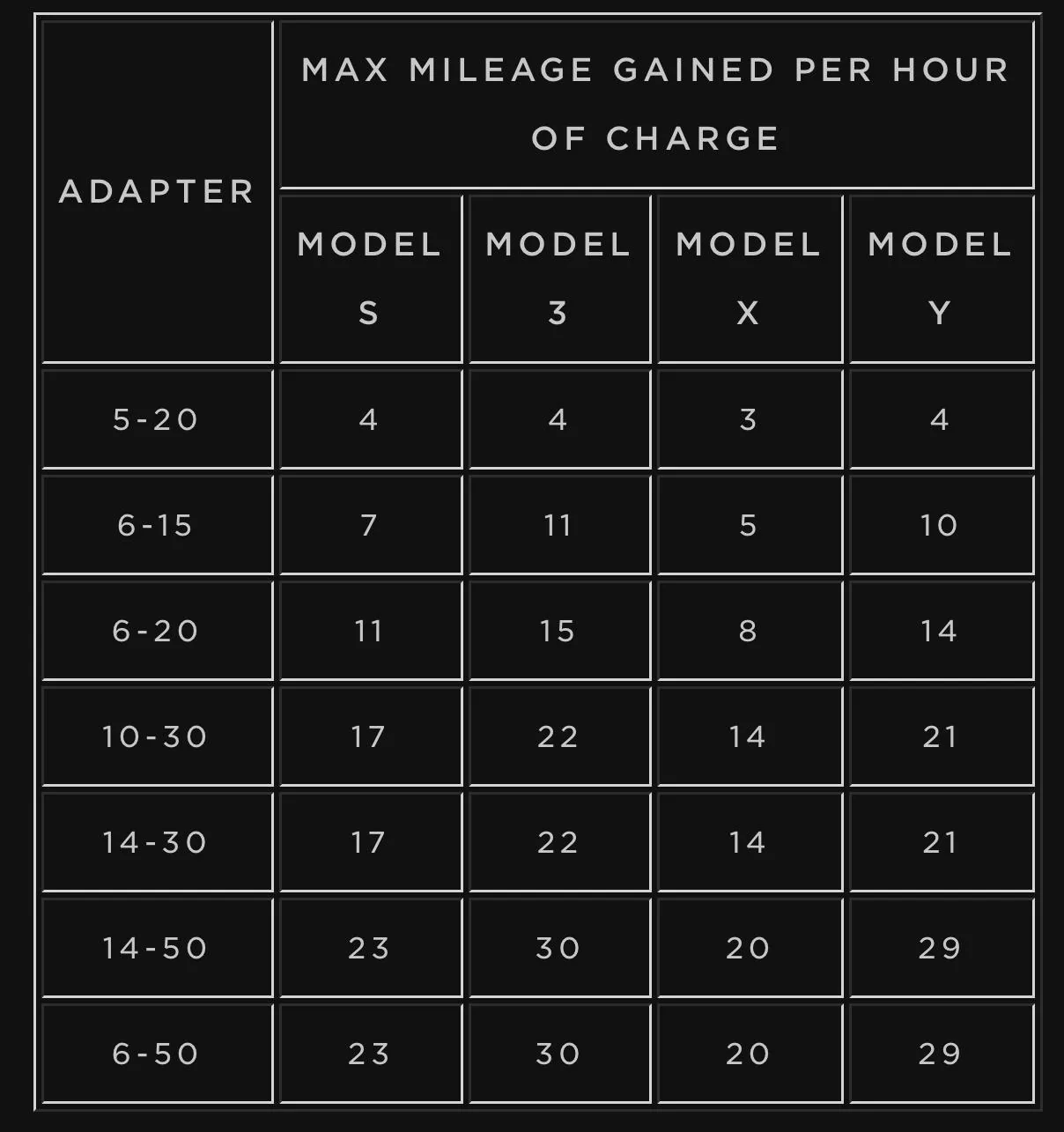

The Mobile Adapter is included with the shipping trucks. With the right adapter, you can charge off of just about any plug Gen 2 NEMA Adapters (tesla.com)

Not one. So that means, you might be waiting awhile before that install happens. You need a plan B. Either use the local supercharger or get a NEMA 14-50 plug installed.

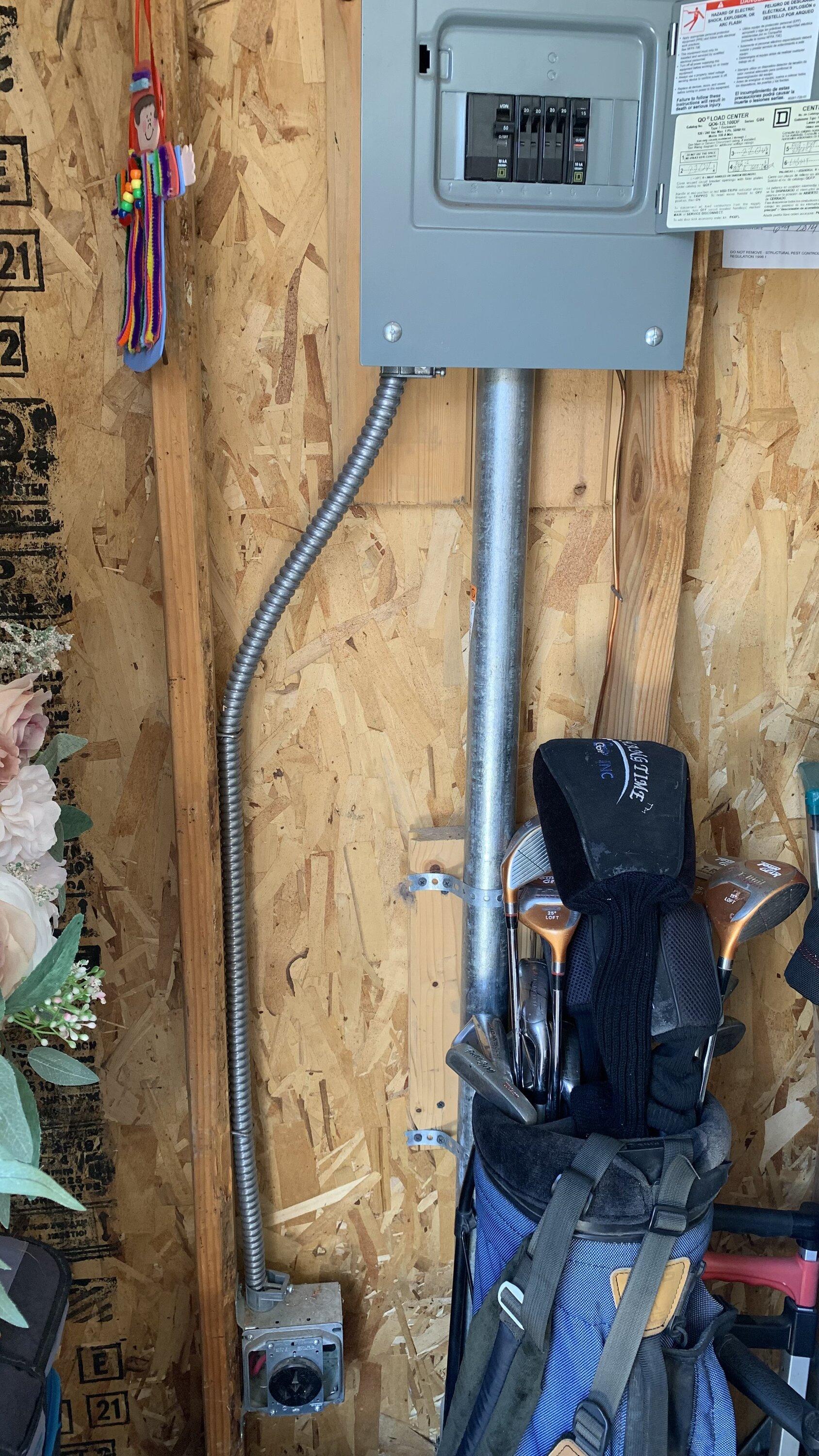

I plan to upgrade my NEMA 10-30 plug, but I am not sure if it is worth the effort & expense as a temporary solution. The NEMA 10-30 adaptor from Tesla is $45. Not sure how much the install + materials are to upgrade to NEMA 14-50.
