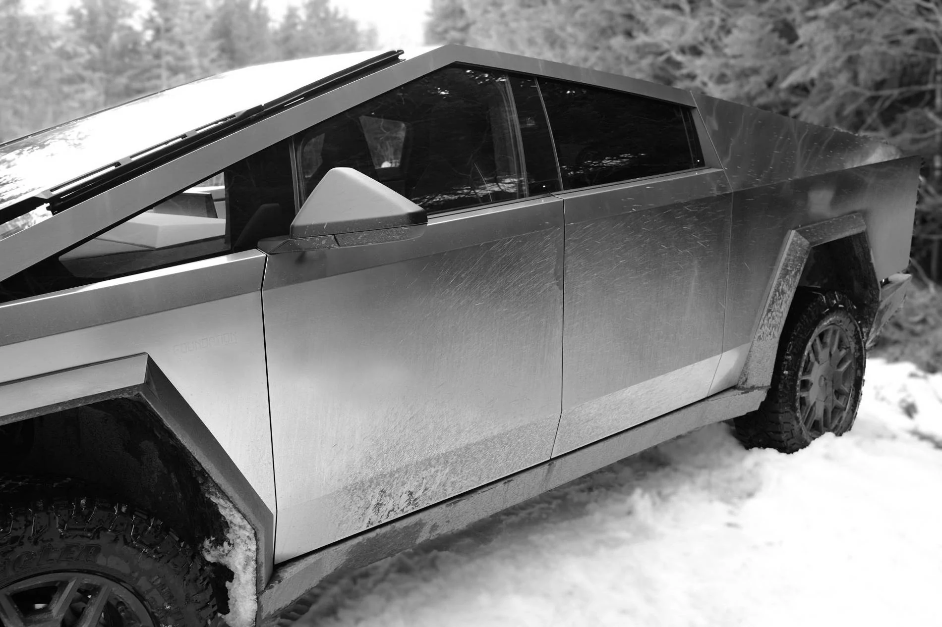

Fuck that, I like Clean SS Look!
I think it looks great dirty too! I'm keeping all coatings off my truck because coatings fail and need to be re-applied if you need to work a few fine scratches out of the metal. With the uncoated Cybertruck you have no real worries.
Tesla Cybertruck Is the Out of Spec's detailing solution semi permanent (fingerprint and stain proof)? DSCF0858(1)adsm
I don't even mind the visible fingerprints in the dirt where I touch it to close the driver's door (visible in the photo above). I can't understand why people get so persnickity over fingerprints on their truck. It's a truck, not a religious icon!

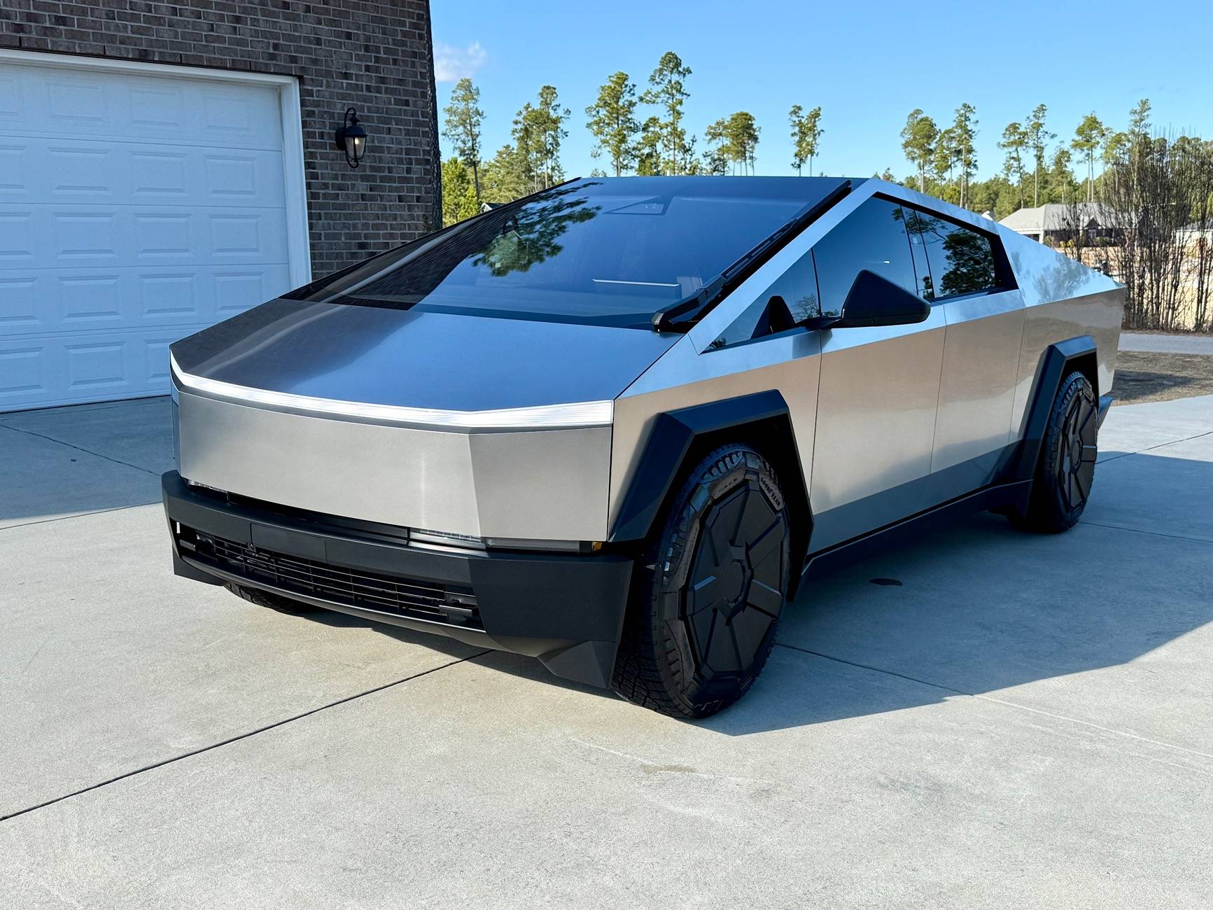

Go for it. You won’t regret it. I followed those steps and coated mine in December. It’s holding up great. It’s so easy to keep clean now. Don’t listen to the just use Sprayaway comments. Yes that kinda works but a coating is way easier to maintain. It looks clean even if it’s dirty.

That looks impressive! Clean SS look is the way to go IMO.
how long did it take you, how is it holding up?
All cars get fingerprints, my kids hands are almost radioactive, they stain everything with their hands so I don't mind fingerprints as long as they can be cleaned easily like any other car.

Thanks man. I spent around 3 hours doing the Bar Keepers and the around 3 more hours prepping and installing the ceramic coating. It did it over a couple days period then let it set a couple more days to cure.
It’s holding up great. It seems just as hydrophobic as the day that I installed it. It’s the best ceramic coating I’ve ever used.
It will show finger prints but they wipe off with just a microfiber or with some waterless wash.

Great to hear! this helps a lot, did you use the ceramic coating that Colton recommends?
