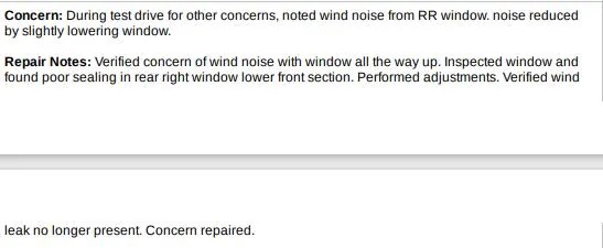

I actually just had this addressed by service last week. Funny enough I didn't raise the issue, but they found it during test drive and fixed it. There was definitely a noise coming from there, but absent mindedly I didn't add it. :confused: Regardless....it's MUCH better now. No parts....just adjustment.
Good to know. I will ask them to take a look. Thx
