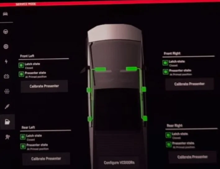

kpanda17
Jun 8, 2023
993
1,014
Service menu, recalibrate each window
summer seals are expanded
Winter seals are contracted
Recalibration fixes it

koolio
Dec 4, 2024
1,046
1,104
Greater Boston, MA
Really? Didn’t think that’s what window calibration did but makes sense.
Service center calibrated mine and it didn't make an improvement.
kpanda17
Jun 8, 2023
993
1,014
They calibrated mine and it didn't make an improvement.
Then it’s obviously a different issue, miss aligned doors or failed seals in the rear
Tesla Service visit in winter is best as the seals will just get tighter into the summer
