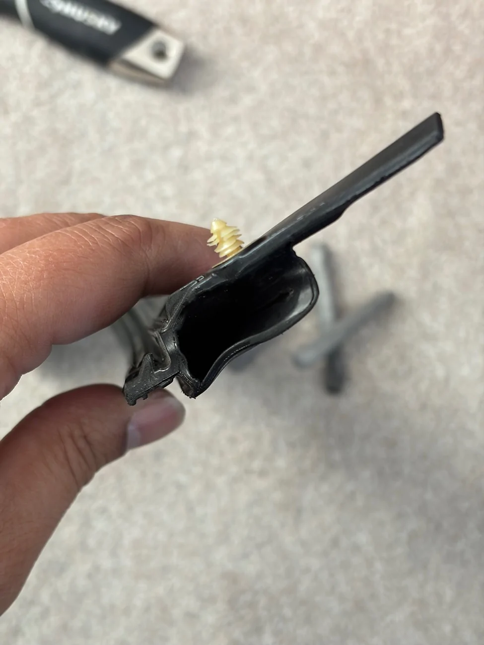

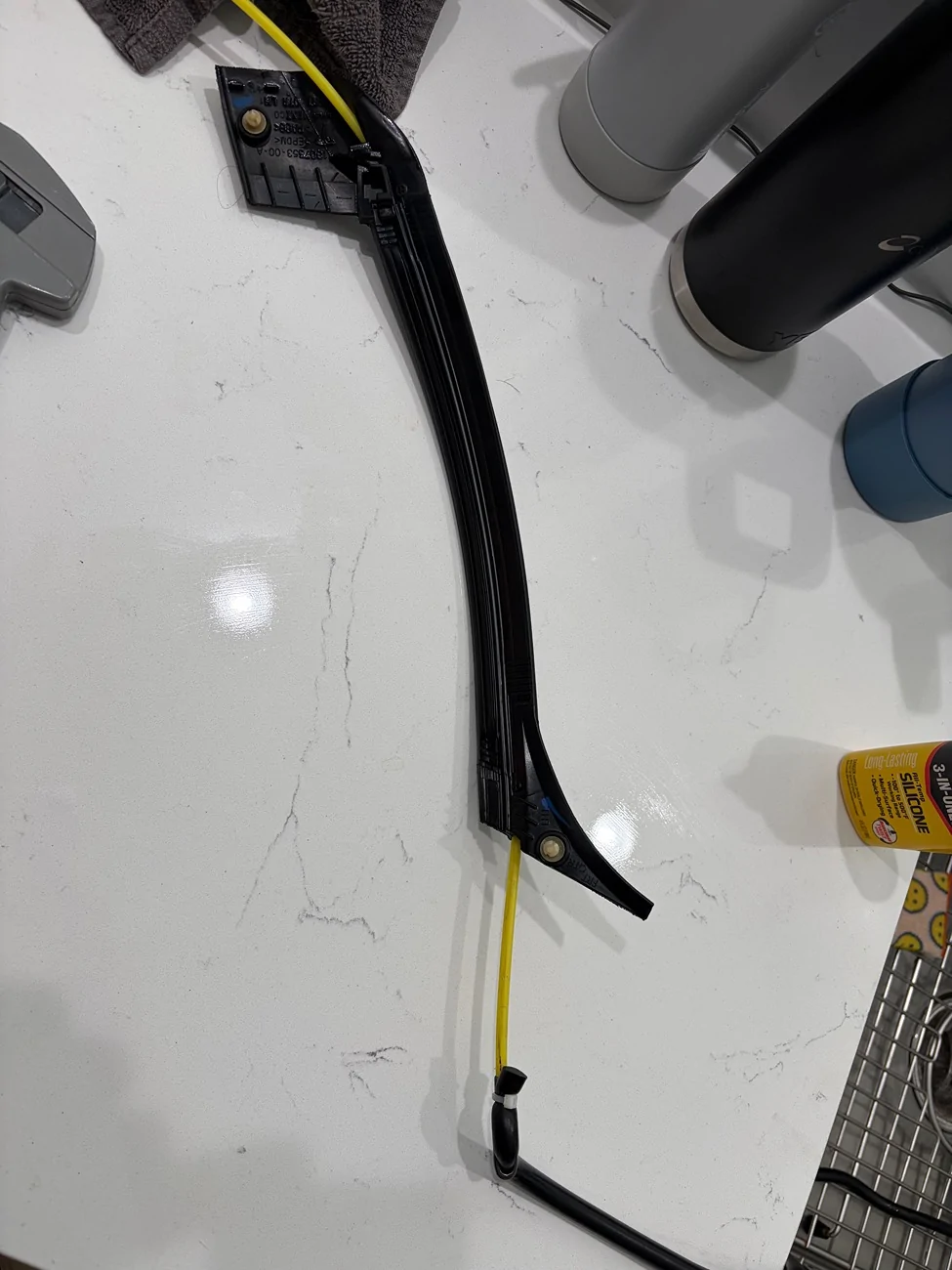

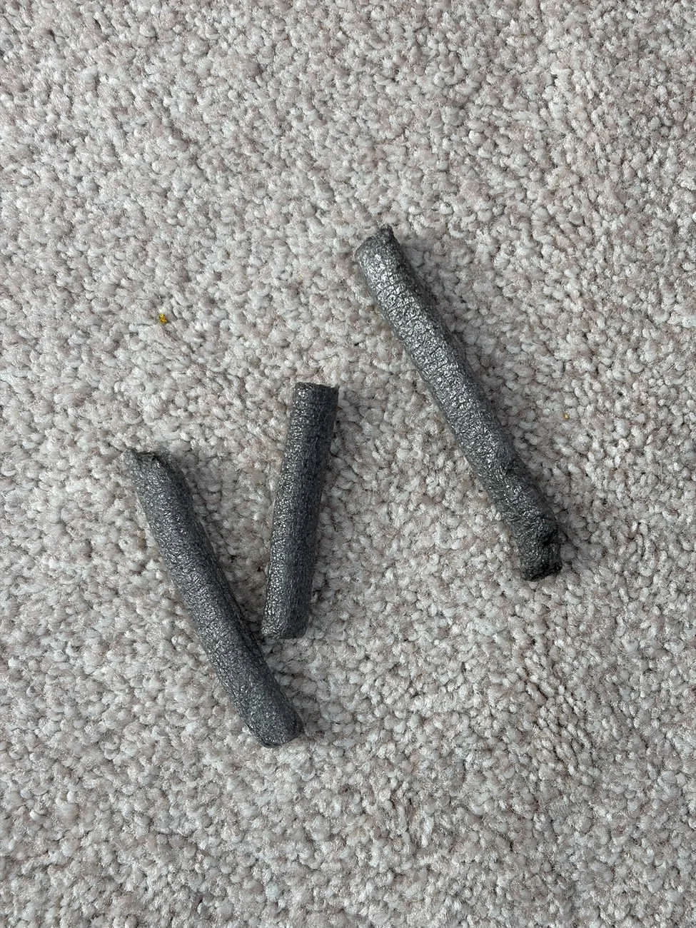

I took mine into the SC to get fixed a couple months ago and it worked well for the first few weeks. Now that it is below zero here in the midwest the issue returned. I took some suggestions from this thread and decided to come up with my own fix.
The SC used pieces of foam insulation backing and stuffed it into the seal. It seems like this stuff doesn’t retain its shape in extremely cold temperatures. I followed the instructions from this page and removed the Seal for the Quarter Glass. Then I took out the foam backing that was put in there by the SC and replaced it with a 3/8” Rubber Backer Rod. So far this is holding its shape very well in the cold weather and I am no longer hearing any wind noise leaking inside the cabin.
The rubber backer rod is difficult to push through on its own so I used an Ethernet fishing line and 3-in-1 silicone inside the seal to help pull it through.

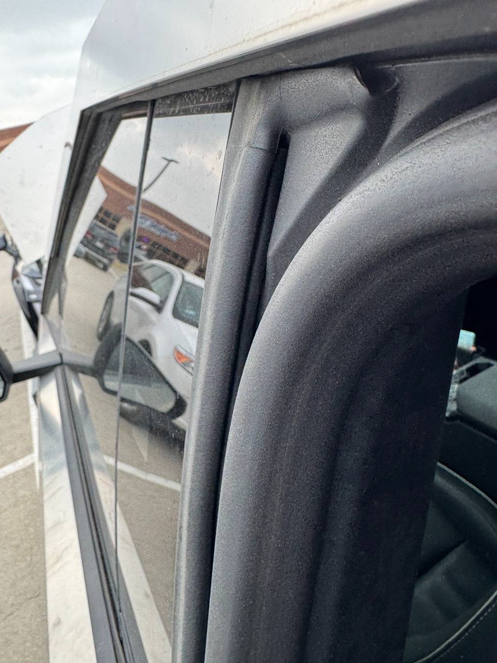

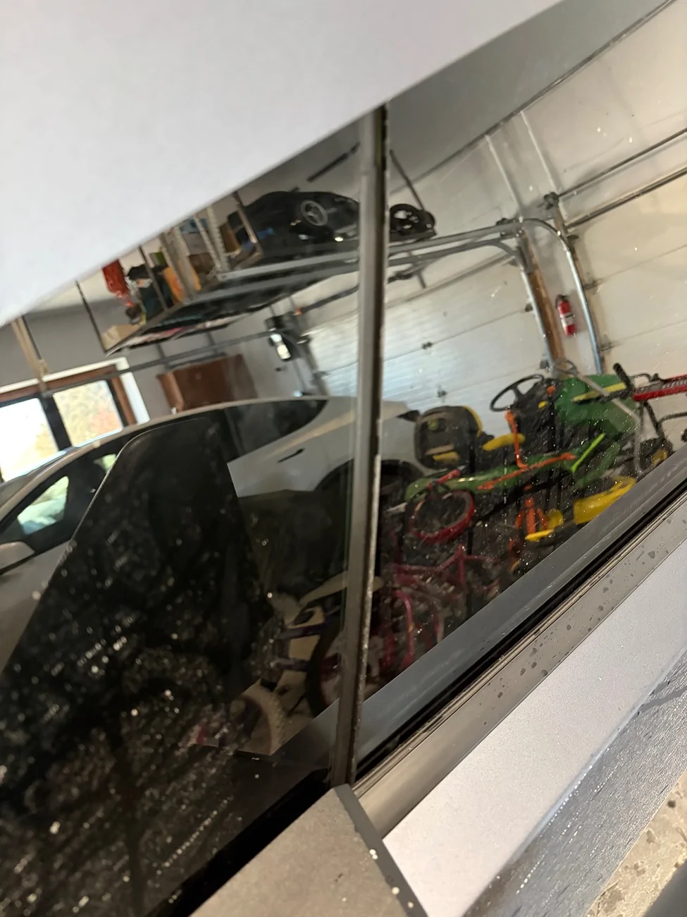

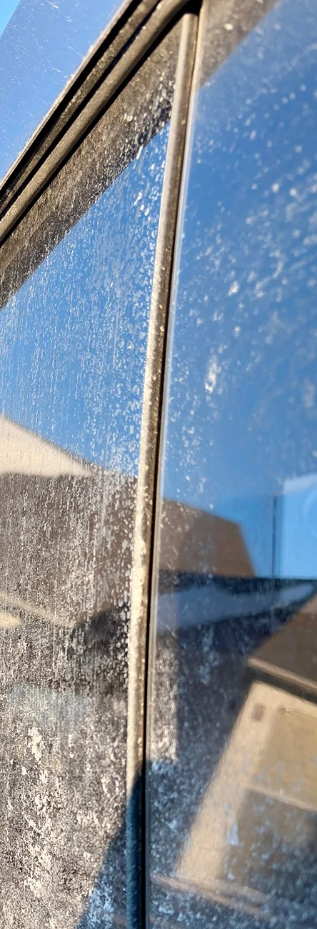

I looked at my rear passenger window today, and opened and closed the door, to watch the window seal from the outside. It appears to go up, hit the top seal, and the window bulges a little when it stops. You can see the tiny gap on the B-pillar edge. To stop it, you'd have to have the window stop just a fraction earlier than its calibrated "top". I'm wondering if I put a little piece of foam, less than ÂĽ" thick, in the top track and recalibrate so that it doesn't go up as far, will the window stay shut against the b-pillar gasket? If I find some foam, I'll do it tomorrow. Should I wash the truck too?

Same issue, rear passenger window. It appears to go up, hit the top seal, and the window bulges a little when it stops leaving a tiny gap for wind noise, slightly lowering the window 1mm allows it to seal properly.
My SC has attempted to fix this exact issue 4 times and have been unsuccessful. They tried stuffing the rubber caulk in the horizontal rubber seal to help push windows in, but the didn't work for long, recalibrating seems to fix for a moment, but somehow it forgets and starts eventually jamming the window to far up again.
