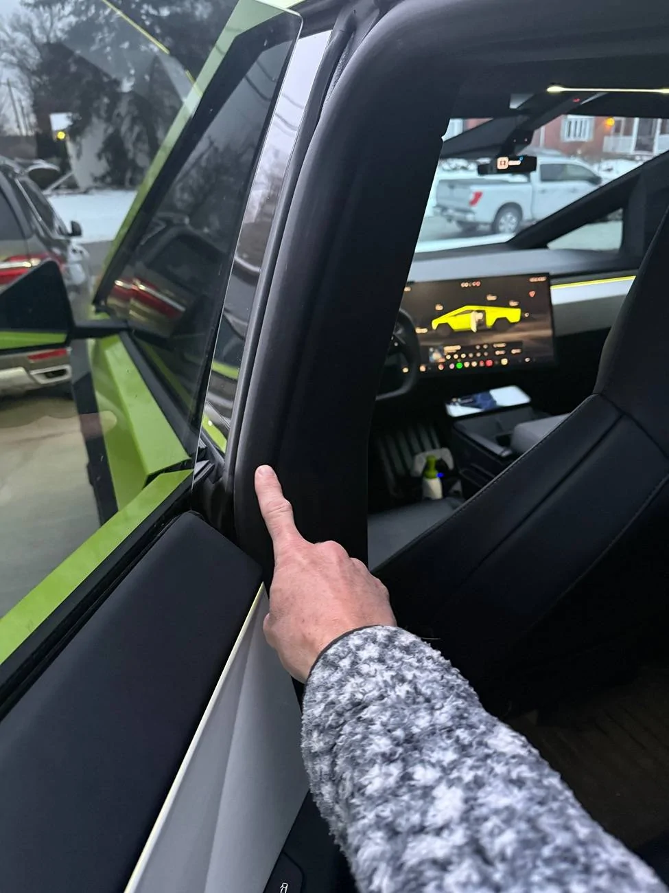

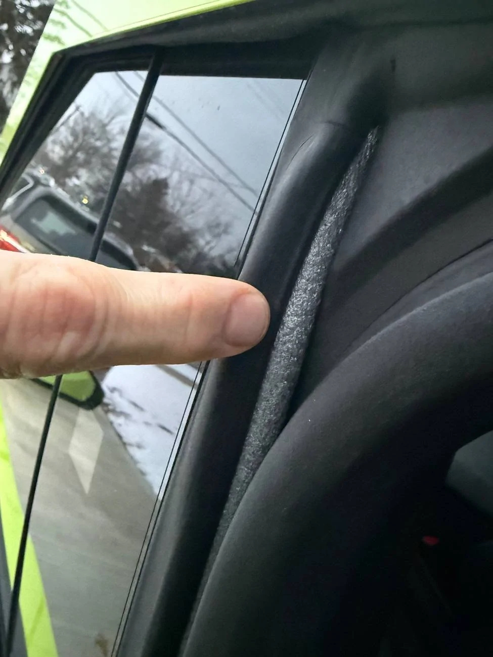

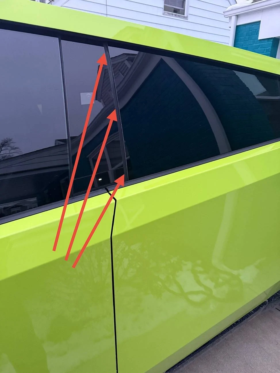

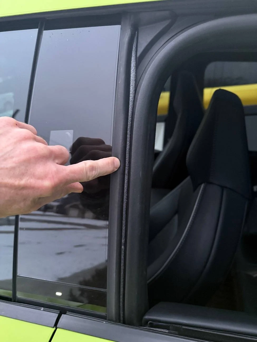

Do you have pictures of what you did? I just had mine in for service for this yesterday and they did something similar, but I couldn’t tell where they stuffed the foam rubber at first glance. Whatever they did definitely made things better, but I still hear some air coming in.
Yes sure thing and here you go. Pressure fit it on the B pillar side and also I noticed my gasket trim surround(finger pointing to it in the last pic) needed pushed in as it was a little loose(partictularly around the curve at the top). I knocked that in with my fist up and down and around so it was snug again.
Thank you! This is helpful to understand how it is being fixed and seems pretty DIY friendly. :)

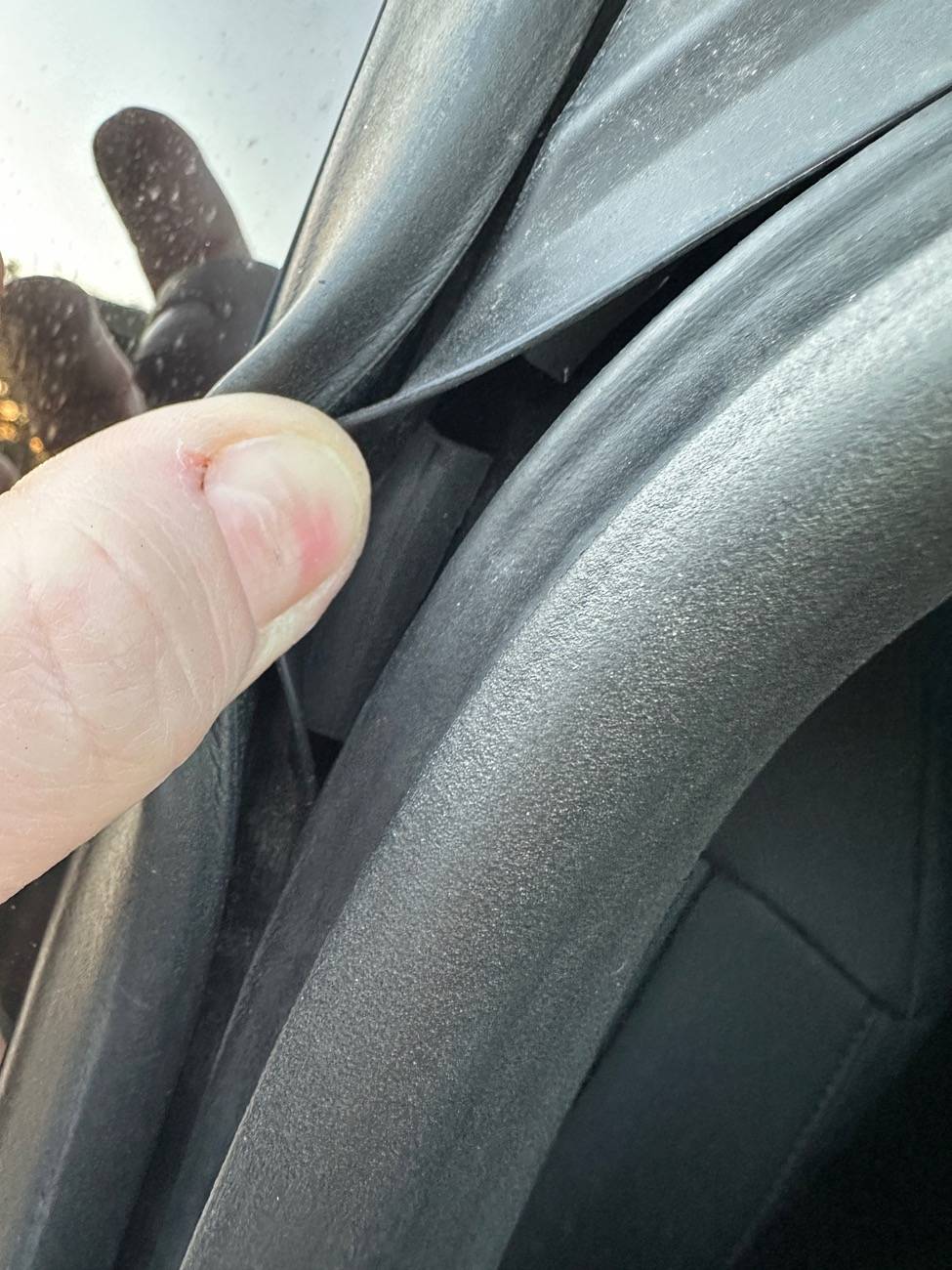

This also explains why it wasn’t immediately obvious what the service center did to my truck and why I still hear some air. It looks like they put adhesive foam rubber behind the seals.
Yes, that does make sense and you definitely need to use the product that I linked above because it’s designed specifically for this.
Now that I have this fixed I think I’ll take it off my service ticket for Monday because it’s possible they could move me a few steps backwards and get air leaks again now that I have it resolved.
Also the more I look at your picture, they put it in the wrong location under the wrong window gasket .
Your picture appears to show they put it under that front corner gasket and only in one section.
I could see why they attempted that because mine looked like it was going inward a little bit, causing a leak in that sections, but if you put the foam rod down the entire length like I did in my picture it actually resolves the issue.
When this leak occurs, it initially appears that the top left corner of the window is where it’s leaking, but actually it is also all along the bottom in middle of the front of the window gasket too. One foam rod from top to bottom resolved it.
I hope this helps!
