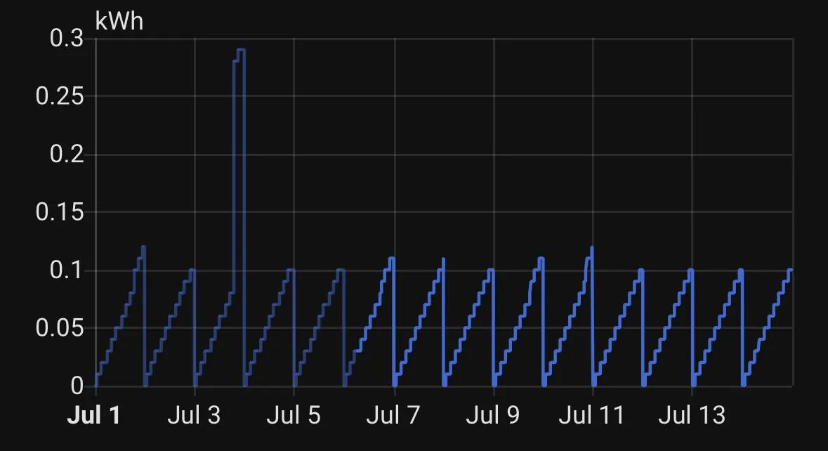

I have an eGauge power meter monitoring the circuit for the UWC. There is a constant four watt draw while idle which adds up to 96 watt hours a day.
Here is a graph of daily energy consumption during the two weeks:
Looks like it sat idle for all but one night. I was expecting the truck to draw more shore powder to save battery consumption.

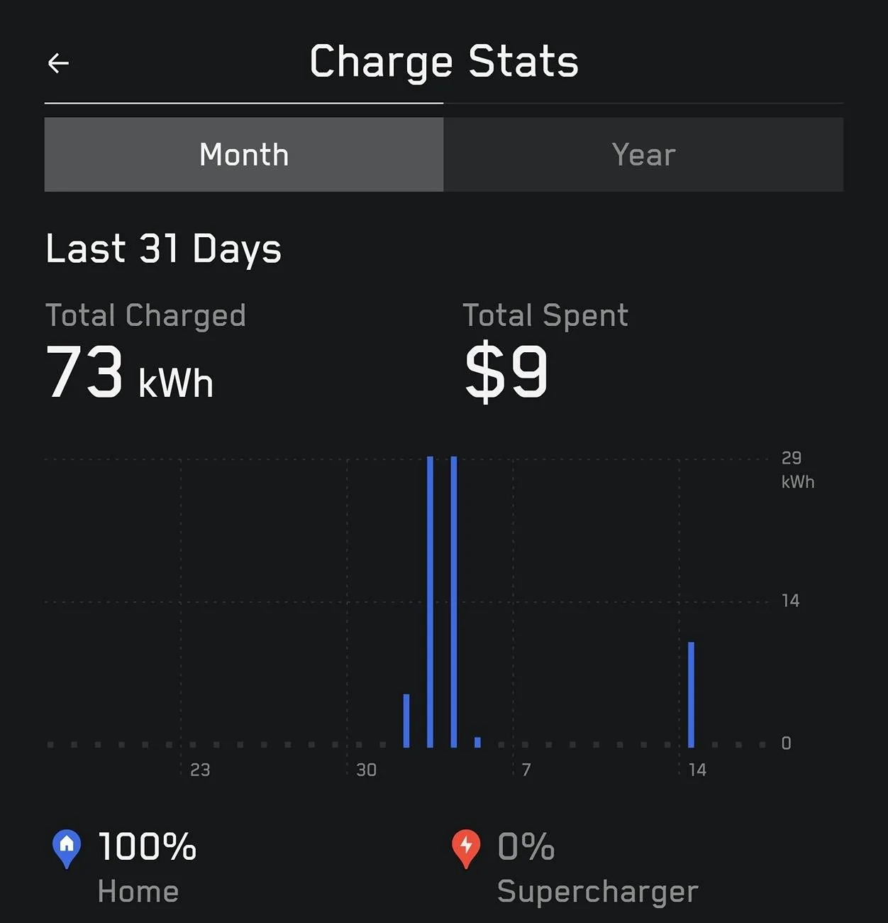

I've been on vacation since May 31st. I've had three software updates since we left. I noticed about 2.8 Miles a day lost. We got down almost 100 miles and had one of our children plug it in. Here's the charging it did so far on its own. We left with 260 miles range (80% charge). No sentry or climate settings on. These suckers lose alot of charge just sitting!

I got home today from a two week vacation. My truck was at 80% when I left and I turned the charge limit down to 50% so it wouldn’t charge while I was gone. It was at 70% today.
