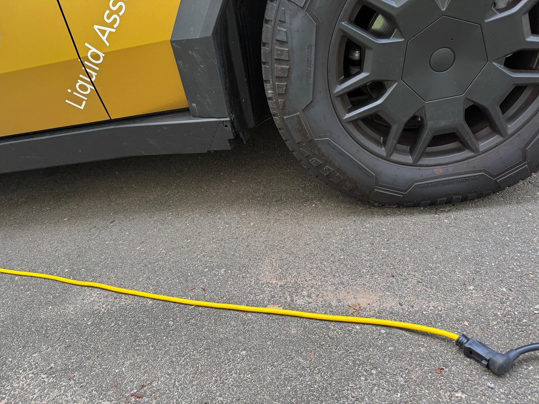

Has anyone else experienced this? I was walking by my truck the other day and something looked off by the wheel base and I realized the mud flap completely fell off. Has this happened to anyone/does anyone know what the process is to repair it? How much will Tesla charge me?

Main part is $40, but you'll also need the fasteners. Can order via an 'other' service request if you want to DIY.
Part numbers: https://epc.tesla.com/en-US/catalog...emGroups/af5c7f97-21f1-4318-937a-169dd30c8e8c
Process (note you don't need to fully remove fenders in step 1): https://service.tesla.com/docs/Cybe...UID-D0420707-8D36-4266-9B2A-4B636FBA962E.html

Thanks I might do this. Frustrating that when I was in for servicing last week nobody there was able to give me any direction.

I just can’t stop seeing “liquid ass” in the photo… ?

Mine didn’t fall off, but an unavoidable bit of tire debris at highway speeds had both front and back passenger side guards/flaps dangling when i had a chance to inspect at the next charging station. Frustrating but seems infinitely fixable. Service appointment next month for a few other minor things, so added this one.

Mine came mostly off. Tesla is charging me $15 for the part.
