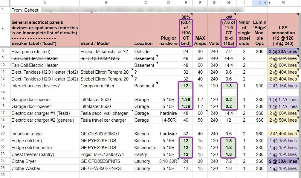

A) Of course, that assume you would use all your electrical appliances the same as you "normally" would and I would guess people would go into "conserve" mode. A
Ford figures 13 kWh/day apparently in this PDF overview. I think their (Ford's) ads all say 3 days IIRC. I just found their FAQ (link)which says 3 days and 30 kWh/day.
Tesla Cybertruck Munro: Tesla Cybertruck Technical Specs DEEP DIVE with 5 Tesla Executives 05OfXg4
B) I was looking at this stuff just yesterday with the question of what could I run on 11.5 kW (Ford is 19.2 kW). My below didn't account for lighting (garage, kitchen, bedroom...).
Tesla Cybertruck Munro: Tesla Cybertruck Technical Specs DEEP DIVE with 5 Tesla Executives Sj7ajpY
