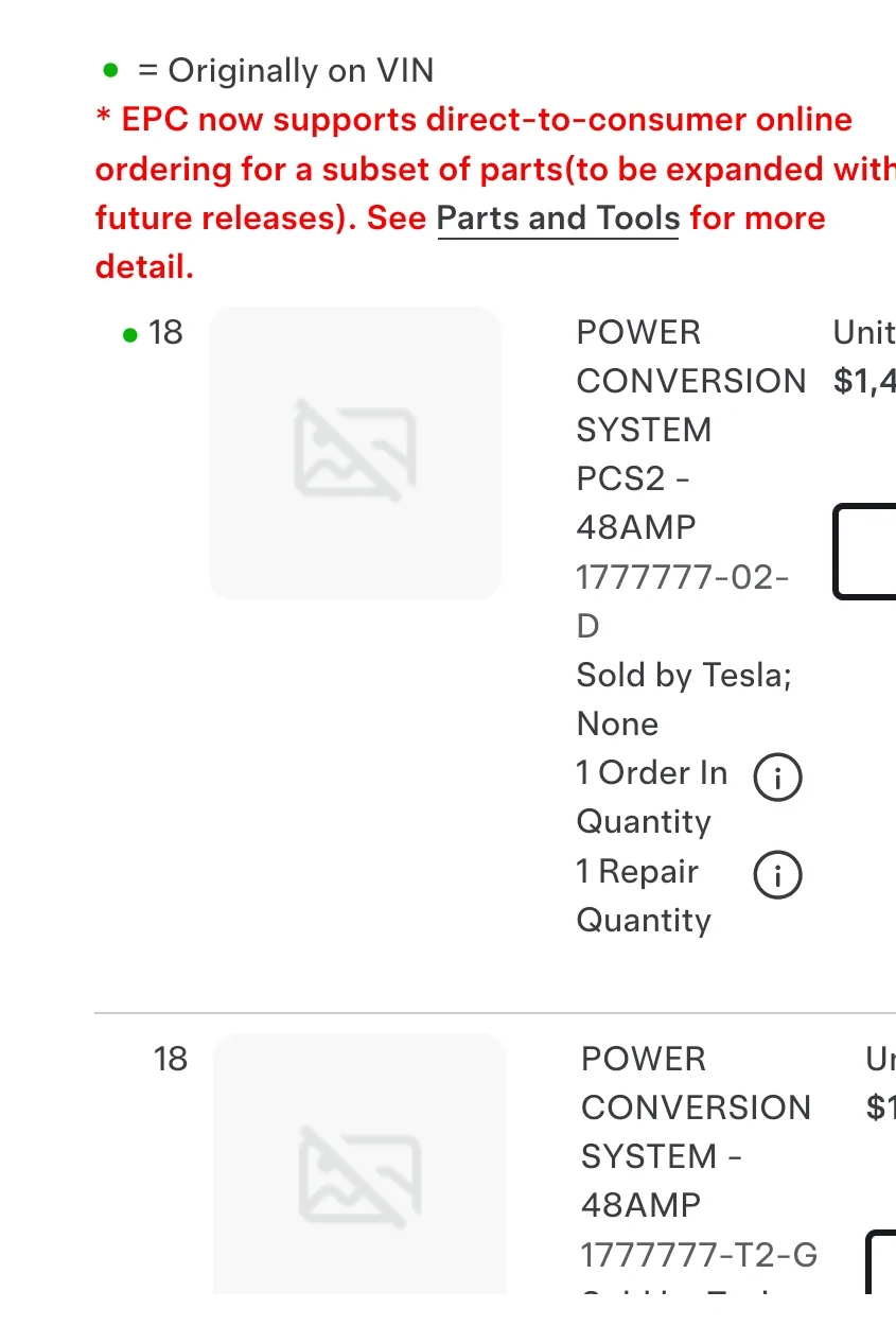

The. PCS failure seems to be a major defect in design, any way to check what version is currently in a vehicle?
If you go to the Tesla parts website, click catalog, put in your VIN, and look up Power Conversion System, it shows you the currently installed version along with the newest.
epc.tesla.com
I have -D (for dying? )

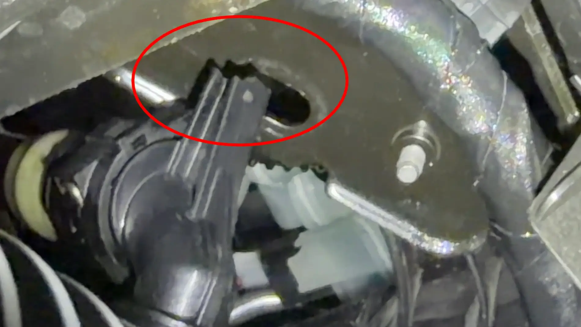

That's basically why I opted for a buy back. On the 4th visit, they replaced the motor. Found a few signs that they were not careful with disassemble/reassemble, but this is the one 'that broke the camels back.'

Now the hose bangs around at freeway speeds, and the motor still makes noise.

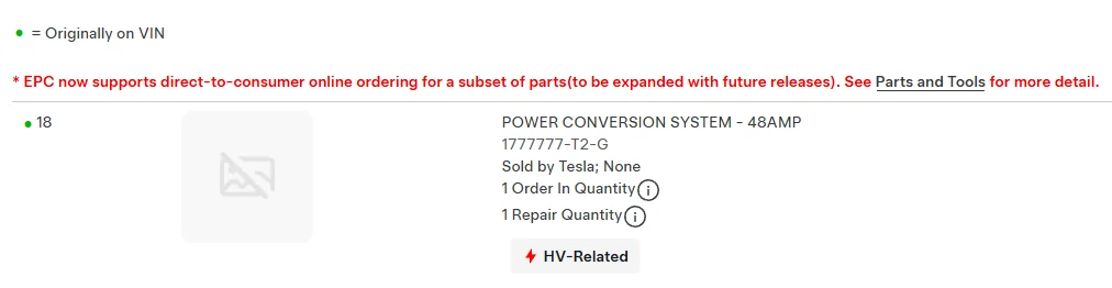

Thanks @mongo, I can sleep a little easier.
For reference, AWD 2025 CT, VIN 80XXX, Build August 2025, Delivery September 2025

Funny, the EPC says “hv related” but they argue its not part of the hv system, but the MV system, and therefore not covered by the 150k/8 year hv batter/drive train warranty.

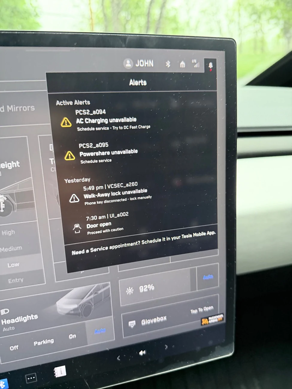

Add me to the list. I just got the PCS2 error and this will be my second PCS replacement. I had an HV_BATT error early on in ownership in May of 2024. Which requires replacement of that component along with the Battery. 😞
