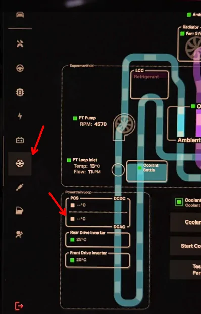

Also noticed my PCS2 was reporting temps of over 99C at 48A, dropped the charging down to 32A and it hovered arround 70-78C, then at 24A it was 50-55C
Has anyone else seen this? Buddys truck reports no data...Were thinking its on its last legs now.

linuxdrake, how do you find this real time flow diagram?
