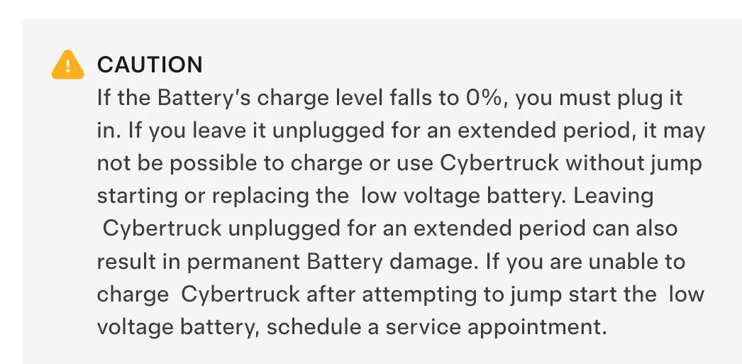

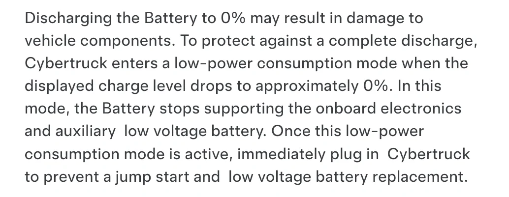

Makes me nervous to check the work thats been done on my truck…. Im in the same boat, my truck has spent 45 business days in service in 13 months. Ive had a myriad of issues, this is my second truck… knock on wood things are pretty stable right now (for about 3 weeks i haven't had an issue) my last issue, my power steering ecu didnt pay its internet bill and was cut off from the rest of the truck for some reason… they dont know why it happened but they flashed the module and it seemed to reset fine… they just let my battery drain to 0% SOC and left it there for around 24 hours while i begged them to plug it in and not let it sit like that overnight and pointed out that the owners manual specifically says NEVER allow the battery to get to a 0% SOC… They downplayed my concerns until i sent an email to the regional manager and they got it plugged in the next morning. im also on a rev E pcs (first failed 4/2025) so im biting my nails waiting for that to fail i always charge at 48a at home so ill notice it as soon as it happens.
I understand the discomfort, to clarify things a little:
The warning is to not let your vehicle fully discharge. That is, or at least should be, different than 0% SOC. Service can see what buffer the pack still has available.
If can connect to your vehicle with the app, the HV battery hasn't hit its undercharge limit. The problems occur if the HV pack self protects which results in the MV battery discharging which unpowers everything.

I get that, but the customer facing side of the issue is oh hmm my $80k vehicle is draining the battery while it sits there untouched in the sc’s care, Let me ask them nicely over a period of a week to plug it in since i dont even typically let it go below 20%… “we will plug it in right away”… days go by… oh wow now it says 0% and they still haven't plugged it in! “Dont worry we will get it on a charger now” shop closes…it just doesnt make you feel like they are actually taking care of your car, and as the poster above described, how am i supposed to trust that they are carefully disassembling and reassembling the fragile plastic components without hidden damage if they cant even plug the damn thing in when asked before it reaches displayed 0?
May 27, 2024
4,723
5,766
I get that, and a week of unfulfilled charge requests would try anyone's nerves.
Was other work done on the truck, or were they just holding it after the reflash to make sure it stuck? If they had it partly disassembled, their procedures may not allow charging (or unattended charging). Even if that were the case, feedback would be much better than silence/ ignored.
My point was that, never hit 0% isn't what the owner's manual calls out and could mislead other readers.
It was sitting in the parking lot. The vehicle stopped communicating with the app about 24 hours before they plugged it in, and again, only when i escalated to management.
re: “never hit 0”- i understand what youre describing you are correct that it does not say “never allow the battery to hit 0%” verbatim, but it is pretty clear that doing so is not great for the hv battery and stresses it unnecessarily. i also understand that there is a buffer. I also understand that the risk of permanent damage to the HV and MV components is low, however, it also specifically says damage due to discharge related events is not covered by warranty. My point was that they have a duty of care while the vehicle is in their custody. This specifically shows one or more of 1. Apathy 2. Willful Neglect, 3. Arrogance 4. Poor communication and customer service and worse than those: 5. Incompetence.
Oh, if the truck stopped talking, that is definitely poor oversight on their part regardless of if you called them.
Right, "zero percent" does NOT mean "zero volts". There's still dangerous levels of voltage in the pack at 0%, just not enough to operate the vehicle.
The pack can probably sit at 0% for weeks or months, since the only voltage drop will be from self-discharge. But if the voltage actually hits zero, the cells will be damaged and the pack will need to be replaced. Ouch.
So, hitting 0% is not great, and the pack needs charging "soon" but it's not a fatal condition.
