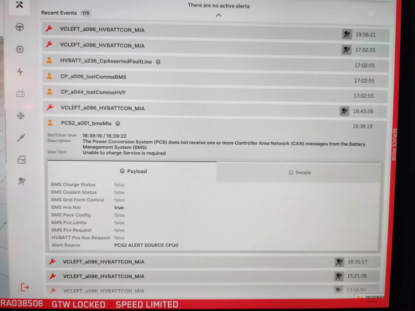

Anyone know if im about to get a badge and its my turn? Is this the precursor to it failing completely? Last time I checked it was charging at 40A.

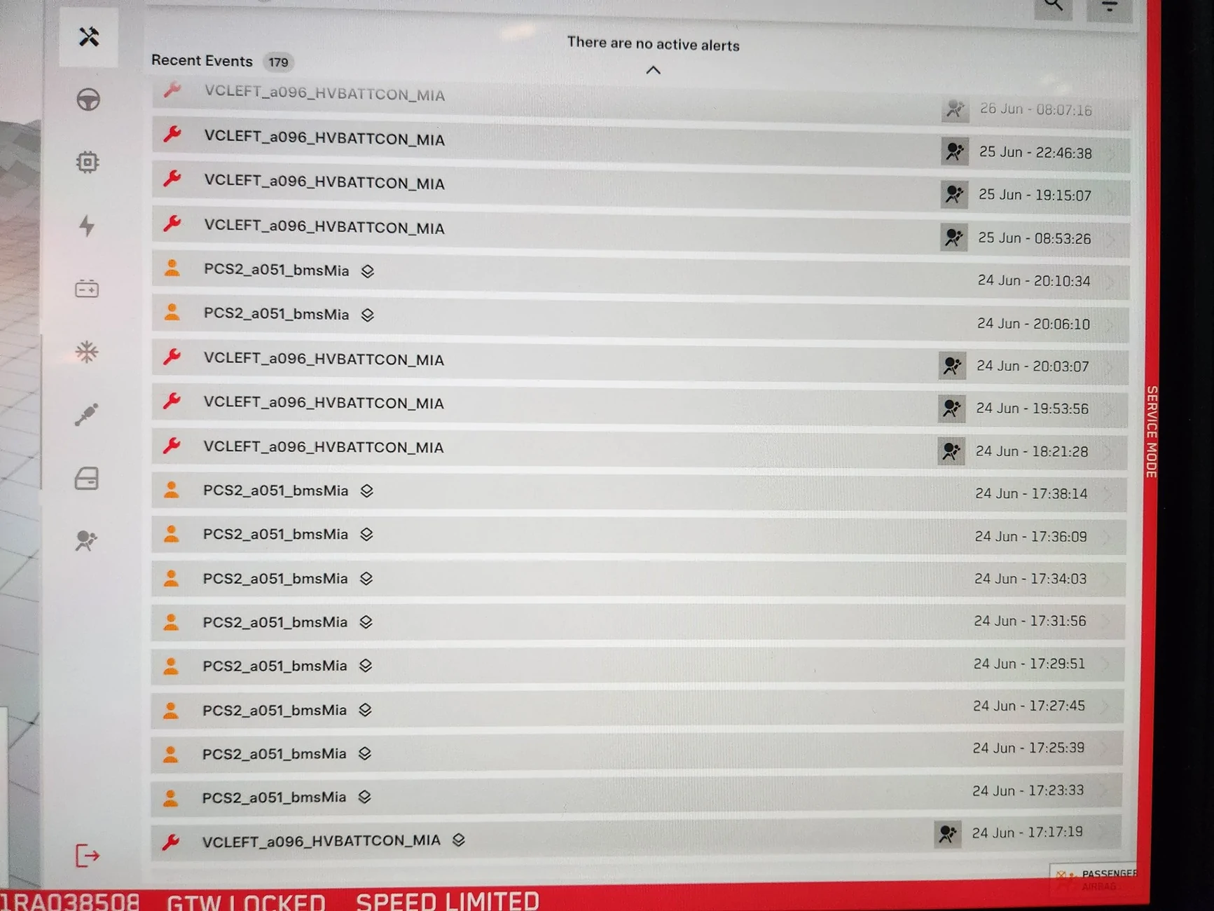

For me the a051 error was a temp irrational error, but that showed up several days before my charging was reduced to 24A. In the meantime I've been charging at 12A, hoping that the remaining half of the PCS can handle the reduced load. Free supercharging doesn't do much for me, there aren't superchargers anywhere I would go day to day. So it would just be wasting 75 minutes every few days to charge back to 80% (special trip to and from the supercharger plus waiting for it to charge)
So is this something I need to make a service appointment for or I have to wait until it fails completely?
they won't do anything until your pcs fails a health check (mine shows a127 and a136 failed health checks). At that time your charging will be reduced to 24A. YMMV but that was my experience
Thanks for the heads up - I'll have to keep an eye on it now because if it goes the way yours did then it's a sooner than later it seems.
I keep posting about it because there was only a single mention of the a051 error on the whole internet relating to the pcs failure, so I'm hoping by putting it out there in more posts some people will know what's happening sooner than I did.
That's why I came on here to ask actually. I tried looking it up before but didnt find much, so I wasn't sure if its just nothing, a precursor to it failing or if I need to make an appt now since they are months out on them.
