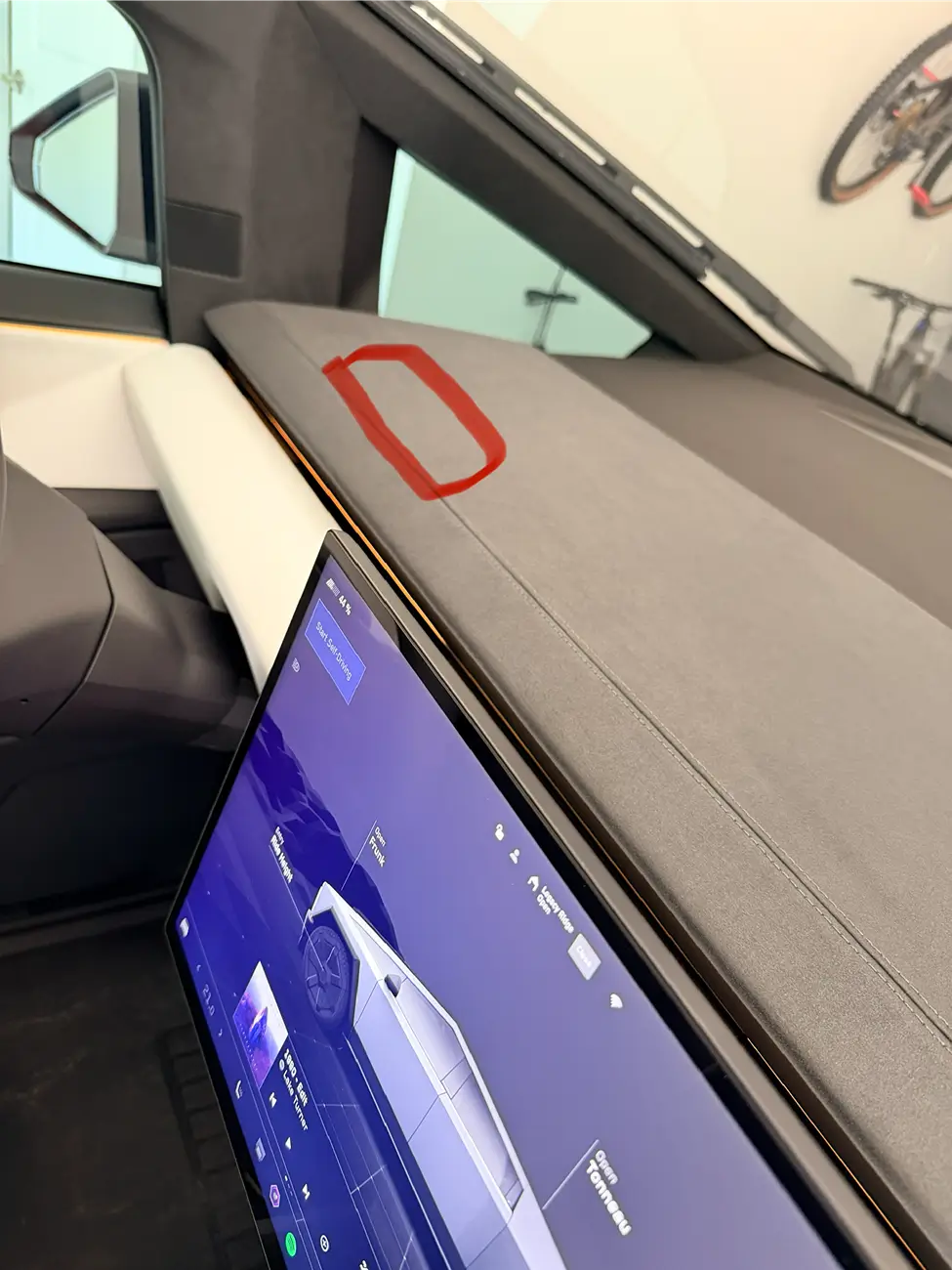

So lately Ive been taking care of some rattles on my Cybertruck, only one remaining is a very prominent one, its a rattle inside the dash pad (verified many times), If I press on it dissapears, and if you hit it with your fingers firmly it will rattle right at the circled spot.
Tesla Cybertruck Need to fix Dash Rattle, most CT's should have it... tempImageBYgV49
Any ideas how to fix it? all CT's that Ive driven has it.

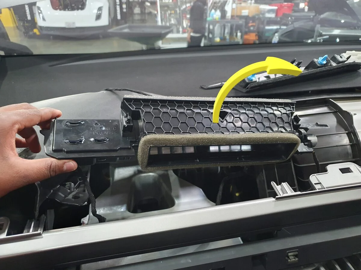

That is the location of the Airwave Module:
Tesla Cybertruck Need to fix Dash Rattle, most CT's should have it... GUID-5DB01A3A-17C9-4411-A846-529151540322-online-en-US
I'm guessing that any noise is coming from the module itself, which has multiple moving parts.
If you peer into the vent, you can see the louvers move when you adjust the airflow direction. But accessing the module requires significant disassembly.
Mine will sometimes get stuck, which is remedied by a solid whack on the spot you've identified. (Yes, I did open a ticket, and of course it worked perfectly while at the service center, sigh.)

That appears to be it… wondering if pulling on one side would work to access…

Had the same issue on my 26 AWD. Service center replaced both airwave modules to resolve it. The process is rather extensive to do it and they damaged a few things which required a second visit.
