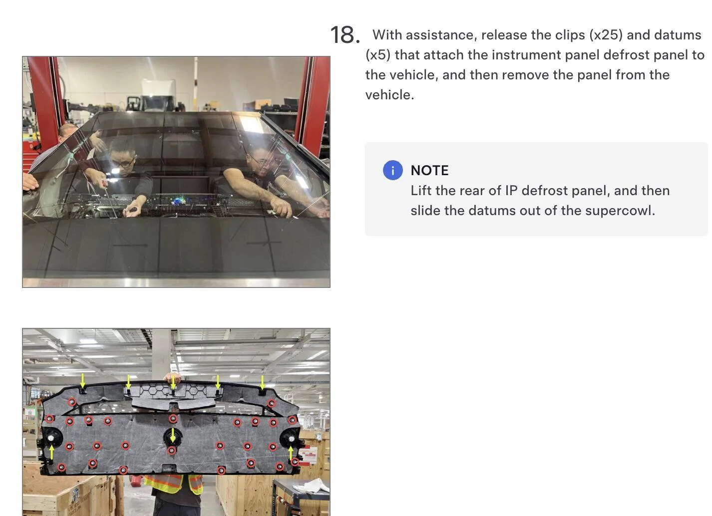

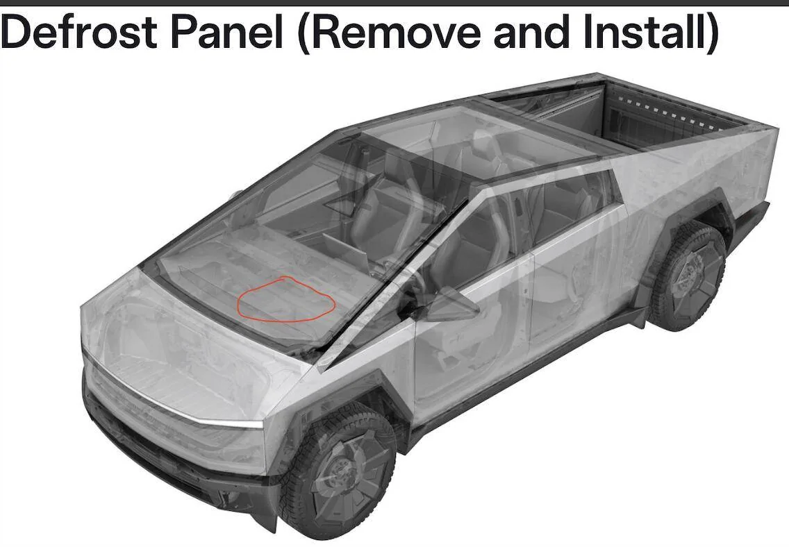

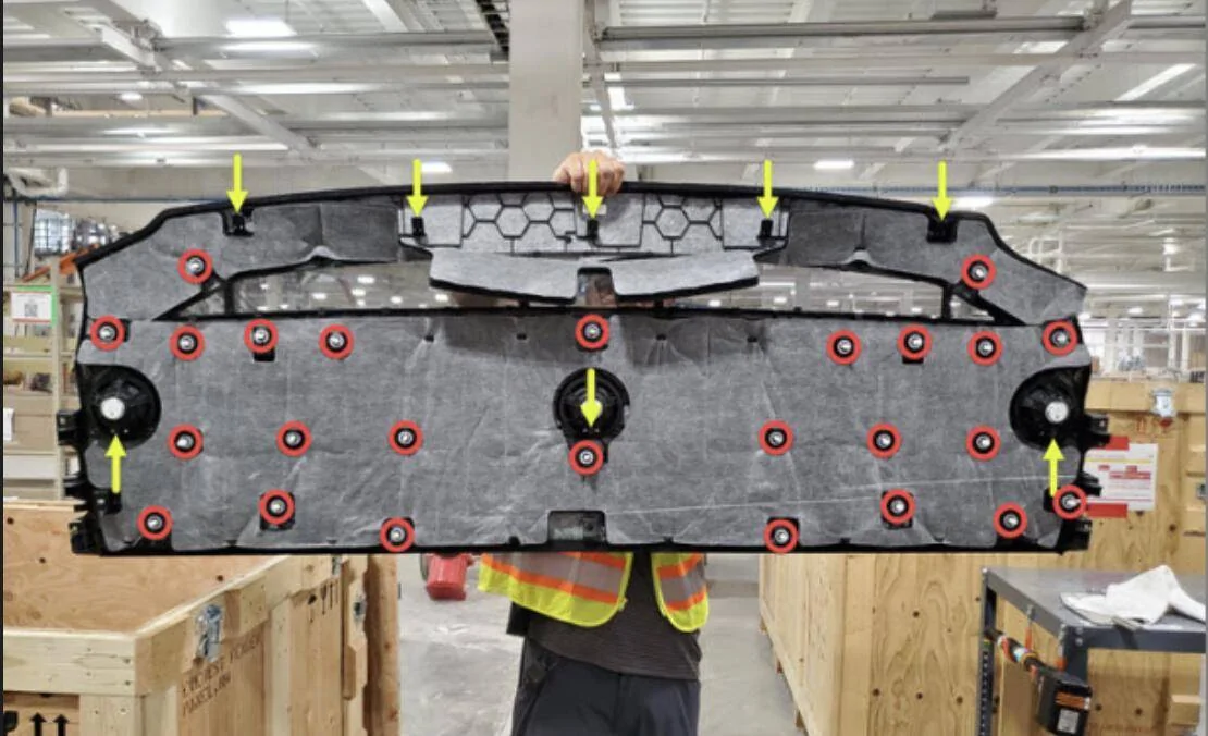

On the defrost panel, there are tons of clips, and while driving, I can place my hand over this area I circled in red and it'll stop rattling. I suspect a loose clip. I'm also tempted to pop up some of the front clips and put some more sound dampening material in there. Not sure if I want to attempt yet. Mine is a minor rattle.

It doesn’t. The docs tell you to remove items in series so the other parts don’t break. It also requires to remove the airbag, which is something I would rather have the SC do.

The dash does not, has screws, nuts, etc., but the defrost panel does snap off and you can reach it. I can reach it and use a pry tool.
