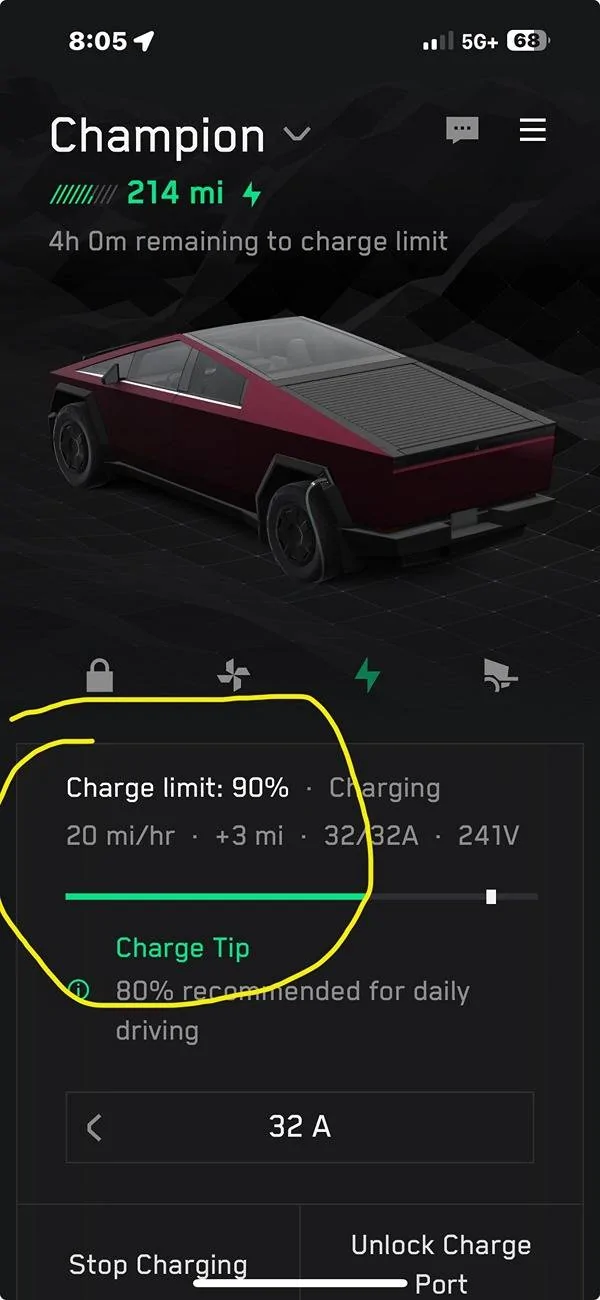

Just to follow up on the OP question.
The first hint is that they are showing pictures of the screen, which means the truck isn't asleep.
And then add that the climate control would be on.
And then determine if the battery is conditioning itself because of severe cold.
If you want faster charge rates, leave the vehicle alone, don't look at it with the app, make sure that Sentry is turned off and let it fall into a deep sleep.

Tesla Cybertruck Nema 14-50 charge rate. CT_Charging_at_RV-Park_with_portable_charger
Woodrick
Ed
Dec 30, 2023
4,786
4,762
Gainesville Ga
Consultant
It's true that some parks have outdated wiring or bad breakers. But for the past week, we've been getting consistent results at this C. Florida park. Maybe you can look around for a spot closer to the "main load" panel. Each "stand" or RV outlet has a main panel usually closer to the main road. The shortest the distance to it will have better results on older wiring. Also, after years of RV'ers plugging IN/OUT burnt spark particle of carbon form on the contacts inside the outlet side. Creating resistance (heat) that will degrade your quality of line voltage. Your CT and chargers are smart enough to filter out tensions that can cause harm. Downside is what your're getting.
You circled a portion of the screen shot as if that is an important section, it isn't. The important section is actually to the right of that, the 32/32A and 241V.
The 32/32A indicates that the mobile connector is rated at 32A and that you are running at max capacity, the second 32A.
The 241V indicates that the voltage is at expected levels. With 240V being a common home level. Some commercial sites may only be 208V, which is a correct number, but will represent a slower charge.
You generally want to watch the voltage from the time you first plug in for the first couple of minutes. As the vehicle starts charging, it ramps the current up and the voltage should stay nearly the same, maybe only a few volts difference. If it drops by more than a few volts, then there is indication of wiring issues. And the vehicle should start reducing the charging current to something like 20/32A.
