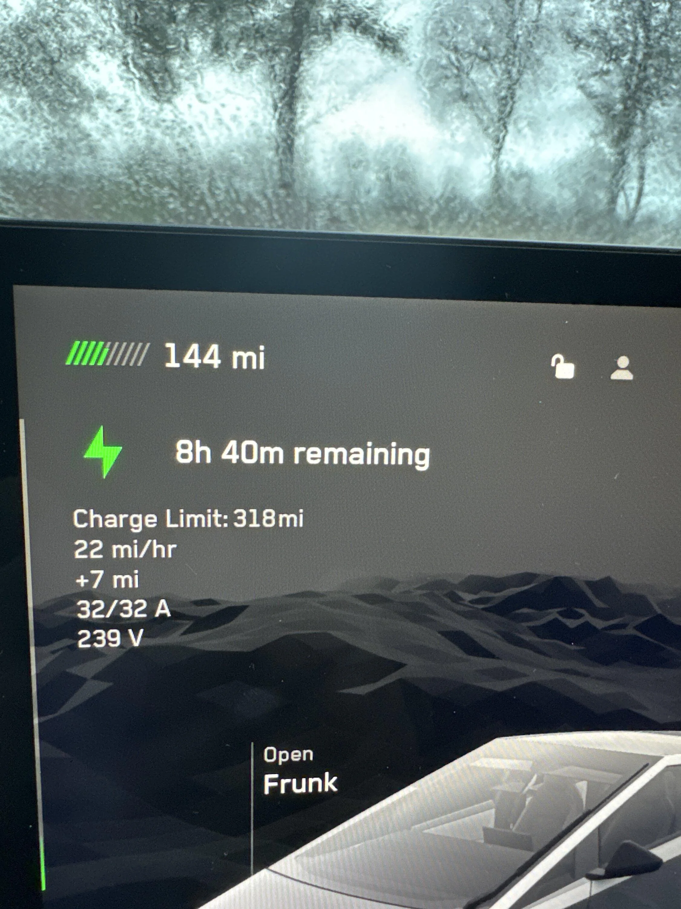

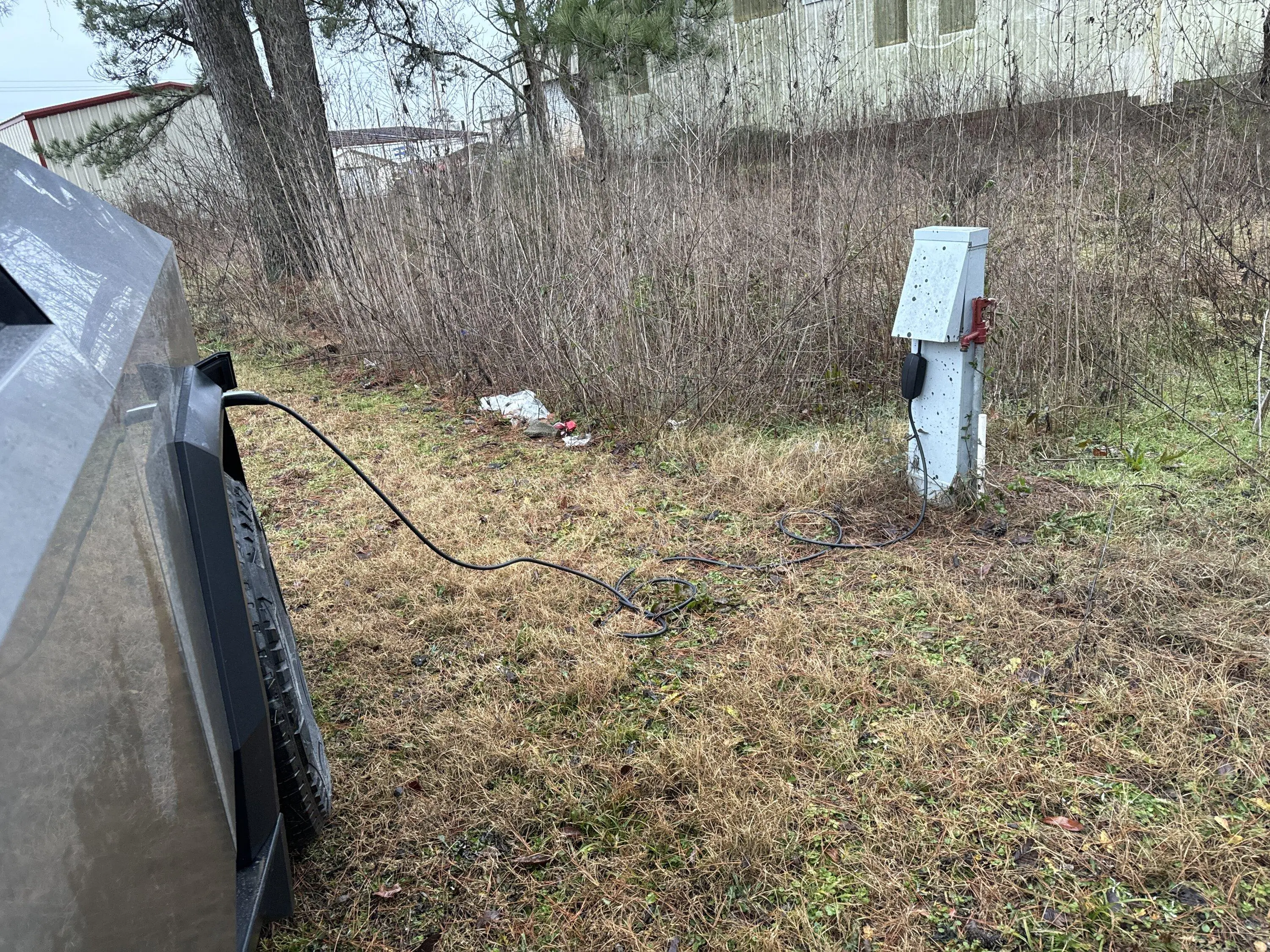

Traveled to Oklahoma first day I got it. No chargers here. However there is an RV park on the south side of town that’s listed on PlugShare for having rates to use mobile charger in the back.
Talked to the nice lady at the front desk, pulled around back, plugged in and started charging.

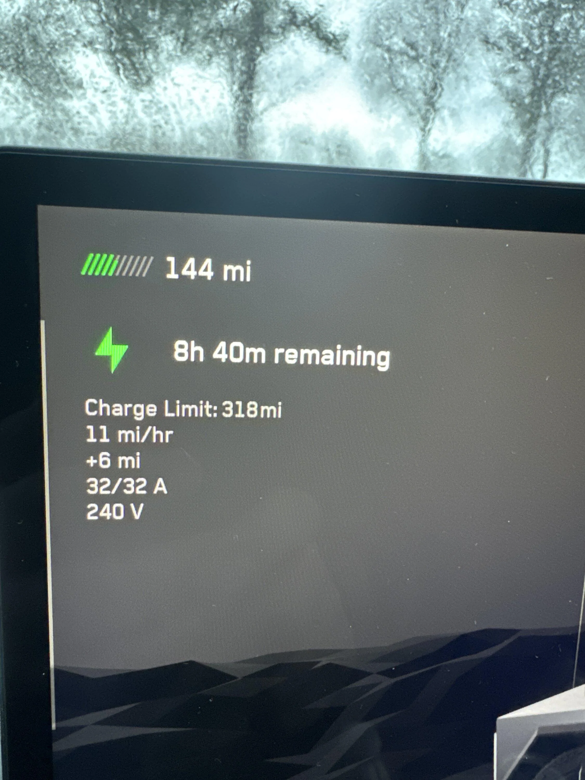

Bad part of the experience is that the charge rate on this is being inconsistent.
bouncing from 25mi/hr- 11mi/hr charge rate.
5.5 hours to charge from 40%-80%
9 hours 40%-100%
This is my first electric vehicle. Is it common to have the charge rate not sit at a consistent level?
From my experience with other Teslas, it will sometimes start out low and climb but usually stay stable (if the power source itself is stable).
You were at an RV park, so it's uncertain how stable their power was. Your current/power variations were likely not caused by the Cybertruck.
Your screen was showing 32 amps. For a NEMA 50 outlet or 50 amp circuit, you could normally get up to 40 amps out of it if a destination charger wall connector was on it. But since you were using the UMC adapter with an outlet it limits the current to 32 amps max.

It’s the RV park wiring.
Lev 2 charge rates don’t fluctuate that much, even with a ~40° battery. It’s in DCfast charging situations that the car will use lower power to pre-heat the battery, bring it up to temp, before allowing full power.
I’ve used a lot of RV parks due to towing a 19’ FG camper (with an MX100D) across the country, throughout the Rockies, desert southwest. Coincidentally, I got stuck in OK for 30 hours because the RV park I had planned to stop overnight on I-40 didn’t have any functional 240V receptacles, had to charge at 120V forever. I have every adapter in the frunk

In both photos, the on-screen display shows a 32A charge. That seems consistent.
The difference is in the "miles per hour", which is not a measurement but a calculation based on the rate of charge and the expected Wh/mile efficiency.
I would speculate that the BMS is still calibrating, and/or is using sloppy mathematics that cause the number to jump around instead of using a smoother averaging technique.
Haven't you ever downloaded something with a consistent speed, yet it would jump all over the place with "X minutes remaining" that was never right? :LOL:
The first part about the 32 amps in both pictures is correct and indicates that there is no issue with the power at the site.
But the fluctuation in the miles/hour being added is much more likely due to power being consumed by climate control and/or battery conditioning than a bms issue. The amps displayed is what is coming into the truck from the charger, the miles displayed is the net going into the battery.
