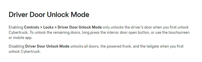

I have my phone as the key for my beast, but sometimes when I walk up to truck it won't allow driver door to be unlocked...other times it will, but not passenger side , should it allow both sides to unlock? also is there a way to unlock the passenger door from in the truck? thank you

Make sure you have driver door unlock mode disabled:
Tesla Cybertruck New to Tesla's Phone as Key 1725066055082-qm

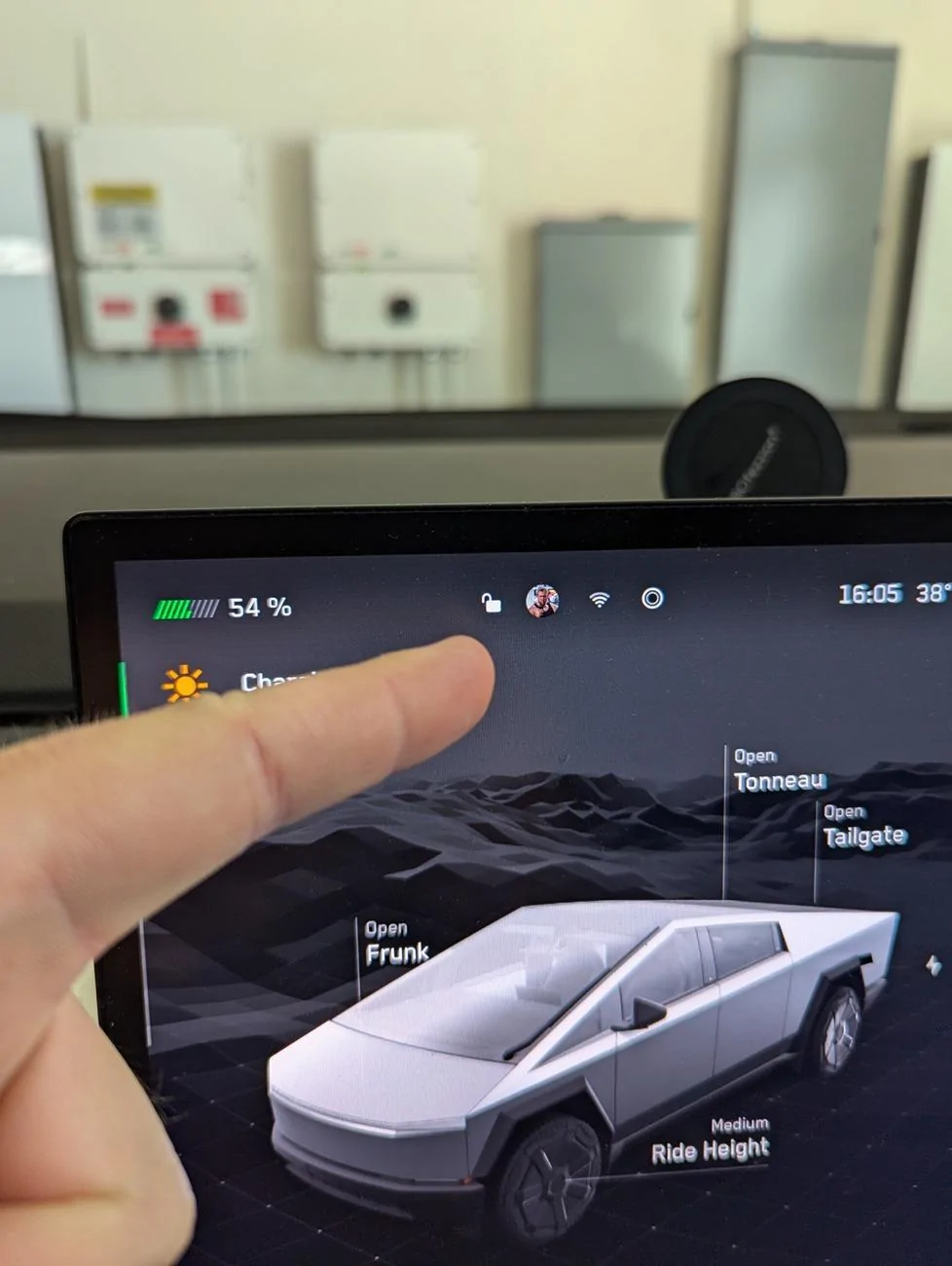

To unlock from inside the truck, just tap the lock icon on the screen.
Tesla Cybertruck New to Tesla's Phone as Key PXL_20240721_230533176
