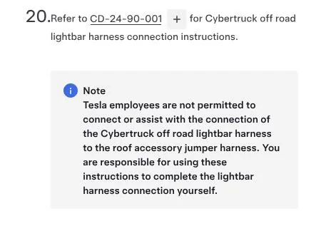

In case anyone would like a refresher:
Lightbar Installation
Tesla Cybertruck Offroad Lightbar Installation at Service Center Tomorrow (Update: Delayed Due to Wrong Part) 1726234567444-zx

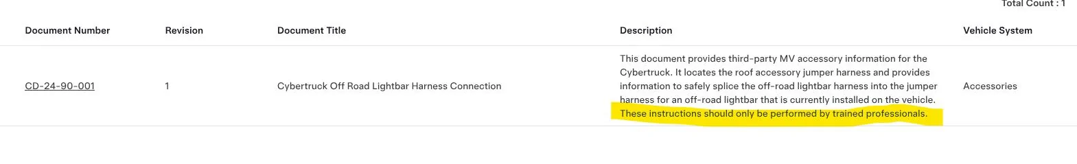

But then,
Tesla Cybertruck Offroad Lightbar Installation at Service Center Tomorrow (Update: Delayed Due to Wrong Part) 1726234929756-bh
I've read through the installation guide. I'll break it down simply:
1. It's glued to the windshield.
2. Blackout tape covers the light so Tesla has a single process they can use in all states where it's illegal to have a light that high above the ground (looking at you, Maryland)
3. Tesla routes the electrical into the truck and buttons up everything outside.
4. Tesla enables the light in the center screen.
5. The owner will have to plug in the single 48v connector at the B (?) pillar to enable the light to be turned on. It's also more complicated than just plugging in the connector. here's what's involved:
5a. Turn vehicle off.
5b. Disconnect first responder cut loop electrical connector under hood beneath the rear under hood apron.
5c. Disconnect eCPA on the MV battery connector (near the other connector)
5d. Wait 2 minutes.
5e. connect lightbar.
5f. reconnect 48v.
5g. power up the Cybertruck.
