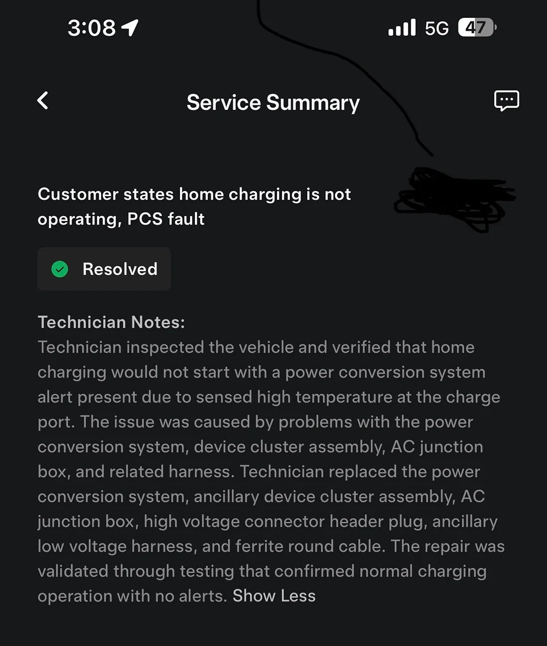

Finally had to go in and change my answers. But, glad to have it behind me. If your PCS has failed, please add your data to the mix … on all three polls please.
SCTesla
Jun 11, 2024
2,528
3,749
22 Model S, 24 CT
Just wait for your second failure, lol. Those numbers are growing as well.

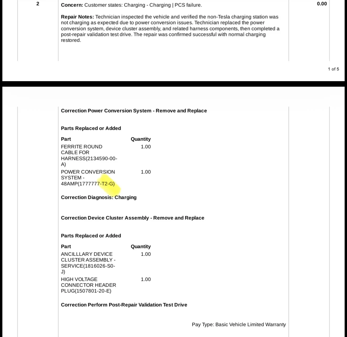

Well, I did get the G variant! Hopefully, they don’t have to use the whole alphabet to get this right! 😖
