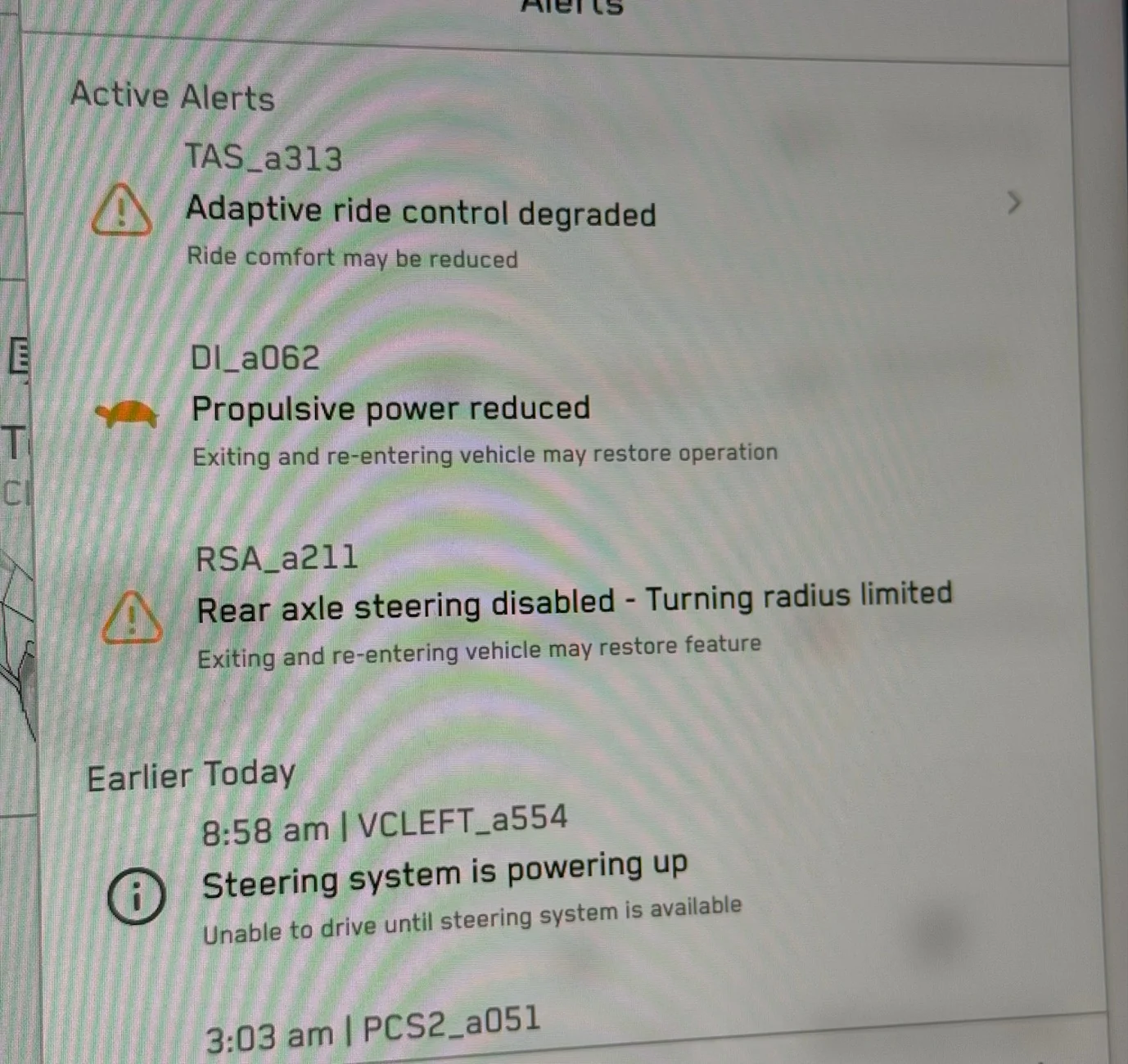

I wonder if they will fix my PCS early, or if I will still have to wait to mid August. Need to get it towed in because I got the rear axle steering disabled (RSA_a211), power reduced (DI_a062), and a couple others with the 'drive at your own risk' alerts this morning

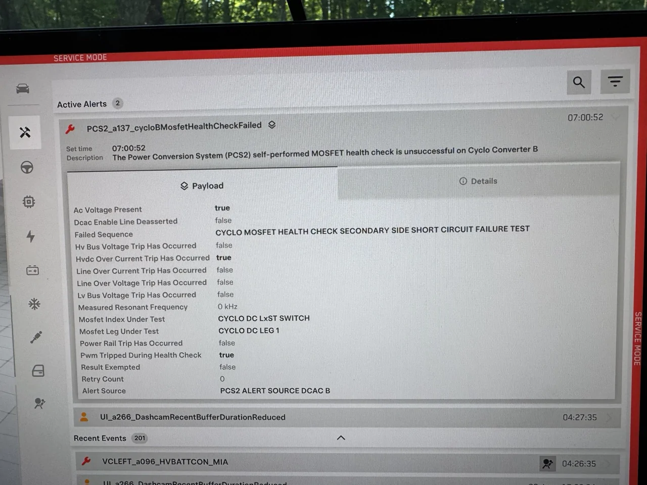

It is, indeed, just a matter of time. There's a reason the PCS2 issue is the longest and most persistent topic among Cybertruck owners.
My number came up yesterday morning, while bumping my usual charge level for a couple-hundred mile trip to visit family. No indication at all either in the normal vehicle user interface or in the smartphone app. But the sudden reduction in charging from 32-amps to 24-amps was the dead giveaway. A quick walk out to the truck and a trip into Service Mode confirmed it.
Tesla Cybertruck PCS failure rates by year...is it just a matter of time? PCS2_a137_Error1 Larg
I bailed on my favorite vehicle and took the Model 3 instead.
This morning, going into the app to schedule what I figured would be a quite-awhile wait for a service appointment, I find that I've already been given free Supercharging (so apparently the Cybertruck is self-reporting PCS2 failures back to the mother ship).
The more interesting thing is that I already had a minor service already scheduled for nine days from now (replace HEPA filter and windshield wiper). The PCS2 replacement was already added to that appointment. If they do, in fact, effect the PCS repair during that visit it would suggest that PCS2 parts availability is finally easing.
