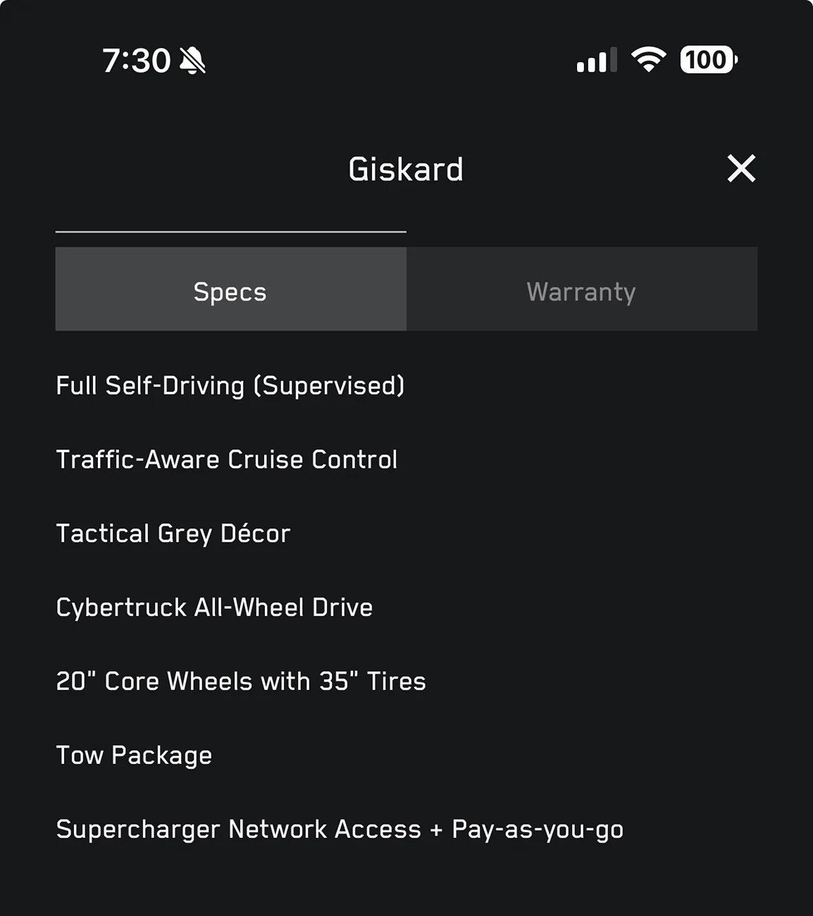

do we only get the update if out pcs starts to fail?
rlac
Rick
Sep 18, 2024
Go to specs and warranty and see if you have free supercharging until July.

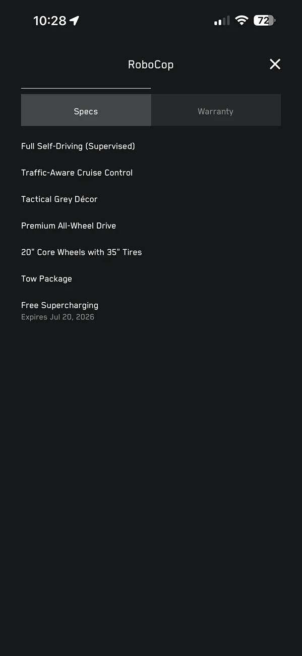

Tesla added free supercharging to my truck until July 20th.
Due to the PCS2 failure
Is yours a newer model, and it’s had a PCS failure? I noticed yours is called a premium all wheel drive. Mine is called Cybertruck all wheel drive.
Tesla Cybertruck NEW PCS (Power Conversion System) Failure & Replacement News IMG_3092
sounds like these are dropping like flies hope mine goes while still under warranty! No known issues yet vin 43xxx, 26k miles
66k March 2025
