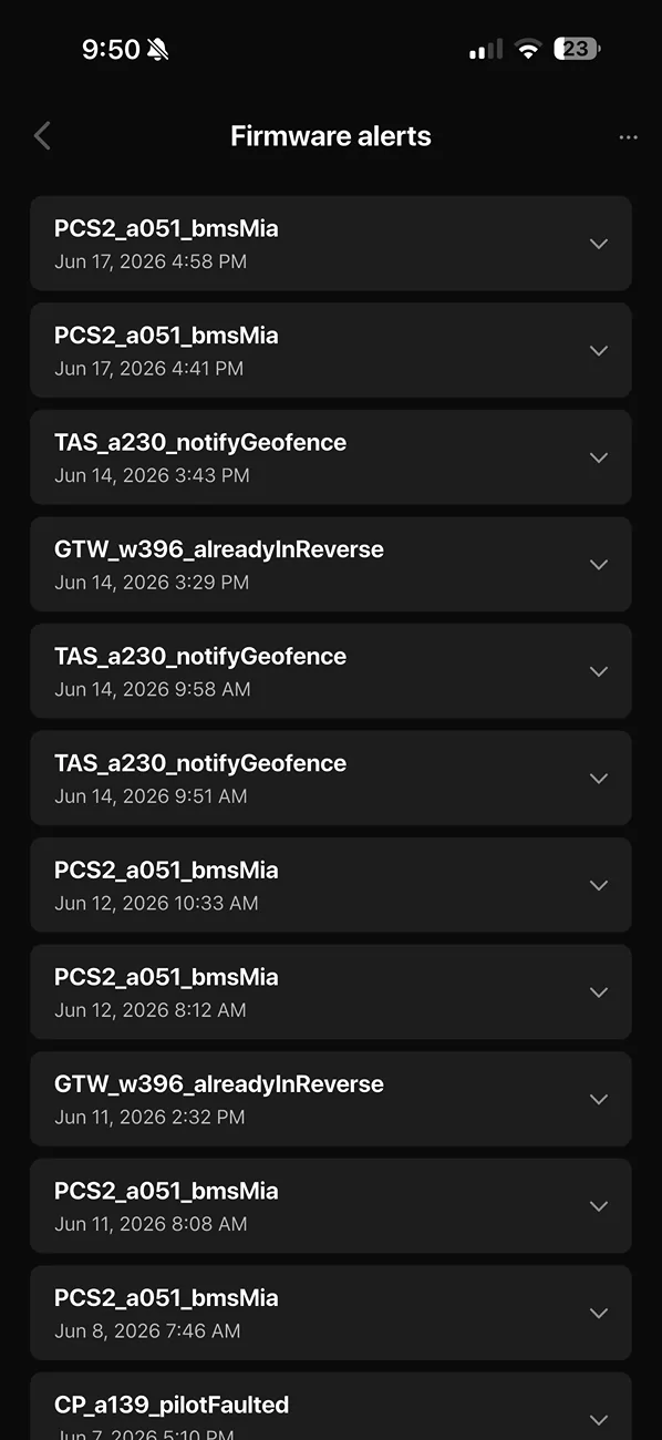

I recently had my PCS replaced a few months ago. Had another PCS2_a051 warning come up, but no noticeable charge difference. Anybody have this issue and had to get another PCS?

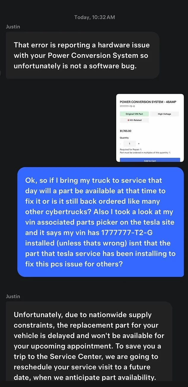

Check your invoice and see what rev they put in it last time. I hear the G version is the good one.

Maybe. I was told they are working on a new revision which has an expected August release. They are making me wait for it.

I’ve had the same alert twice pop up in May. My truck was plugged in, but not charging. Both times it went away on its own. My PCS was replaced with Rev F in December.
I’ve also noticed an AC hum when charging. I have a service appointment on the 17th to take a look.
