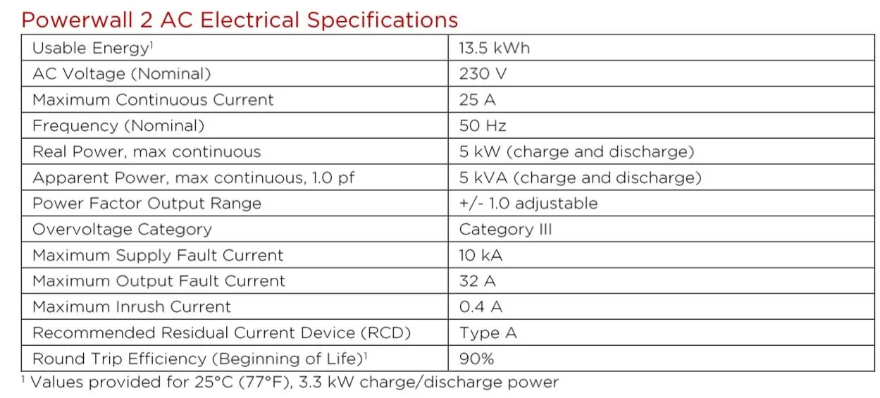

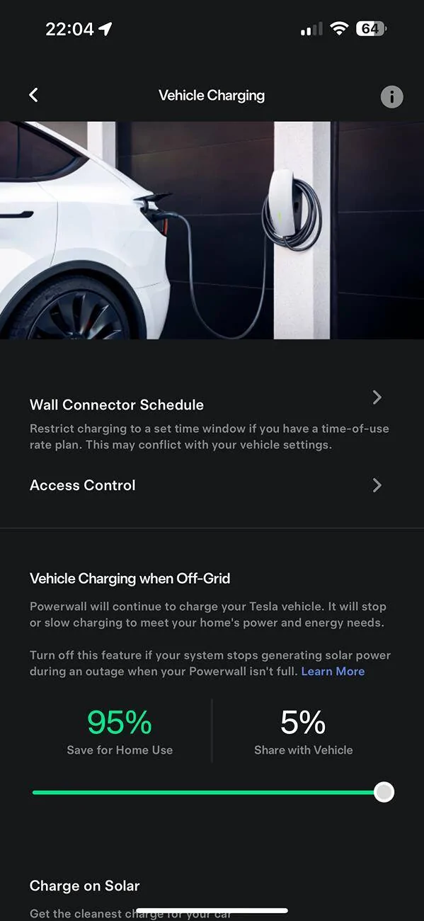

Two Powerwalls will not have enough continuous juice to charge an EV and power the home. Each Powerwall can sustain 5kW. When the grid goes down the inverters have to wait or cycle for about 240 seconds before they kick in again. If you have good sun and wait for them to kick out power again you might be able to charge while the grid is down. You can also limit how much of the Powerwalls you want available for EV charging. I set mine to only allow 5%

If you were running fully off the powerwalls, and they were powerwall 2s...that's enough to overload them. Turn down your charge current.
