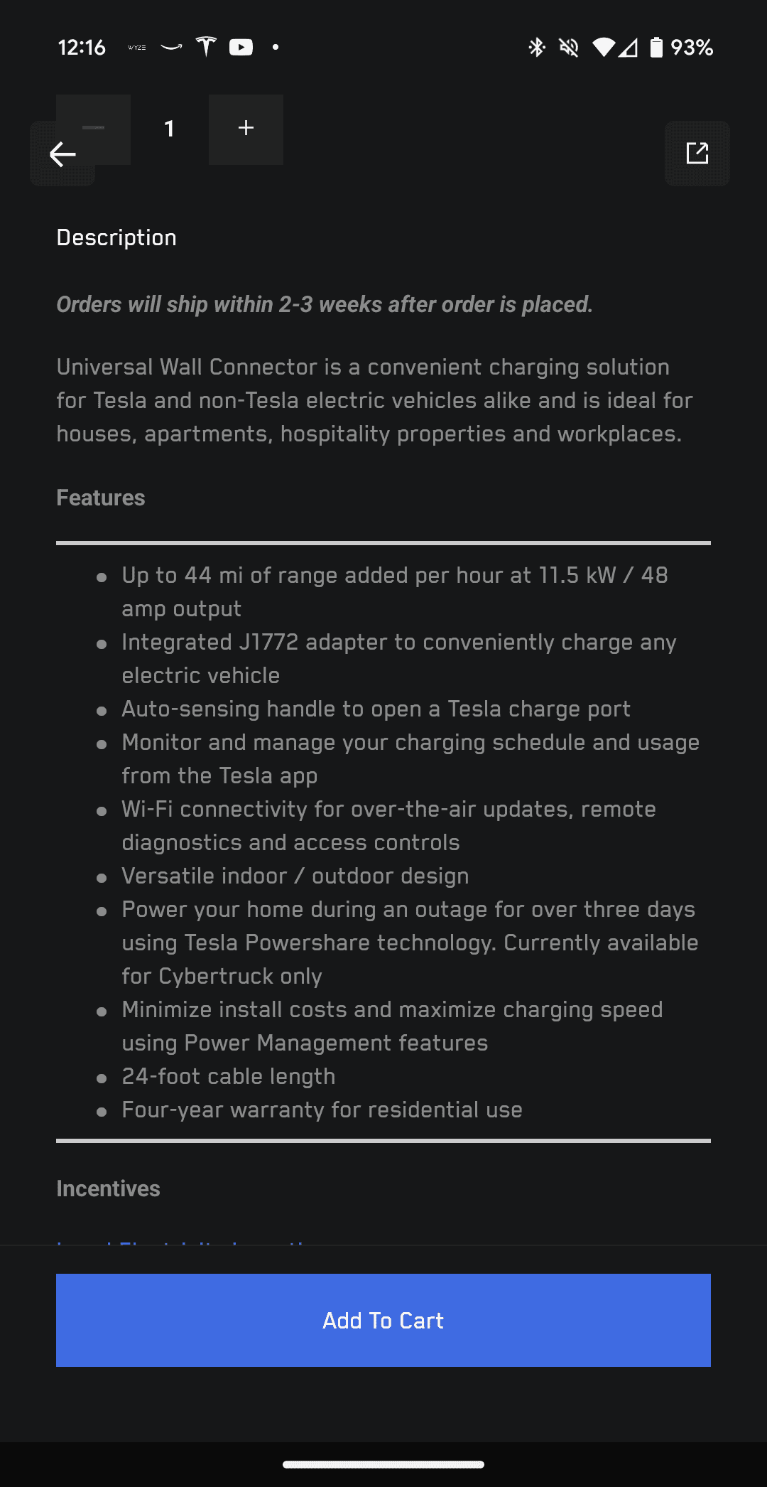

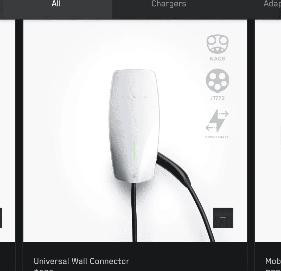

I hope this is no different than the universal wall connector Tesla brought out a month or so ago because I got one and don't feel like getting another one. Not that I need power sharing to the house (I have a whole home generator) but I don't like to waste money and I like to be prepared. The power sharing capability would be just one more way to be prepared just in case.

Anyone know if we can use our referral credits on this? But definitely getting one to replace the Wall connector I have now. Question is, do we need to do anything on the homeowners end to accept the power share? Like you need to do something for generators?
That really depends on your house setup more than anything else.
There are a couple of options to make the power sharing/V2H work, details are not really well known, but technically the universal charger could handle most of the switching internally, but it would also have to control a grid islanding switch to disconnect the house from the power network to avoid feeding back into the grid, and risking electrocuting a lineman.
There's no reason that they would need a powerwall as a part of the setup, but they might want you to buy one anyway... from how I read the options on the power share page, I think the Powerwall is optional, the charger not so much, if you want automatic charge/discharge switching.
The CT can also be connected to the house without the Universal charger as well, by using the 240V outlet in the bed. The requirement here is the same, in that you would have to connect it to the house via a generator input switch, that would in turn off the grid supply as well for safety.
The difference there is that it won't be able to automatically switch between charging and discharging, and will have a little bit less power output 9,5kW rather than 11kW through the charge connector plug.
Either way I'm glad that CT finally added the V2X functionality, but I don't think they really had a choice given that they included a high power 120/240V inverter to power tools etc anyway. It's just a different way to connect that same hardware using the charge connector.
I hope it is the same for you! I was not about to get one until I knew for sure.

Where is the option for a SS colored front cover? :devilish:

How does this connector hook into the house? As in, doesn’t there need to be extra installation (transfer switch type stuff) to send and power a house? I have the latest connector (non universal) hooked into the panel. That doesn’t work obviously for bidirectional.. how does this new one set up? Any smart electricians out there?

I guess even if the charger is bidirectional, there must be a gate at electrical panel that disconnects the grid when CT is powering a house. Otherwise it would power entire grid and discharge fast.
