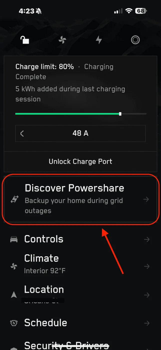

I just got my PowerShare system installed yesterday. Took about 8 hours but there was some wiring that needed to be rerouted between the panel and sub-panel so that added extra time. $3,600 total cost. Everything works great but I still don’t have the Powershare button on the charging screen of the truck. I have the latest 2024.14.7 V12 software so I’m not sure when that button is going to show up so I can actually try the system out. Anyone have the PowerShare button available that can share what software version they are on? I’ve seen it on a couple YouTube vids.
I got my truck at the end of April and was finally able to schedule the appointment. There was a crew that came out to take pics/measurements a week ago before the actual install appointment.
I had my PowerShare gateway and UWC installed last week and I had the same situation where PowerShare wasn't showing up in my Tesla app or the Charging section of my CT UI, and I have the same software version as you. I called Tesla and spoke to support, this seems to be happening to a lot of people. It took about a day with a few back and forth calls/emails, and one screen reset using the two scroll wheels on the squircle to get it to show up. I have no idea if the reset did it or something they were able to do on the back-end, but it's all working now.

Thank you for the reply! I’ll try the screen reset first then give Tesla a call.
I think it takes a day or two after the installation before Tesla enables it on the backend. I don't think you need to reach out. It will appear...
