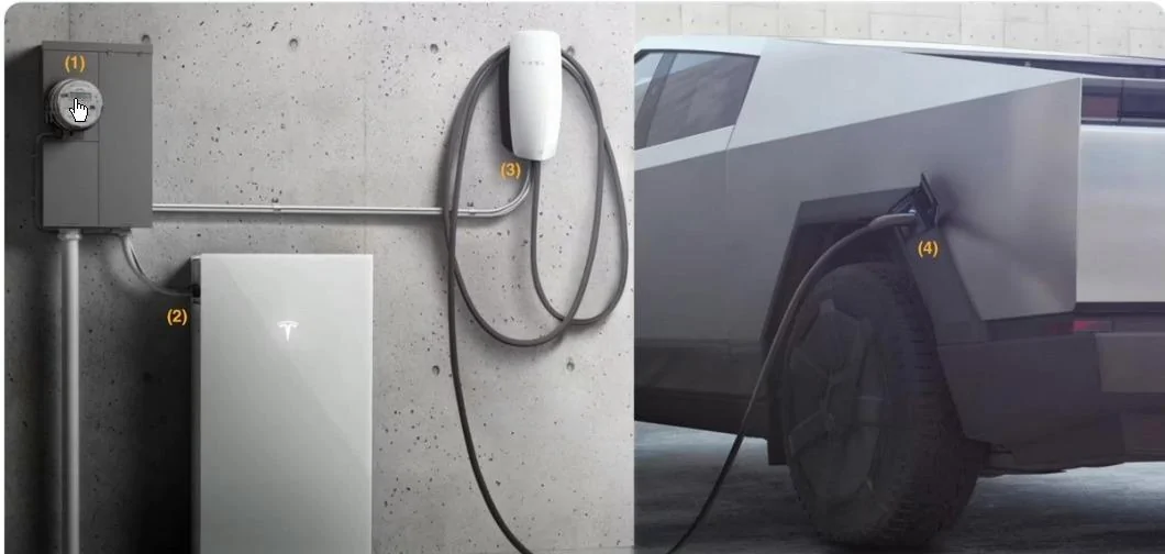

Good summary I saw here:
This picture really summarizes YEARS of work in the making by @teslaenergy @TeslaCharging @Tesla. Again, lets look
at it from a holistic point of view as investors, owners and installers of the Tesla ecosystem
(1) BACKUP SWITCH
---> "The best part is no part"
This is perhaps for me, as a Tesla installer, the most amazing innovation. Why? 4x faster installation, no need to add Gateway [if paired with PW+/PW3], no need to upgrade existing electrical panel.
(2) POWERWALLS
Tesla has gone from PW2 --> PW+ --> PW3. These babies are more than batteries, they're complete systems including: battery-based/string inverter, thermal management system, cells themselves, power electronics, etc. This 'close-loops' the Tesla ecosystem
(3) WALL CONNECTOR/NACS
Simple but powerful. Now with 'PowerShare', people can use their vehicle to power their homes during an outage. Even perhaps use their vehicle to add more capacity (in kW and kWh) on a daily basis, participate in VPP programs ...
(4) POWERSHARE/@Cybertruck
Closing the ecosystem with a V2G/V2H component (aka Cybertruck), 48V vehicle arquitecture is MASSIVE. This unlocks the full potential of Tesla's mission to transition the world to a sustainable future through a 'distributed' energy approach
This is a clear example on how amazing Backup switch (BUS) is. Assuming you had a Ford version of the backup switch, you won't be needing: (3), (5), (2)

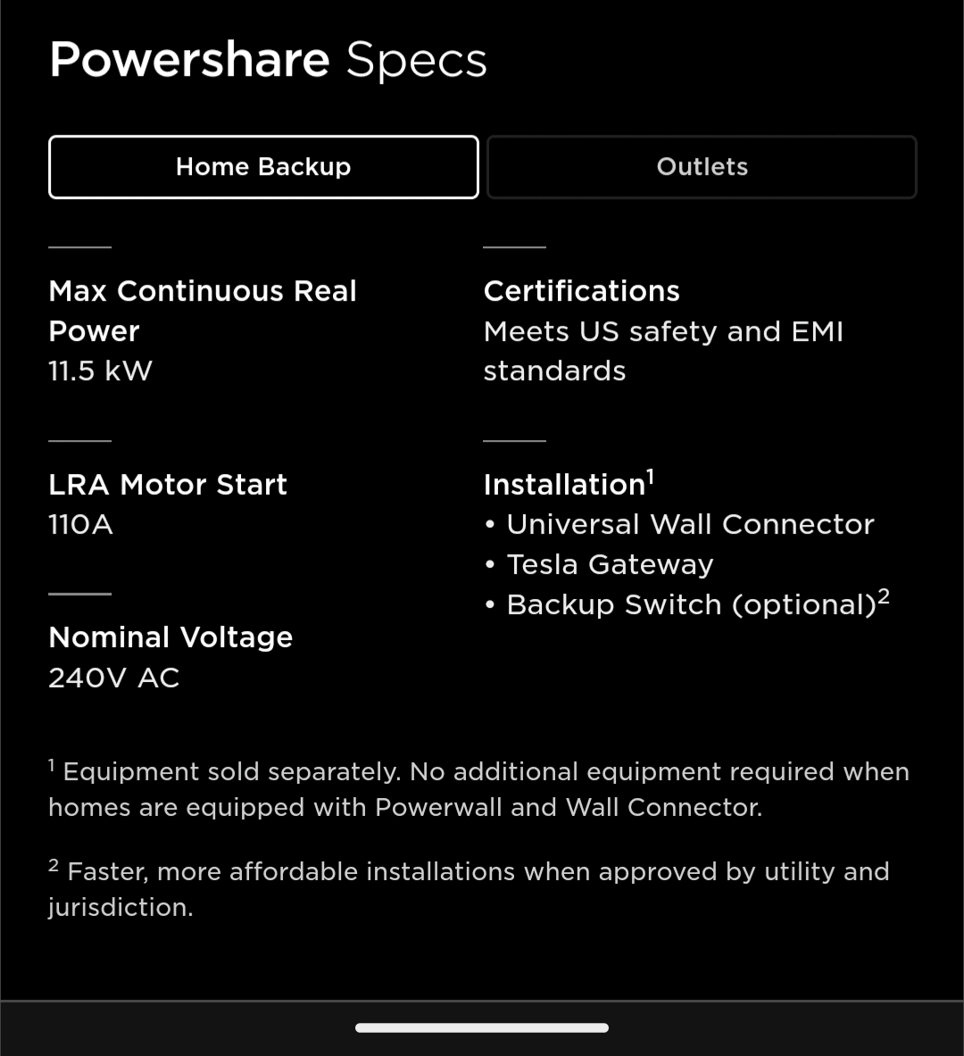

Does Tesla produce a switch that would isolate the house from grid in event of failure without having to buy the full powerwall. I LOVE the fact that we could use the truck to back up the house vs. a gas generator. 11kw should power a fair bit of stuff at peak including one of our air conditioners.
Backup switch might be that?
Tesla Cybertruck Powershare compatible wall charger - Tesla Universal Wall Connector in online shop Screenshot_20231203-164335
That is quite a few amps:
48 amps = 11520 watts / 240 volts​
96 amps = 11520 watts / 120 volts​
