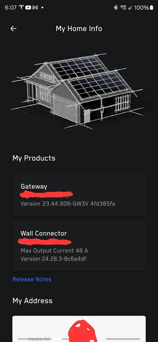

Just got mine installed yesterday and we were confused as well, since like others mentioned, their instructions said to test failover before leaving, but the option didn't show up.
Out of curiosity, for those that had the delay before it was active, did you see a version for your gateway? Mine currently just shows "--". This is in Home/Energy page -> Settings -> My Home Info
I can't even find that menu. Maybe it will show up when the option is available.

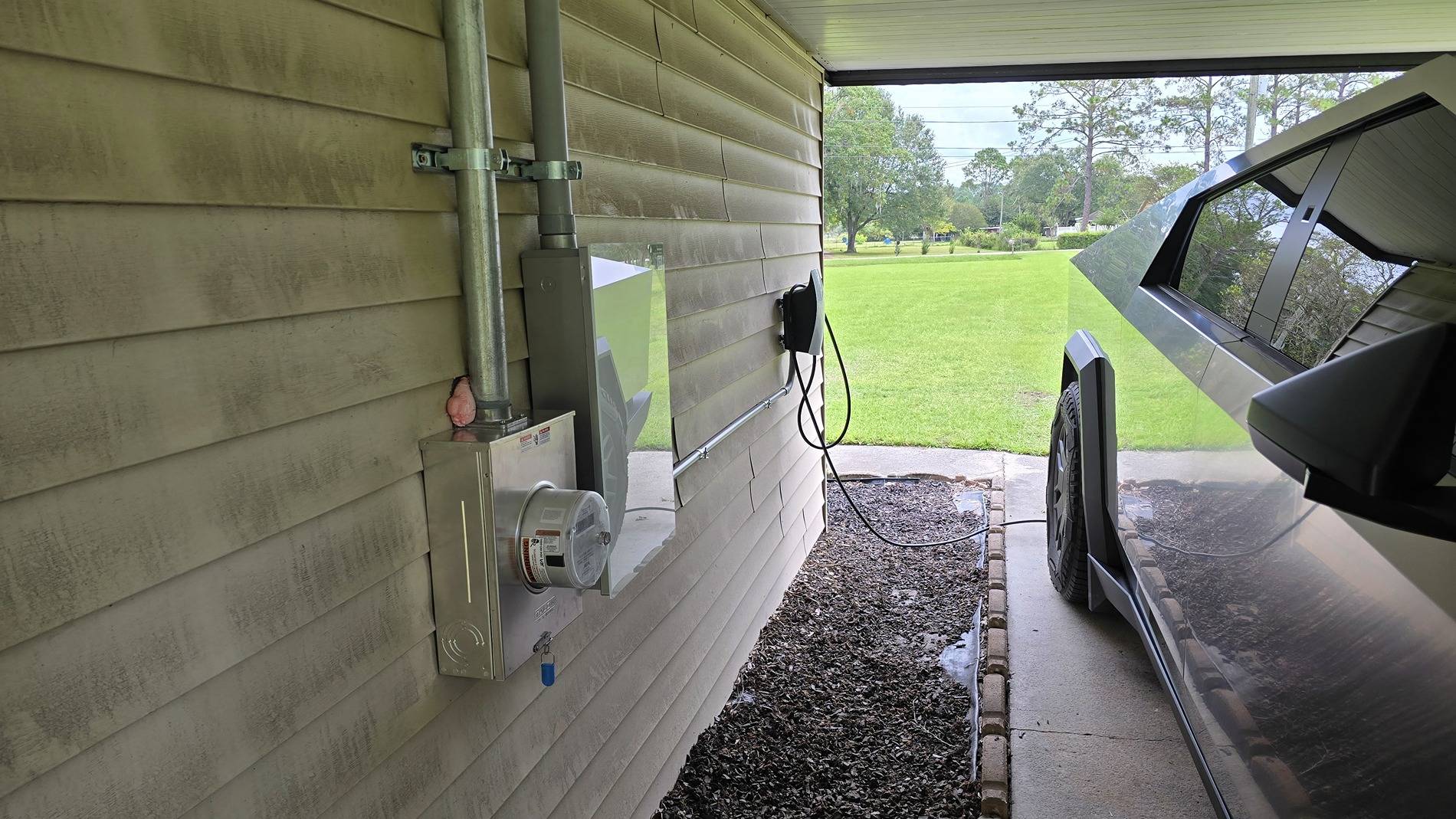

Mine was installed and commissioned on 9/24/24 and I still don't have the Powershare option in my Console\Charger screen. Installer said he has seen it takes weeks or just hours for Tesla to assign your CT VIN to the Powershare GW. I'm trying to get it working before Hurricane Helene comes through incase I lose power.

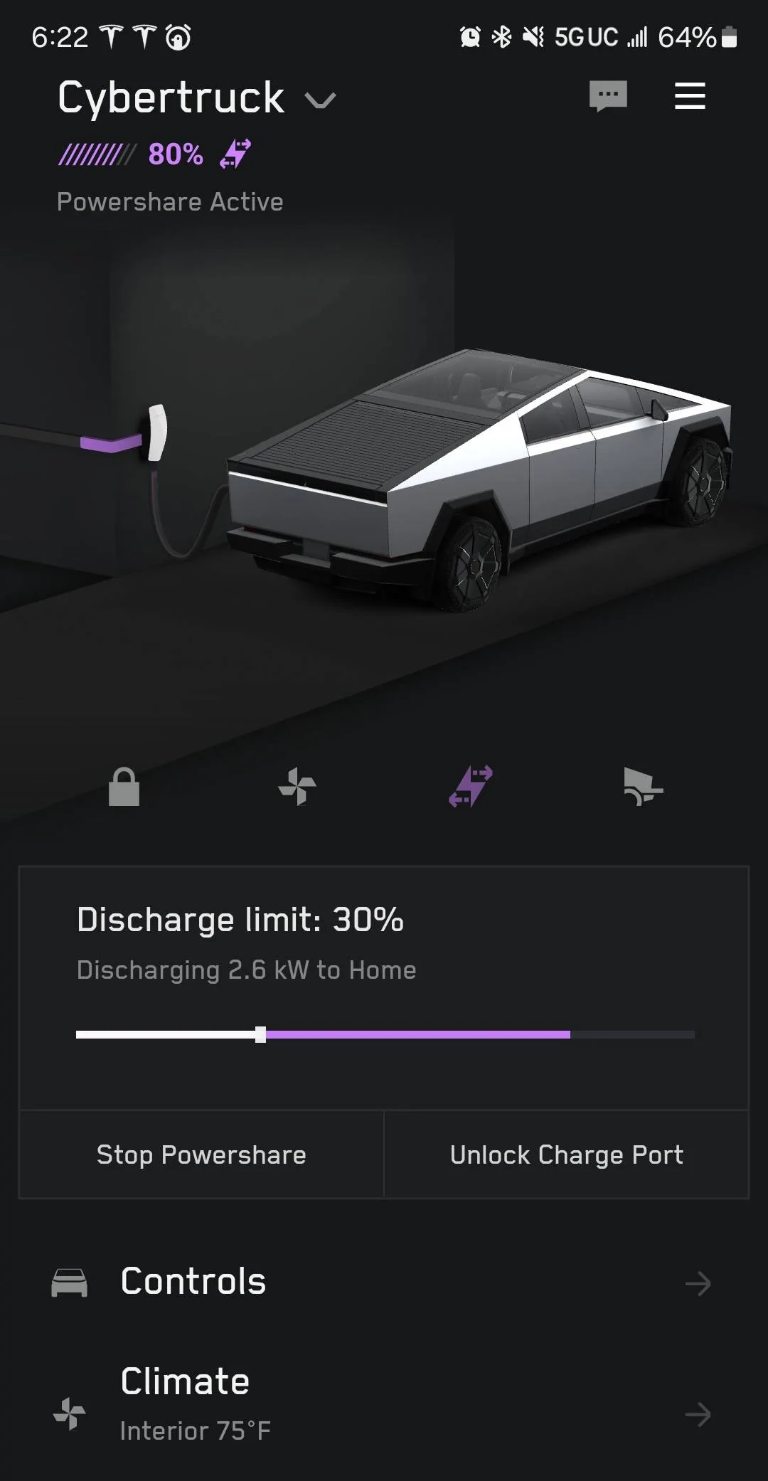

Exact same thing just happened to me. 2024.32.5.4 just installed. A few mins later, Discover Powershare option showed up on mobile app. I am away from my truck so I took that opportunity to enable on the app. Once I did, I don't even see the option on the app anymore. Wondering if it just shows up once on the app then only accessible on the CT after that.

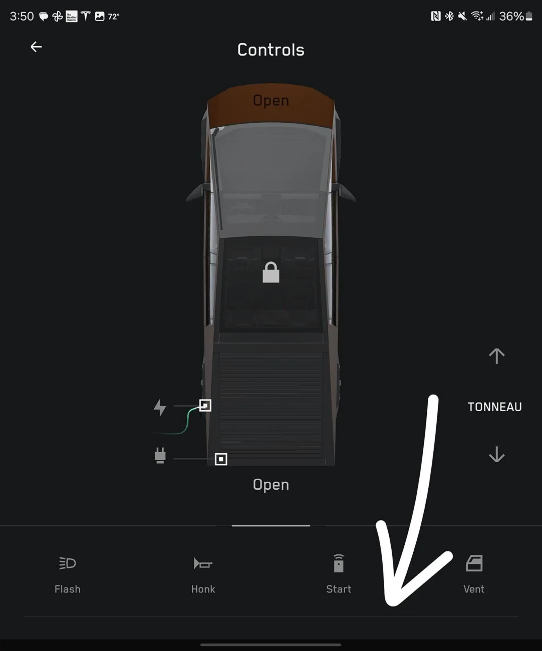

It shows up in the app in the Controls screen at the bottom.

Ok I feel really stupid but I never realized there were more options after the row of icons at the bottom of the controls screen. When I have tried to scroll, I never touched that low on the screen which is the only way to get it to scroll.
please tell me Im not the only one.

Not the only one :p I did the powershare tutorial... so I knew the settings were somewhere in the app since the tutorial drops you at them. But had no idea I could swipe up on that screen until today
Tested it out, and all worked great! Since the truck was awake, the switchover was less than a second. Then when I flipped the power back on, it waits for 5min to flip back to the grid (which is another <1s outage as it changes back over - makes sense, just hadn't thought about what happens when the power comes back)

Could anyone let me know what they see under their home, settings then WiFi?
Mine shows up as Powerwall and wall connector. Tesla is saying that the installer set it up as a powerwall and not Gateway.
I have the option to enable PowerShare in the truck but nothing happens (says communicating in the truck settings and chargers flashed blue) when I shut the outside disconnect. Under my home info I do see a gateway with no version.
What does everyone else have?
