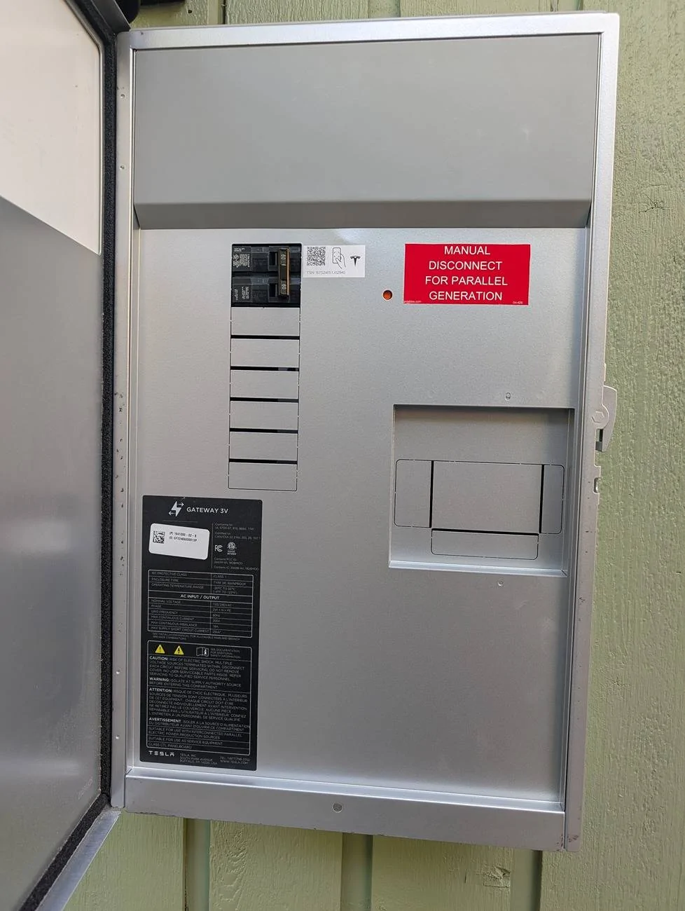

Well this was finally resolved last Friday with the electrician on site, a Tesla Senior Product Engineer and the Smart Charge America Project Manager on the phone.
We went through the details of the install once again. The install was correct.

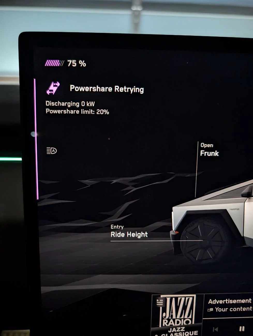

The tesla engineer mentioned that the amp measurement and the amp overload error codes are created by the truck. Ha!
I had measured the amps on the house side and used an o-scope to chase transient spikes. Nothing there.
We then conducted a test where I measured the amps on the connection between the gateway and the wall charger. Viola! a 106 A spike. On the house line steady 6 A.
The Gateway was shorting out the truck when going off grid! Now it was crystal clear that the gateway had a fault which we suspected day one. It was swapped and has been working ever since. This now also explains why we had a strong humming noise during the fail-over that was mentioned to Tesla since the beginning.

So I think this shows the neutral forming transformer in the Gateway is only in circuit when the isolation switch is in island mode.
