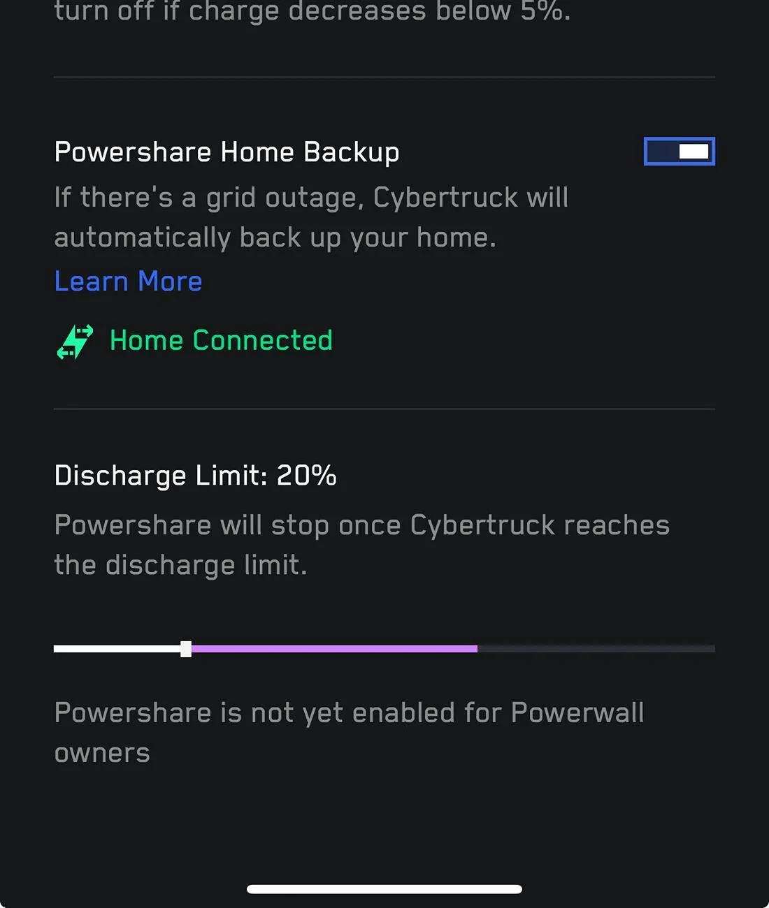

Guess that means mine is approved since I have the magic purple button then?
Can’t test it yet either because no powerwall support right?
I have the one in the app but the one in the trucks menu was the one that appeared after the config was approved.

I have it on my truck screen menu and it’s tuned on

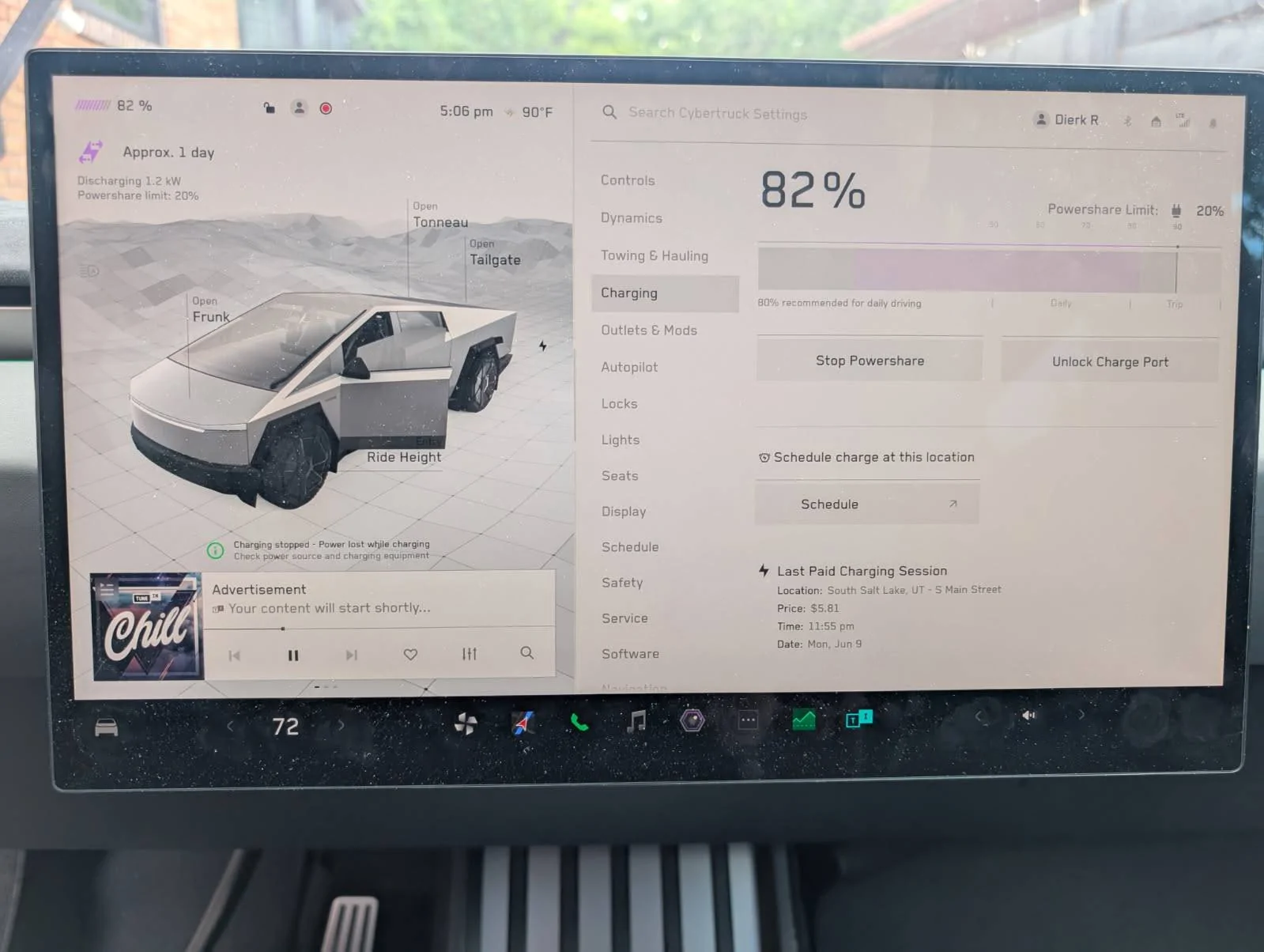

Here you go. Straight forward. There is a sales person in Plesant Grove who owns a cybertruck and has working powershare. However as an employee of Tesla he can not help figure out if this is a problem with the truck or the house. The service center doesn't have a full test harness to determine with certainty that the truck is working.
So again if anyone in a 10 hour driving radius of Park City owns a cybertruck with working powershare I would love to stop by and determine if our truck can power your house.

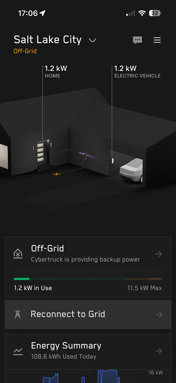

After that I flipped it on, then manually ran my test by flipping my Main panel shutting off the grid.
Truck gets woke up by the gateway, they have a chat then power restored within about a minute or so to the house

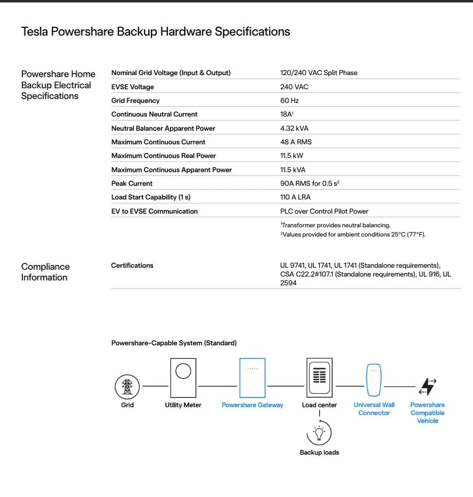

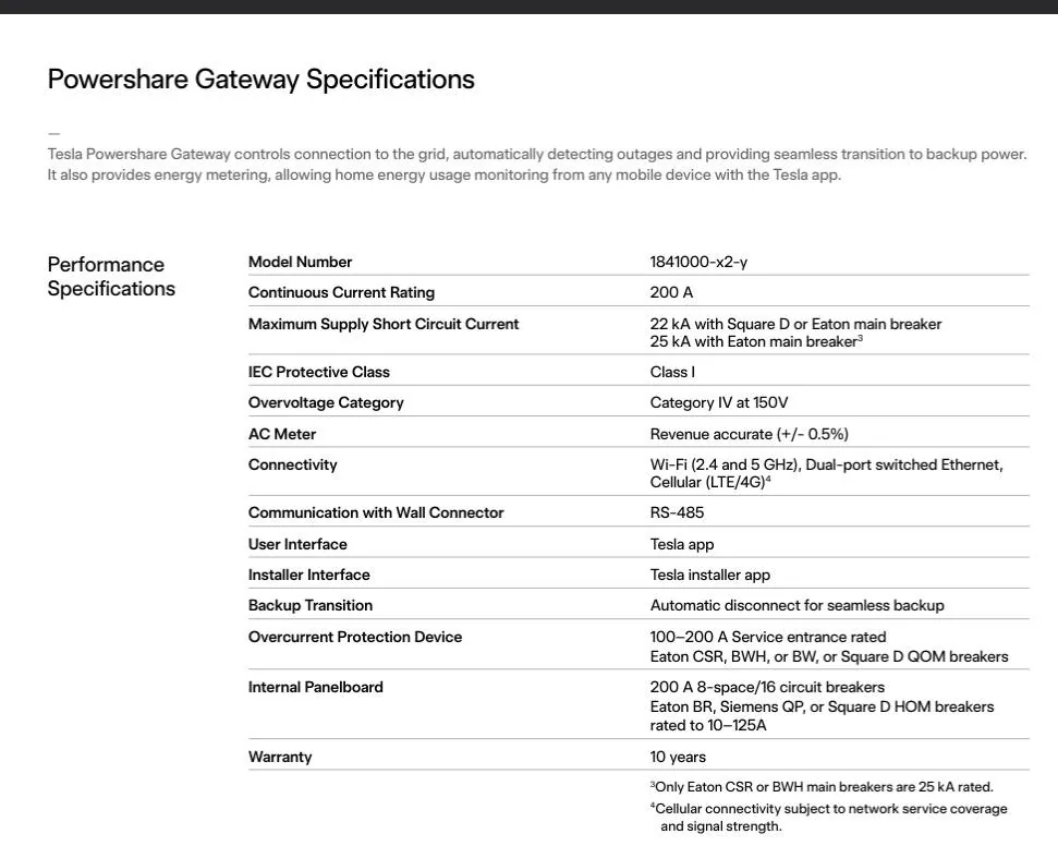

Gateway talks RS485 to UWC, UWC talks PLC to truck.
Gateway can't detect anything when grid goes down due to being unpowered. In Powerwall setups with GW3, the TACO/ site controller is part of the Powerwall and it runs the isolation switch via RS485+power cable. In Powershare, the TACO is part of the Gateway and the truck powers the UWC which powers the Gateway.
https://energylibrary.tesla.com/doc...kup/en-us/Powershare-Datasheet-HomeBackup.pdf
