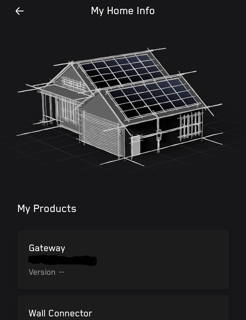

Could anyone let me know what they see under their home, settings then WiFi?
Mine shows up as Powerwall and wall connector. Tesla is saying that the installer set it up as a powerwall and not Gateway.
I have the option to enable PowerShare in the truck but nothing happens (says communicating in the truck settings and chargers flashed blue) when I shut the outside disconnect. Under my home info I do see a gateway with no version.

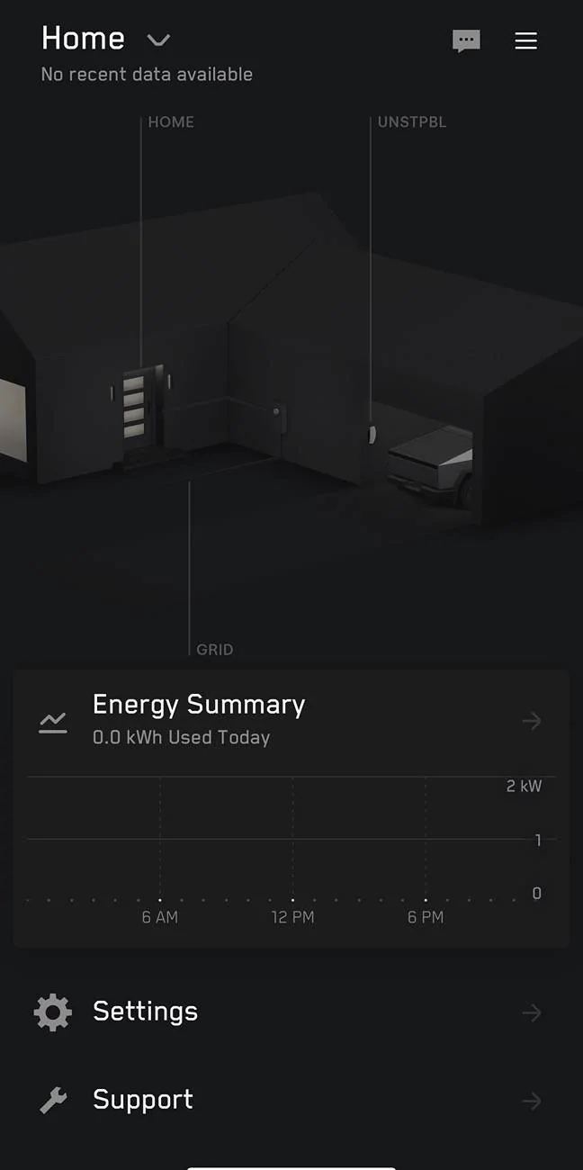

You've got me wondering too. I have not had a successful test yet but here is what mine looks like. The network under both settings is my home network.
Tesla Cybertruck Powershare Complete: But missing option in CT Screenshot_20241001_080530_Tesla

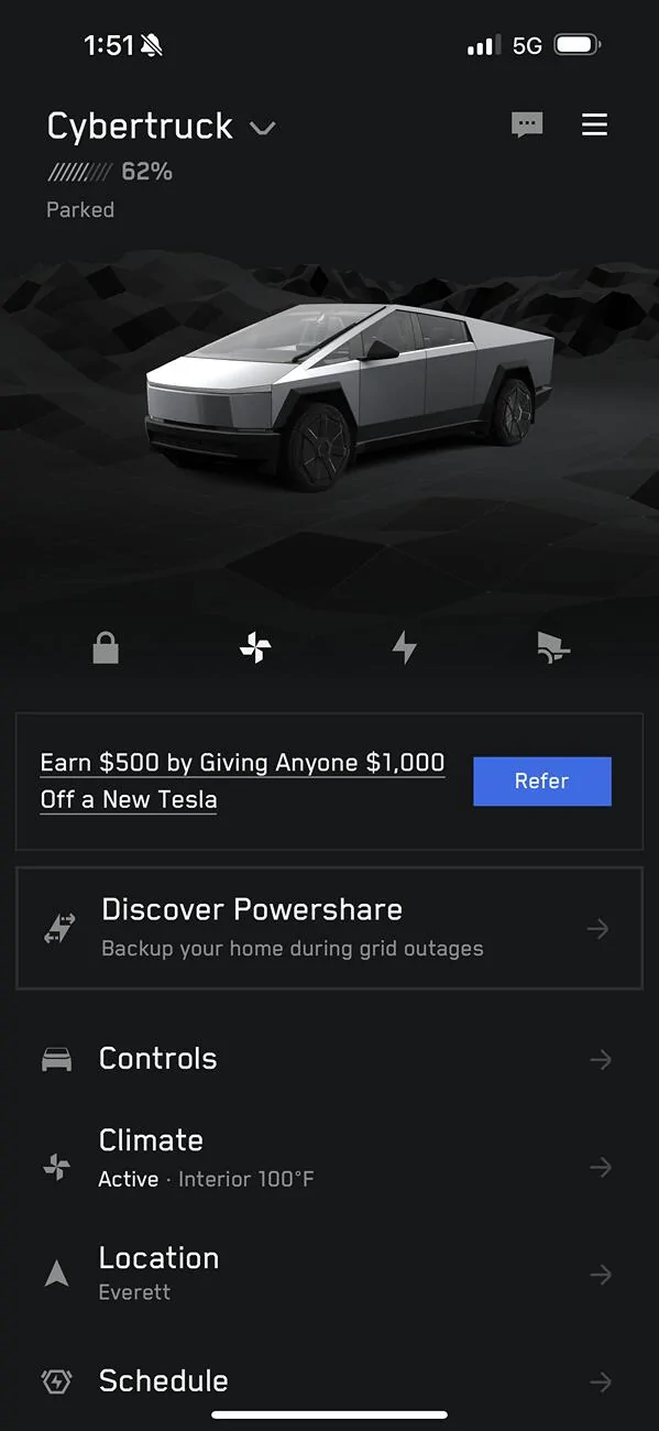

Do you have a screen shot of how it appears on the app after the update?
Discover PowerShare will be visible on the CyberTruck section of the app…

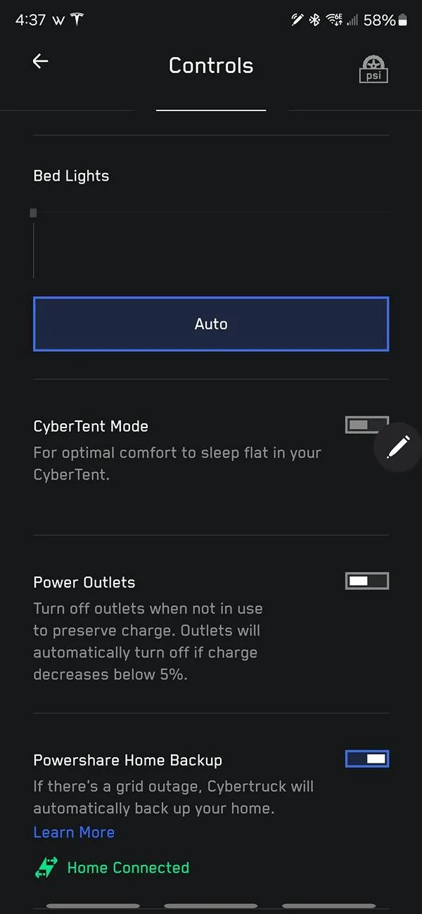

Here are my WiFi settings for my Powershare. After the installer successfully commissioned the PS GW we had to connect the Wall Connector to my WiFi router. It was having issues connecting (we tried 10 times) because the Wall Connector only supports WPA2 secured 2.4 GHz, 802.11 infrastructure mode networks.
I had to enable a separate WPA2 2.4 GHz only 802.11 IoT Network in my Wireless settings so it would connect. After I did that the WC was able to connect.
But now I notice that the Wall Connector does not list my network SID I created. I see that the WC is listed in my connected devices in my router and I can ping the IP address.
I have not tried a manual lost of grid power test so I'm not sure it works yet.
I do see the Powershare option in my CT Console>Charging screen and in my app Controls screen.

The issue with mine is that Tesla is saying that they cannot see the gateway and the WiFi settings as powerwall is the issue. I would assume that if the gateway is connected Tesla should be able to ping it.
Also I see no power flow in the app and the house is grayed out, meaning the system is not communicating.
I am not sure if this is to new and Tesla support is still figuring things out or if this an installer issue.

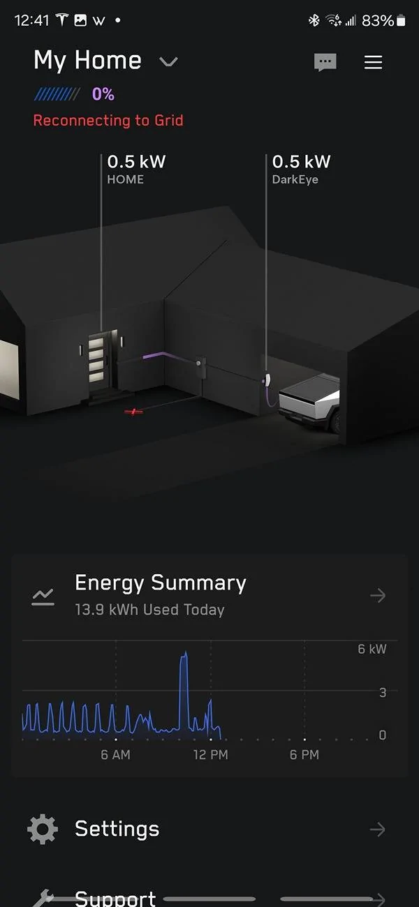

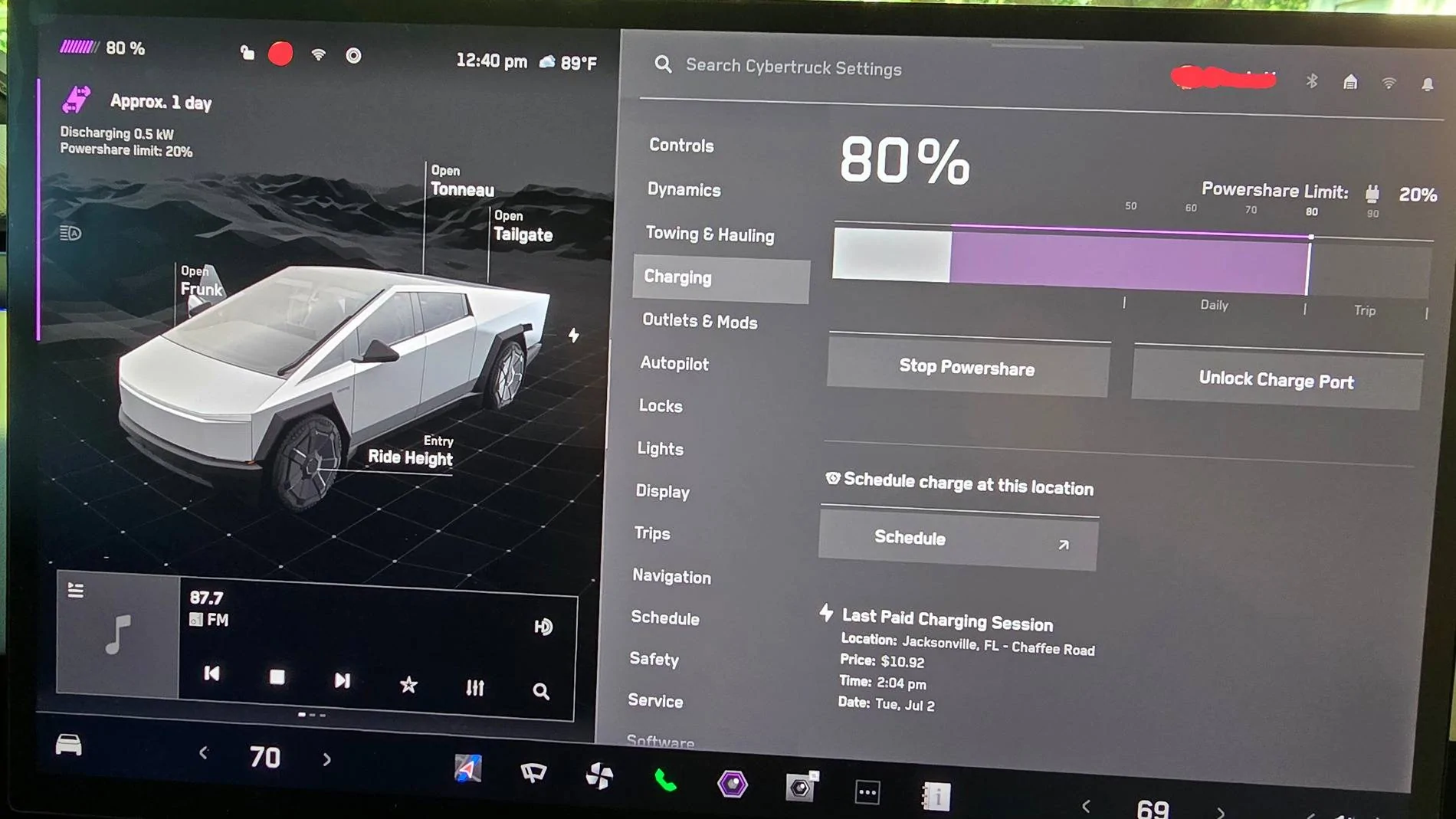

The Wall Connector only supports WPA2 secured 2.4 GHz, 802.11 infrastructure mode networks and not 5 GHz. I can ping my WC from my home network so I know it is connected to my home network.
I just did a Powershare test (by turning off the main breaker in the PS box) and my CT started supplying power to my home after a few seconds. It took 5 minutes to start supply grid power after I turned the main breaker on in the PS box.
