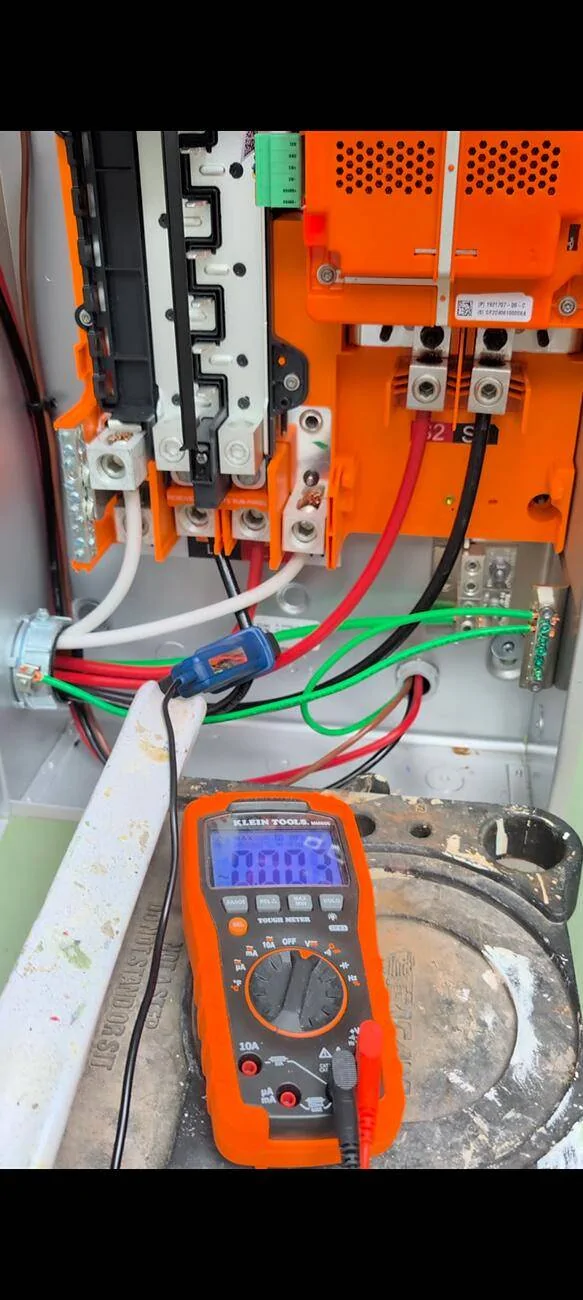

Well, no response from Tesla or Electryfy America. The consensus is that the house is overloading powershare. So this morning I measured the load on the phases leading to the house.
There is a total of 7A going through the two phases. So 7 * 120 -> 0.8 kW house load which matches the Tesla App. The amps were measured during the powershare cycles with the meter on max mode. NO changes. No sign of an amp spike. The "3" on the meter translates into 3A on the black phase.
However, they already ignored the tests that were done with electrify remotely with a house load of zero.

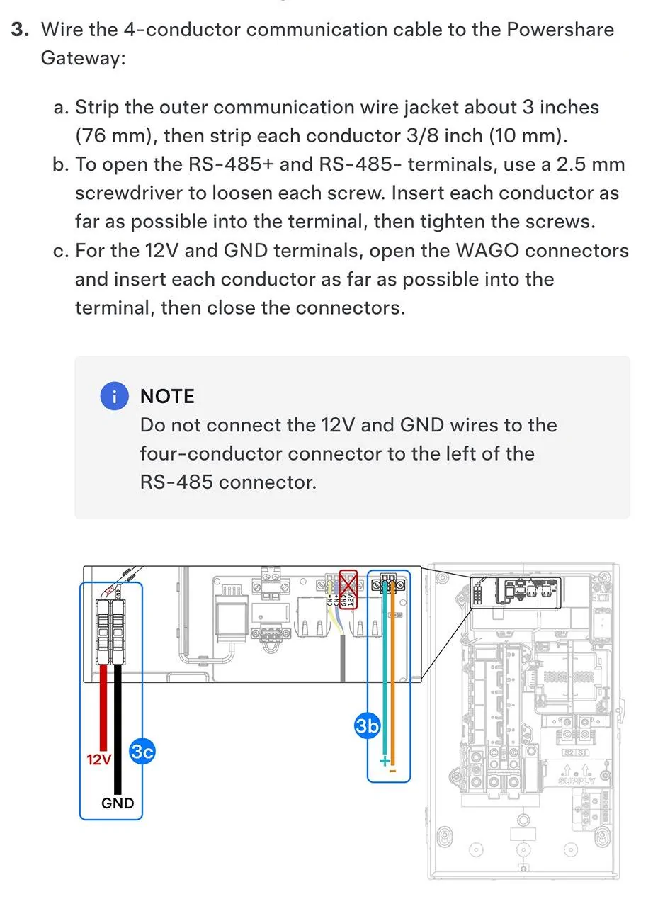

The extra cable from UWC to Gateway is both power for GW and communication. Needed because nothing is powered to begin with other than the truck which is likely either asleep or disconnected .

Way, UWC powers Gateway via the 12V lines on the 4 wire communication cable, not AC.

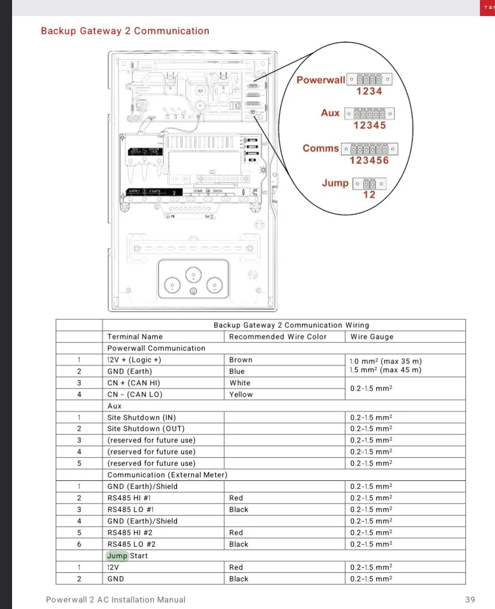

Powerwall systems have a dumb gateway (no TACO) and directly communicate with and power the isolation switch.

The Gen 2 Powerwall Gateways had 12V jump terminals to boot the system when the Powerwall was disabled due to SOC and there was no grid power (think long outage with solar, but battery drained overnight).
